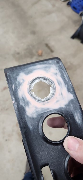

  2. Just an update for anyone following along. Ended up working with my local autoparts store to mix a custom spray can to match. Its pretty close, close enough no one else is going to notice it unless they are looking for it or know that the trailer brake control knob isn't supposed to be there. Photo below of the mix he came up with. It has a little bit more black than the factory, and could use even a bit more flattening agent than the bunch that was already in there.
  3. Its aftermarket, it says it the post, it is a Tekonsha Prodigy iD. You can see the knob in the photos, it is not the factory slider.
  4. Hi All, I have a 2017 Silverado 1500 LT, and I am looking for aerosol paint to match the dark metallic paint that is on a bunch of the interior trim pieces. In this case, specifically the panel with the headlights, dimmer and 4WD controls on it. My RPO code sticker says 4AA on it, which should be Jet black, but I cant find anyone selling paint referencing this 4AA number. I have found "Jet Black" interior color paint on this site, and maybe some others, but the numbers not matching concerns me. https://www.paintscratch.com/touch_up_paint/Chevrolet/2017-Chevrolet-Silverado-Jet-Black-Interior-WA600R.html Thank you for any help! In case you are interested what I am working on, my truck did not come with the factory trailer brake controller, and I need to add one. Decided to try my hand at modifying the trim panel using a 3D printer, some plastic bond, and glazing putty to fit a Tekonsha Prodigy iD in the factory location. It wont match perfectly, but I think it will be in a good location and wont stand out too much.
