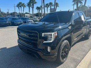

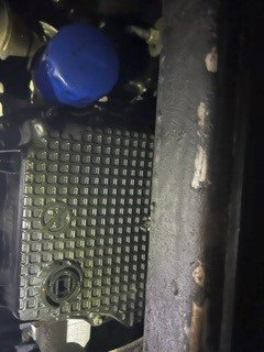

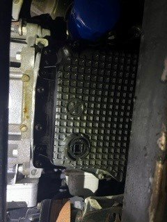

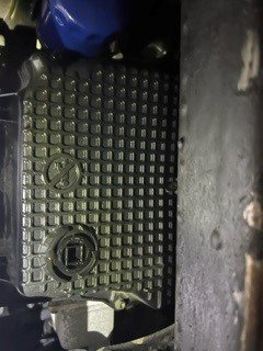

  5. I am just very frustrated. I feel like I am not getting the whole story. Zero chance in my mind that they have been waiting on alignment dowels for 4 months. I mean they are building new trucks every day and they cant grab a few dowels off the assembly line to get a current customers truck back to him??? I am having a very hard time buying that!!

  7. I am being told specifically that its the alignment pins. The cover and seal assembly has already been replaced.
