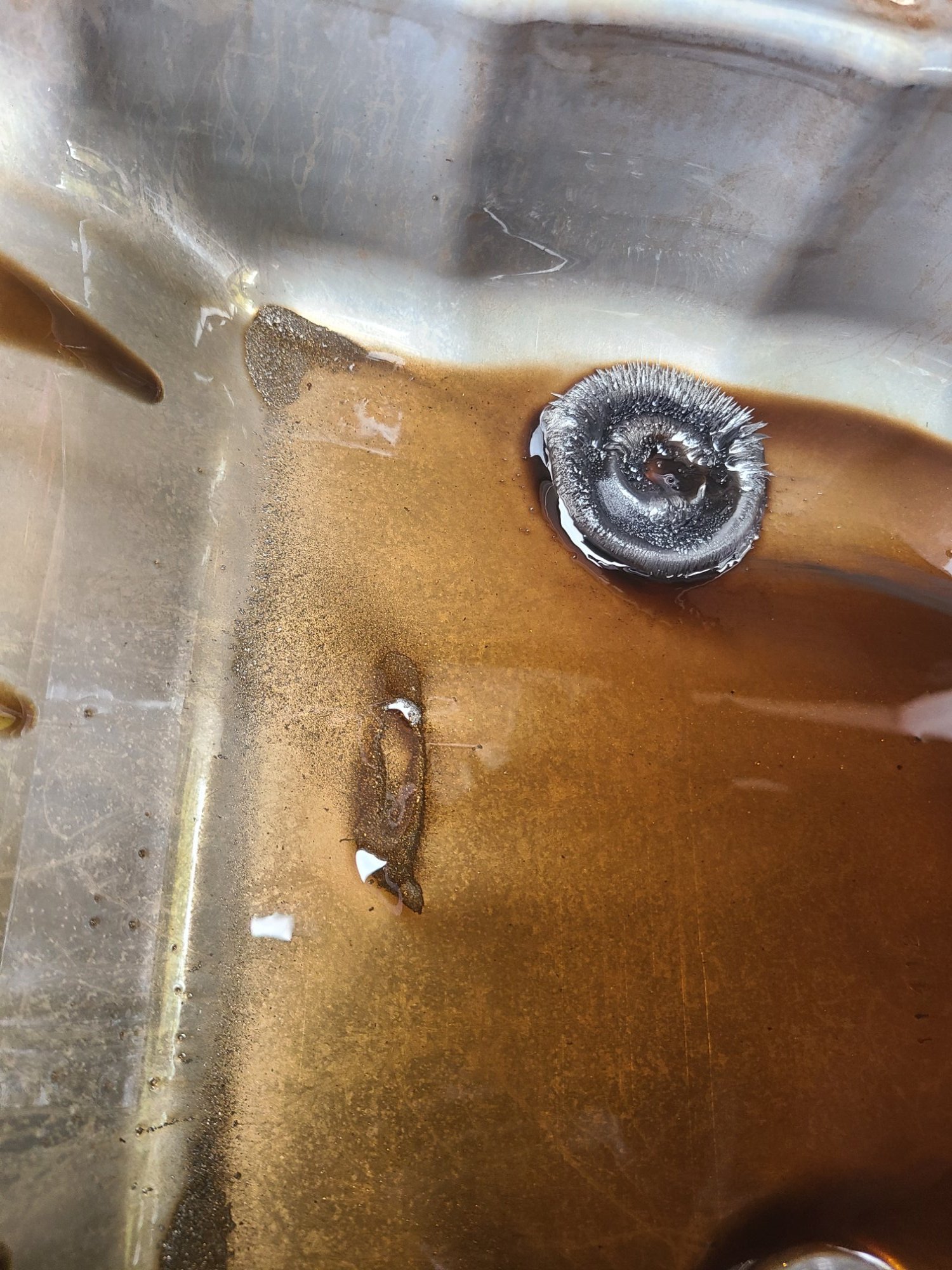

  1. Tc is installed and no more shudder. I will definitely be doing a complete flush and rebuild on the valve body just because of all the material in there. But at least the main problem is resolved
  2. I believe I have determined it is the torque converter. I heard putting it in tow mode doesn't let the torque lock up. So I tried it and bam, no more shudder. So I have a billet heavy duty TC on the way and will run it in tow until it gets here. After winter I will also rebuild the valve body just as reassurance. For now I will update you when the TC is installed. Thank you for all the help guys.
  3. I did a fluid and filter change and added some Dr shudder. It seems better but definitely not gone. I added some pictures of what I found in the pan.
