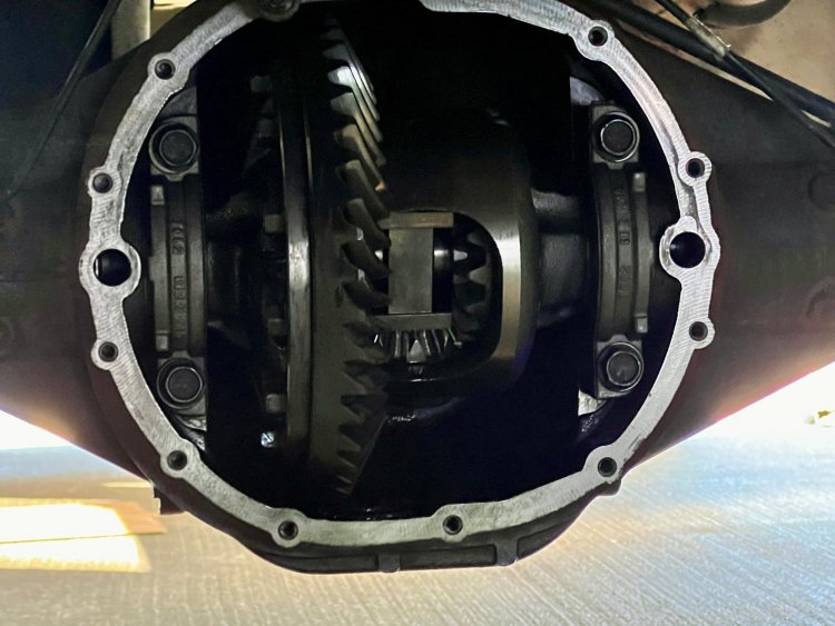

  1. Thought the same thing at first but came to the conclusion what is visible is most likely just the back side of the locker assy. I didn’t have the wheels off the ground when I had the cover off so I didn’t spin it.
  2. Thanks Rav, I don’t see anything like that on the build sheet GM sent me. I’ll paste what I have below. 1SZ - OPTION PACKAGE DISCOUNT 1WT - SILVERADO WT EQUIPMENT GROUP: 4D7 - INTERIOR TRIM 6GG - COMPONENT FRT LH COMPUTER 7GG - COMPONENT FRT RH COMPUTER 8X2 - COMPONENT RR LH NON- COMPUTER 9X2 - COMPONENT RR RH NON-COMPUTER A31 - POWER WINDOWS, DRIVER EXPRESS A91 - REMOTE LOCKING TAILGATE AE7 - SEATS - FRONT 40/20/40 BENCH AKO - GLASS, DEEP-TINTED AL0 - AIRBAG SENSING SYSTEM, PASSENGER AM7 - REAR SEAT FOLDING AQQ - REMOTE KEYLESS ENTRY AU3 - POWER DOOR LOCK SYSTEM AXK - VEHICLE TYPE TRUCK AY0 - AIRBAGS DRIVER AND FRONT PASS BG9 - VINYL FLOOR COVERING BWN - CORNERSTEP, REAR BUMPER C5Z - 7,200 LB GVW RATING C67 - AIR CONDITIONING DL8 - POWER HEATED OUTSIDE MIRRORS E63 - PICK UP BOX EF7 - COUNTRY CODE, U.S.A. FE9 - 50-STATE EMISSIONS FHO - VEHICLE FUEL GASOLINE E10 G80 - AUTO LOCKING REAR DIFFERENTIAL GAZ - SUMMIT WHITE GU6 - REAR AXLE 3.42 RATIO H2Q - DARK ASH / JET BLACK ACCENTS HQY - HEADLAMP COLOR BEZEL, CHROME I19 - ENGINEERING YEAR 2019 IOB - ITL - IDENTIFICATION - INF PASS GEN 2 JD9 - ANTILOCK BRAKES, 4 WHEEL DISC K34 - CRUISE CONTROL KC4 - ENGINE OIL COOLING SYSTEM KG4 - ALTERNATOR, 150 AMPS KI4 - POWER OUTLET, 110-VOLT AC KNP - TRANSMISSION OIL COOLER KRV - REFRIGERANT LOW GWP L83 - ENGINE, 5.3L V8 ECOTEC3 MAH - MARKETING AREA NORTH AMERICA MYC - TRANSMISSION, 6 SPD AUTOMATIC N33 - STEERING COLUMN, TILT NE8 - EVAPORATIVE SYSTEM LEVEL 3 EMISSIONS NK5 - STEERING WHEEL NQG - TRANSFER CASE, MANUAL NTB - EMISSION SYSTEM OST - OSHAWA PLANT PCM - WT CONVENIENCE PACKAGE: * GLASS, DEEP-TINTED * POWER OUTLET, 110-VOLT AC * REMOTE KEYLESS ENTRY, INCL. REMOTE LOCKING TAILGATE * POWER HEATED OUTSIDE MIRRORS PPA - EZ LIFT AND LOWER TAILGATE R4Z - TIRE BRAND-GENERAL-CONTINENTAL R9N - PROCESSING CODE RBZ - 17" ALL-SEASON BLACKWALL TIRES RD6 - WHEELS, 17" PAINTED STEEL RUF - WHEEL, 17" STEEL SPARE SAF - SPARE TIRE LOCK SLM - STOCK ORDERS T4F - HIGH INTENSITY DISCHARGE HEADLAMPS W/ LAMP CONTROL TDM - TEEN DRIVER U2J - DELETE XM RADIO U73 - ANTENNA - FIXED MAST UDC - DRIVER INFORMATION CENTER UE0 - ONSTAR DELETE UJM - TIRE PRESSURE MONITOR SYSTEM WITH TIRE FILL ALERT (EXCL SPARE TIRE) UMN - SPEEDOMETER, MILES & KILO, MILES FOR ODOMETER UQ3 - ENHANCED AUDIO SPEAKERS UVC - REAR VISION CAMERA V22 - CHROME GRILLE SURROUND V76 - RECOVERY HOOKS, FRONT V8D - VEHICLE STATEMENT VH6 - BUMPER, FRONT, BLACK VJG - BUMPER, REAR, BLACK VRK - VAA/COMPONENT REL ROOF TRIM VT7 - OWNERS MANUAL ENGLISH WMK - VIN MODEL YEAR 2019 X88 - MARKET BRAND CHEVROLET XL7 - FREQUENCY RATING 315 MH Z82 - TRAILERING EQUIPMENT PKG Z85 - SUSPENSION PACKAGE ZBZ - TIRE, SPARE 17" BLACKWALL ZY1 - SOLID PAINT
  3. What size diff is this? It has 12 bolts on the cover but I’m reading it’s not a 12 bolt? Sorry, this is my first Chevy.
