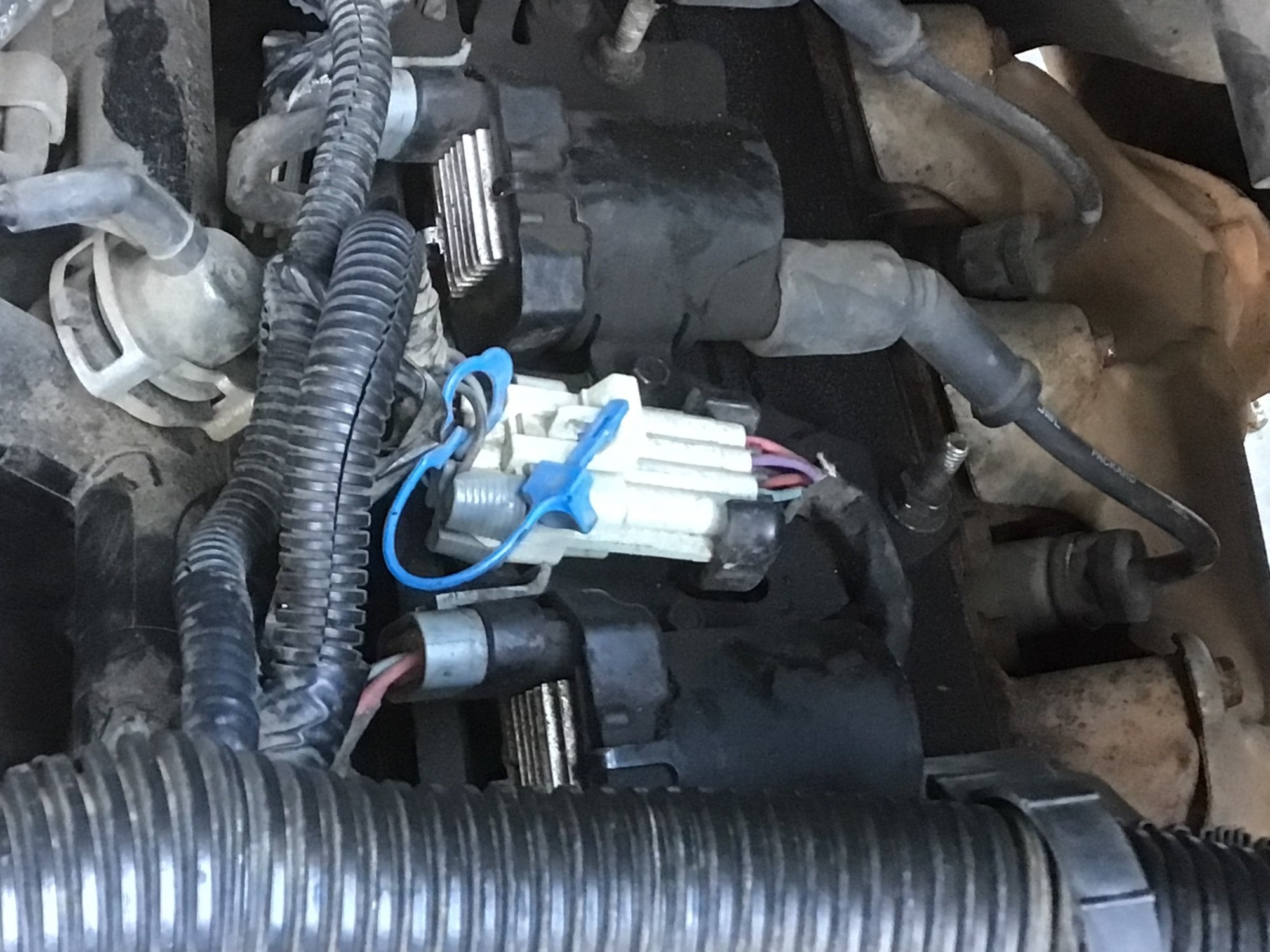

  1. Well as you can see from my latest photo I don’t have a black wire on the white plug at all! lol … for now I will try and find out which one of the wires there is my ground and do what you said.
  2. Okay I must be retarded or something. I guess I have just been at my truck fixing thing too long! This photo shows the white plug I was suppose to find the ground wire on the bottom row of wires add a longer ground to it and run it to the neg side of the battery right? Well for some reason I went to the coil pack to the left of that white plug, and see the plug on top of the coil pack? I added a ground wire to that ground and ran it to the battery? I am not sure what I was thinking but I don’t even have the right plug more or less the right ground wire. Did I just mess things up worse by doing the coil pack plug instead of the white plug? I am my own worst enemy!
  3. This is what the 4 coil packs and the plug look like. Drivers side.
  4. This the plug? I guess my ground is the pink one?!

  6. I am at my wits end with this 8 coil pack no start ******. My truck has been down for 8 months now. I changed Transmissions and at first there was no spark no start and finally realized with all of your guy’s help it was the crankshaft position sensor plug wires. Fixed that put a new Nuetral Safety switch in with new wires. Well in the process here I blew my pump in my tranny pulled the tranny for the fourth time and put in a new pump. I put in new plug wires, spark plugs are new a few months back, they look good, I have checked all the fuses and relay’s, all the grounds, checked for pinched, broken or bare wires, changed camshaft position sensor, checked battery cables, checked the ECM it’s good, brand new fuel pump, checked the security system, It had spark and started before the last pulling of the Tranny. I have not checked the ignition switch or anything in the cab other then the fuses, I can’t imagine it being all 8 coil packs they looked good. So I just can’t seem to figure out what I havemissed, (almost ready to call a mobile mechanic)…. Hopefully someone out there can give me something for my check list I have gotten on there yet. I have watched thousands of You Tube videos, checked, double , triple checked things I just don’t know….please somebody HELP! lol….
