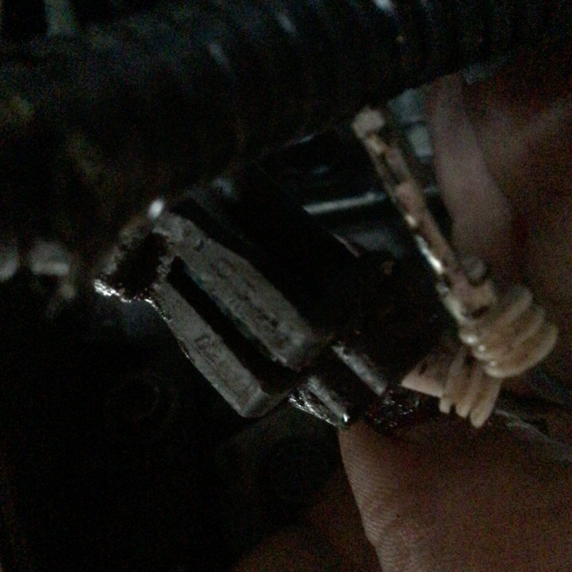

I have pulled the starter again and realized I pulled the power wire apart for the Crankshaft position plug! Put it back together with a better connection and put the starter back in carefully this time so I don’t pull apart anymore plugs!!! She started right up!!! Yeah!! But now I have put 5 of 11 quarts of ATF in and didn’t pre fill my Torque Converter it’s reading way over full and won’t go into gear. I was told to let it idle for awhile so the fluid could warm up & have time to fill the TQ.it is still idling and hasn’t gone down yet on the dipstick. What could it possibly be? The TQ is seated properly and it’s rare the pump goes, so what should I do? Help!!

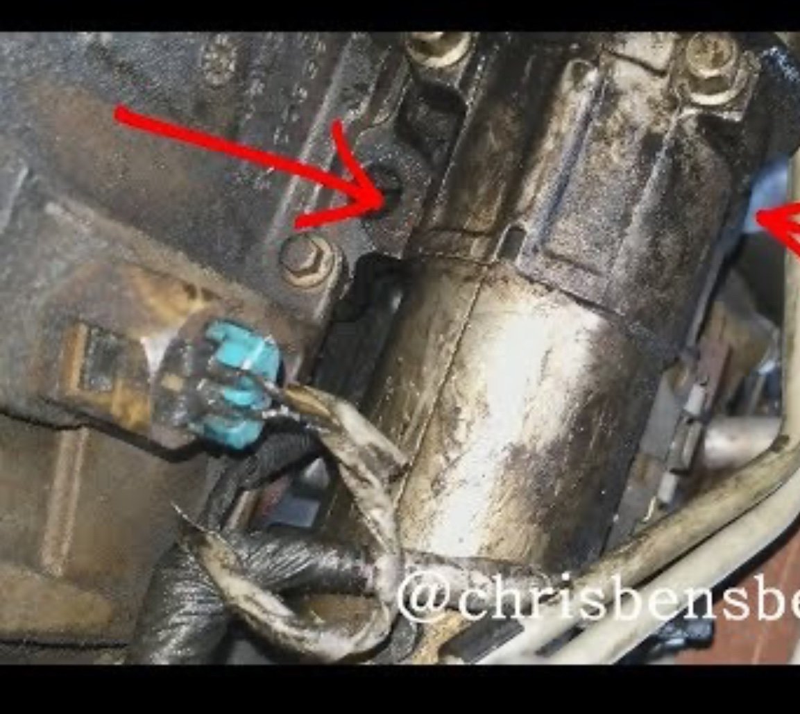

Thank you I will check out that site and check out the crank position sensor..thank you so much I appriciate all your guys help so much!!!! Thank you for the site it was perfect! I had the green wire totally disconnected from the Crank Pasition sensor plug! This certainly could’ve been the problem.I was wondering if you think that can be fixed or should I just get a new one? The way I had to shove the starter in and wiggle it out several times it’s so wonder that’s the only wiring problem there…lol Hopefully this will be the last part I have to buy this go around…Thank you sooo much again!!!
