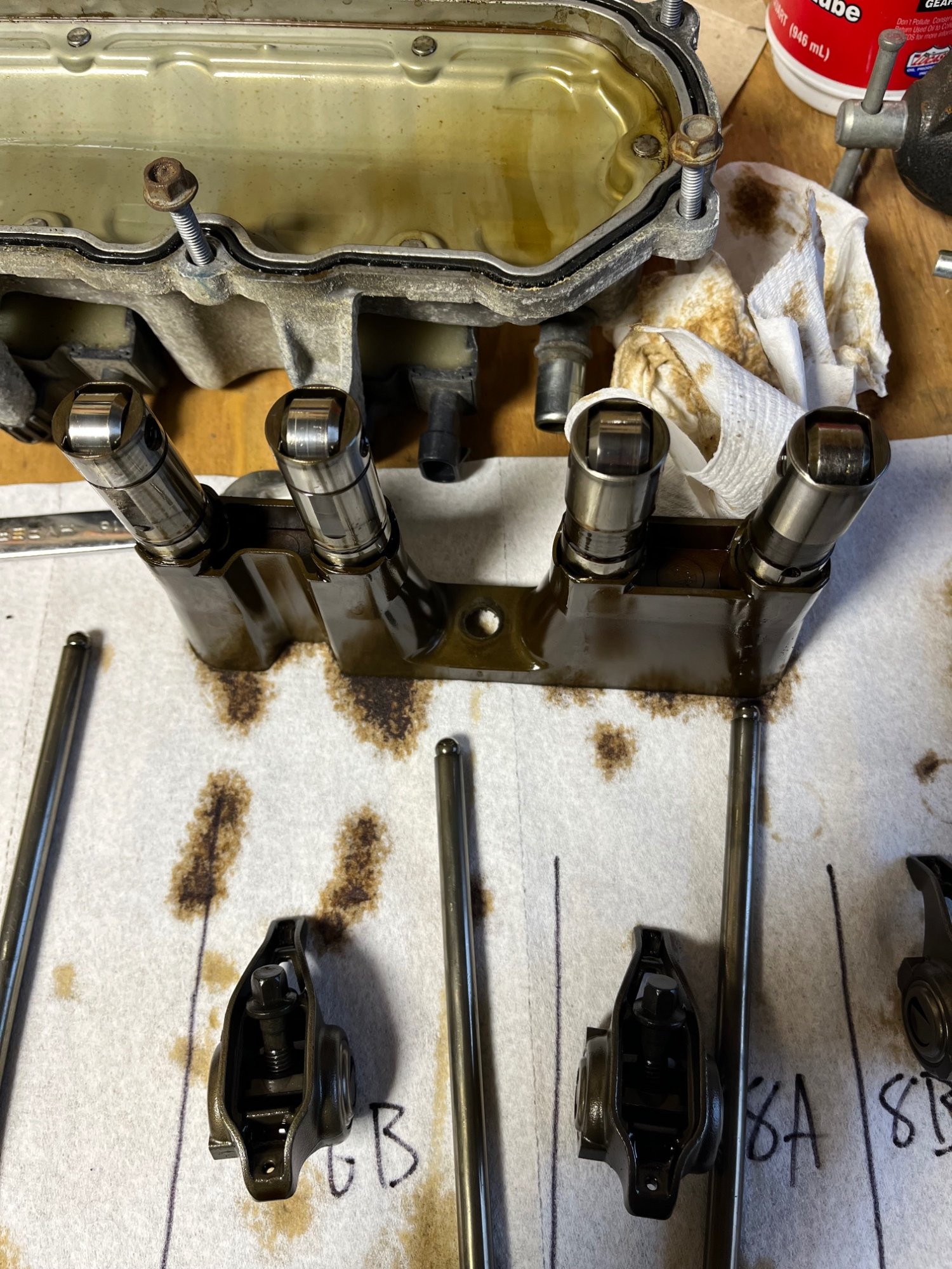

  1. If I had to guess I’m thinking cam lobe got worn down caused the pitting on lifter and wasn’t “lifting” it enough for the exhaust valve to work properly hence all the blackness on valve and exhaust port for cylinder 8 which was giving me the misfire. But again that’s only a guess until I get the camera in there

  3. Not sure yet buying an inspection camera in a few days to look down the hole. Its cylinder 8 so too far in back to see by eye. Hoping cams fine. If so ill replace lifter and tray as well as clean up or replace the valves

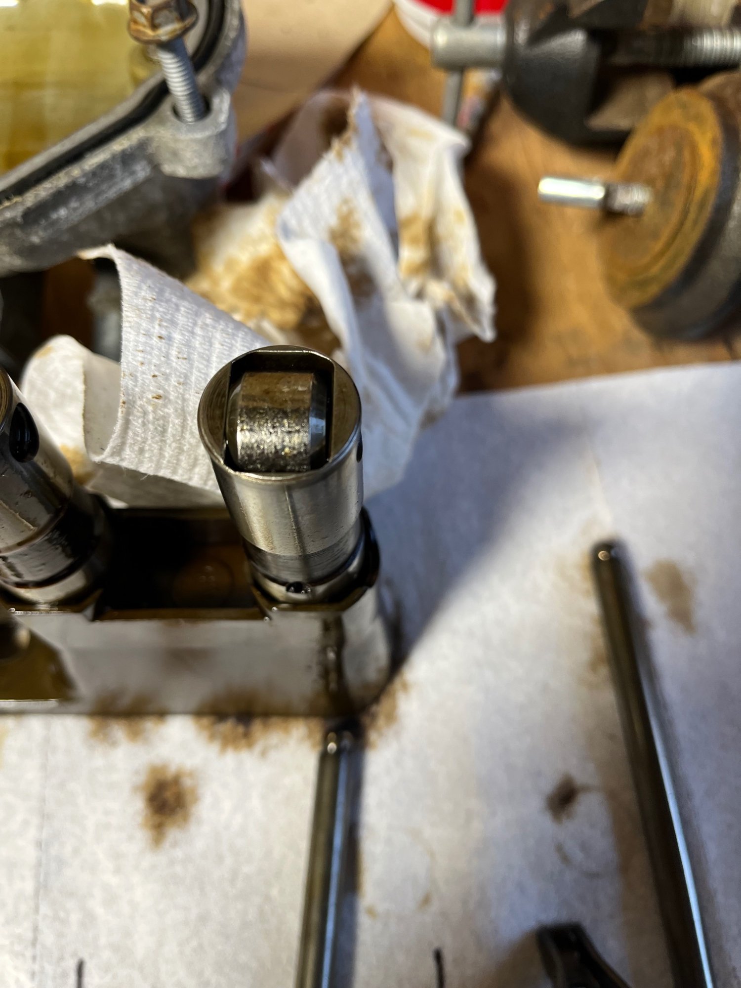

  4. And finally a close up of the lifter from cylinder 8

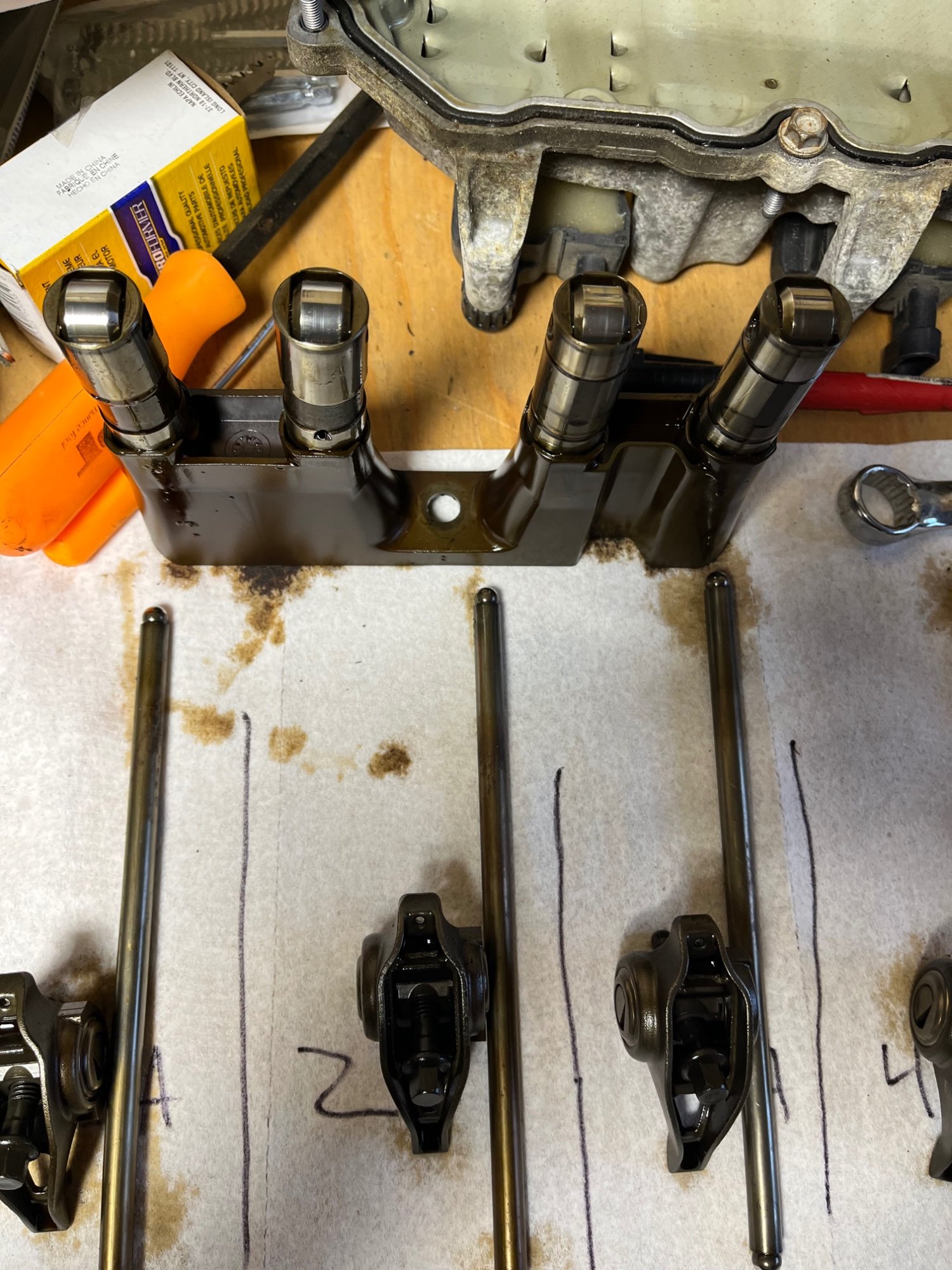

  5. Cylinder 2 and 4 lifters
