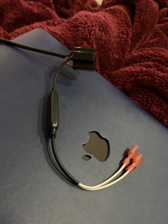

  1. I am currently sitting in front of boost autos High beam to spot mirror mod for the 2019+ HD trucks. This kit taps into the BCM using a relay and a diode to achieve the spot lights on while in drive. I'll attach a install link that shows the wire taps in the BCM. Although this kit sounds nice, I don't want my Task lights (spot lights) on whenever my high beams are on, but rather have the option to use the stock dash button to achieve my desired lighting while in drive. From what I've broke down I believe this to be a ground activated relay and could be done differently then tapping into the high beams. The kits relay is wired as follows: 30- red to fuse with a jumper to 30, 86-black, 85- red jumper from 30, 87- dual outputs with diode. Could anyone simplify this for me to where I can either just always have use of my mirror lights in drive or park, or what I need to wire/jump etc to achieve this? I feel like I'm over thinking this and there should be a simple answer that tricks the truck's mirror lights to believe they are still in park. Maybe a ground wire just tapped in or something???
