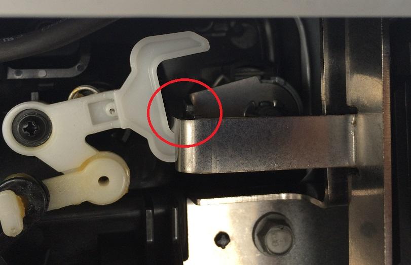

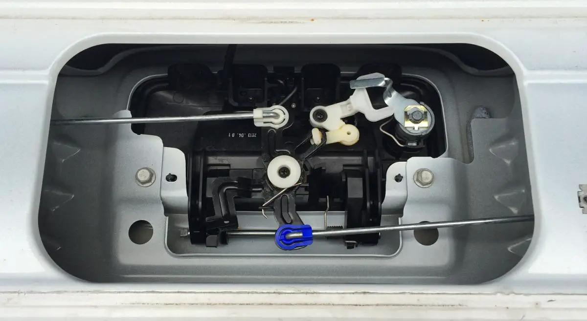

  1. Pop & Lock Power Tailgate Lock Part #: PL8140 http://www.popandlock.net/Power_Tailgate_Lock/Power_GM_Tailgate_Lock/Power_Sierra?product_id=141 1) Unlock & lower tailgate. 2) Remove (8) torx/star screws from inner tailgate access panel. 3) Remove panel and you'll see lock assembly [pic 002] 4) Remove old retailer clip & cam arm [pic 003] 5) Replace with new cam arm & retailer clip [pic 003] 6) Remove bolt on lock side, and place power assembly inside, lining up existing holes [pic 004] 7) Make sure metal slide in between white plastic prongs, next to cam arm, then replace & tighten bolt [pic 005]
