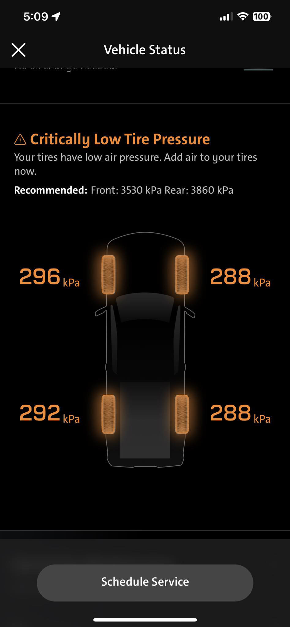

Owners woke up yesterday to text messages and app alerts about tire pressures being low, prompting some to think they had an issue or worse, something nefarious had happened. But it turns out the truth is stranger than you might imagine.
Users on GM-Trucks.com Facebook Groups and Forum started posting their experiences. Turns out that the problem was not the tire pressures- but what GM thought the recommended tire pressures should be.
“I’m not quite sure how to get the tires up to the recommended pressure anyone have any ideas? Just got this notification this morning.”
“I got the exact same notification this morning. At first I thought all my tires got slashed. Then I saw the numbers.”

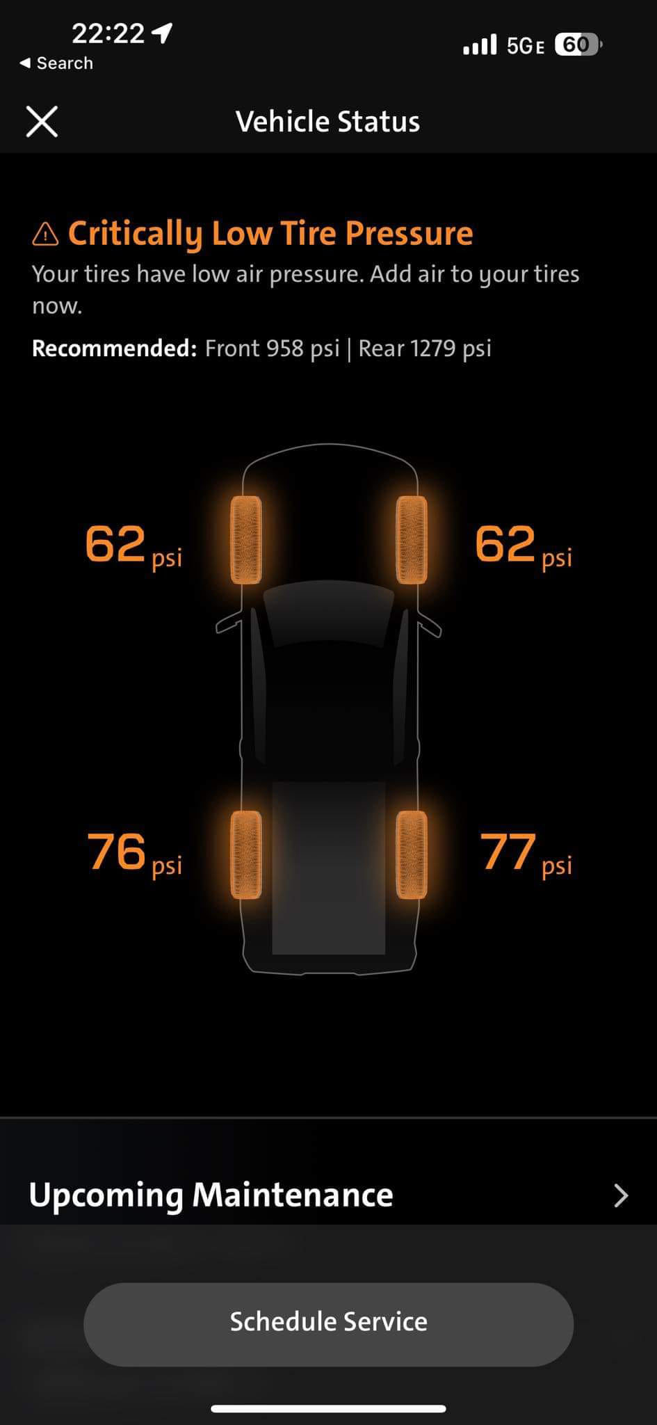

“Damn that’s 3X the recommended pressure of a semi tire. good luck with that”
Other users saw similar errors but wildly different recommendations. Light duty, heavy duty- it didn’t seem to matter. Even Corvette owners had the same issue.
288 kPa is 42 psi
3530 kPa is 512 psi
