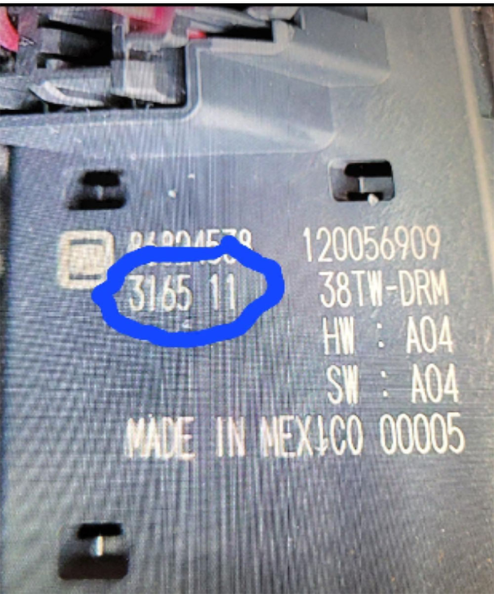

Investigations have pinpointed a potential flaw in the diode within the power window switches as the culprit. PIT6103A provides a clear solution: inspect the date codes on all four power window switches. The issue could be isolated to just one or involve all four switches, making it crucial to check each one.
For vehicles experiencing these symptoms, the resolution involves replacing the window switches with specific date codes.
For Blazer EV owners, switches with the following date codes require replacement:
Drivers Door: 3245 or lower
Passenger Door: 3266 or lower
Rear Doors: 3266 or lower
For those with Colorado or Canyon models, switches with date codes require replacement:
Drivers, Passenger, and Rear Doors: Between 3156 and 3266
