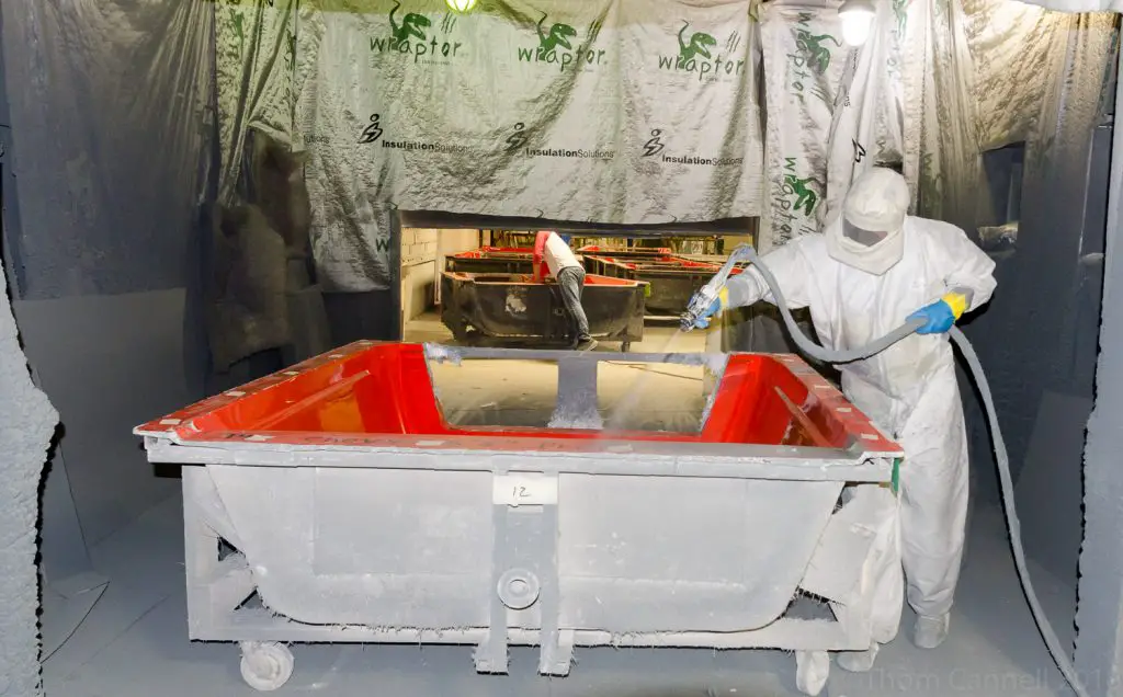

Every pickup cap or tonneau to starts with a mold. They’re expensive to build and require maintenance after making a few dozen caps. The first step in production is to spray a release compound into the mold, followed by a spray of gel coat. Matt says the gel coat is sprayed in three layers to a thickness of 20-mils. It is the primer gel coat that, when out of the mold, is color-sprayed.

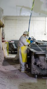

In the next, critical step, the mold is sprayed with chopped fiberglass, resin and catalyst. The spray is delivered by a special “chopper” gun, which is fed both liquid and a yarn of fiberglass.

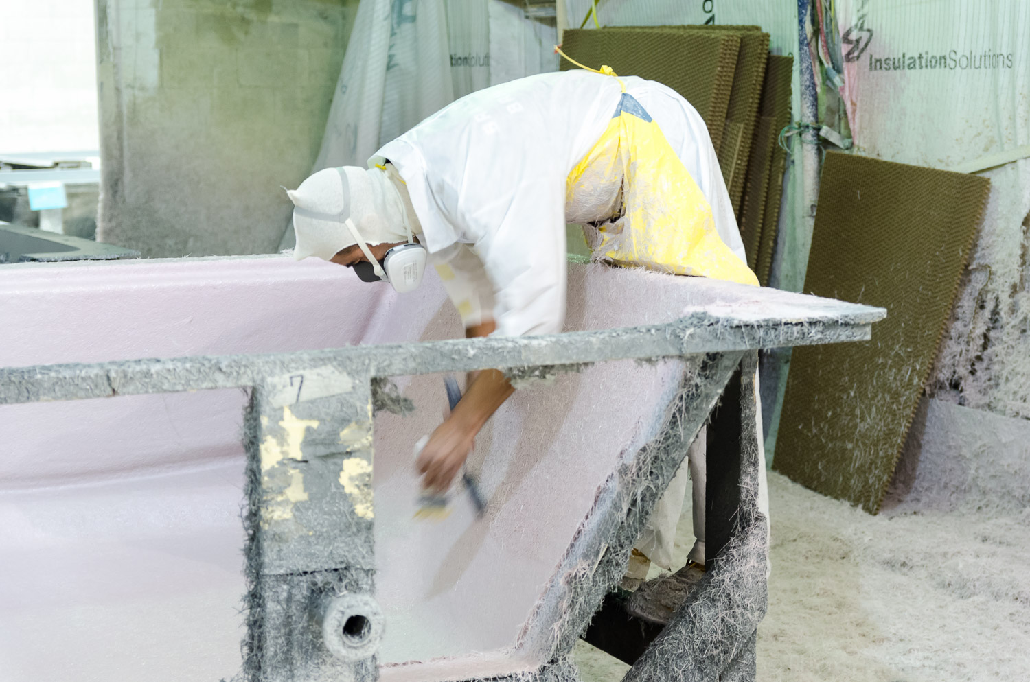

After spraying the first lamination layer, it must be rolled out to eliminate any air bubbles and also compact the layer.
After the initial layer of chopped fiberglass and resins, a cardboard honeycomb is placed into the upside-down mold. The second layer of catalyzed resin permeates the honeycomb, becoming solid and preventing sags in the roof. “It’s hard as a rock,” according to Matt.

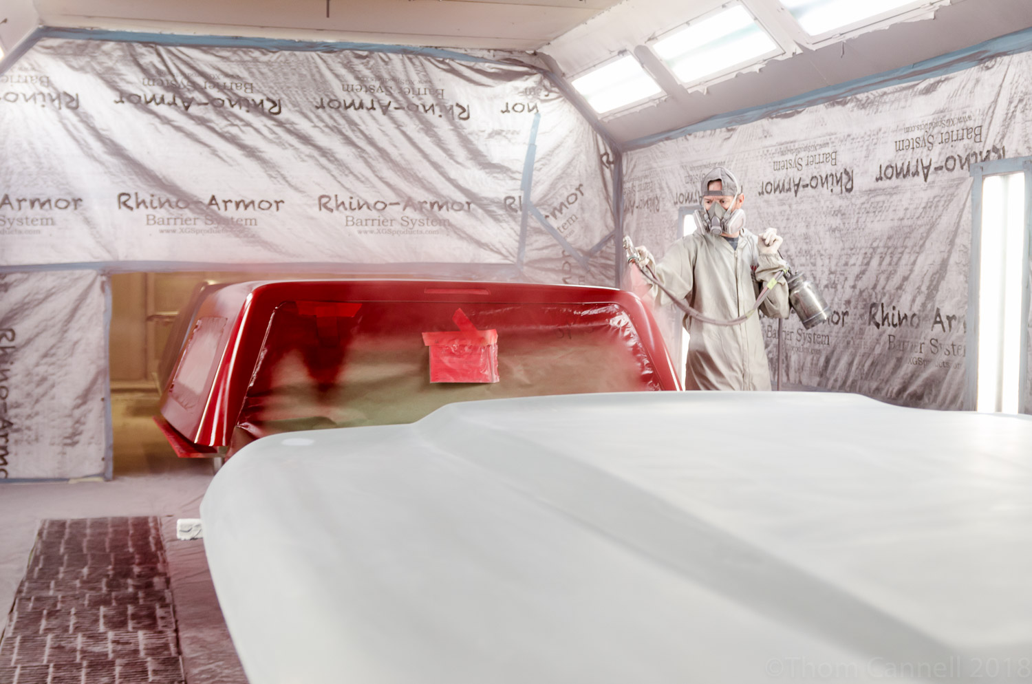

There’s a saying—it’s true—that preparation is everything when painting. Ranch obsesses over paint prep, and then applies the base color coat. Next, the top or tonneau goes into a second spray booth where clear coat is applied.
Paint and clear coat are then baked in a 140-150° bake oven. A good thing to know; although this is OEM-style paint, you can’t head into a car wash of any kind for at least a month, according to Matt, who notes that their paint standards are the same as BMW or Toyota. That’s why the color match that precisely matches your truck’s surface.
