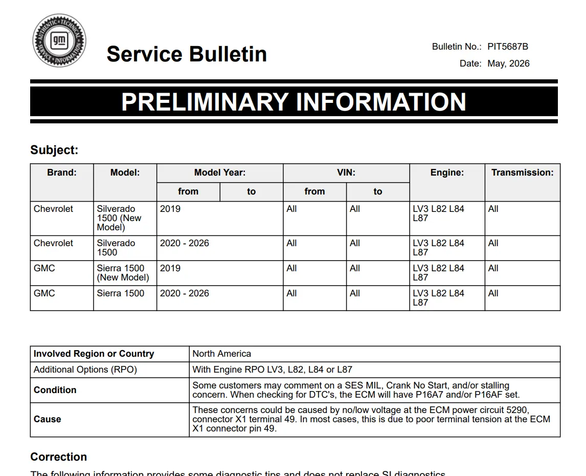

According to an updated Technical Service Bulletin (PIT5687B) released in May 2026, a simple loose wiring pin is causing massive electrical headaches for owners of 2019 through 2026 Chevrolet Silverado 1500 and GMC Sierra 1500 pickups.

A digital screenshot of General Motors Technical Service Bulletin PIT5687B, outlining the crank no-start and stalling condition for 2019 to 2026 Chevrolet Silverado and GMC Sierra 1500 trucks.
According to official GM documentation, if your V6 or V8 truck is experiencing a crank no-start condition or throws a P16A7 or P16AF code, a loose ECM pin is likely the culprit.

It all comes down to a poor connection. The ECM needs a solid, uninterrupted power supply to keep your engine running. The GM bulletin states that power circuit 5290 at the ECM X1 connector (specifically terminal pin 49) can suffer from poor terminal tension.
In plain English: the metal pin connection is simply too loose, causing a drop in voltage or a complete loss of power to the truck’s brain.
