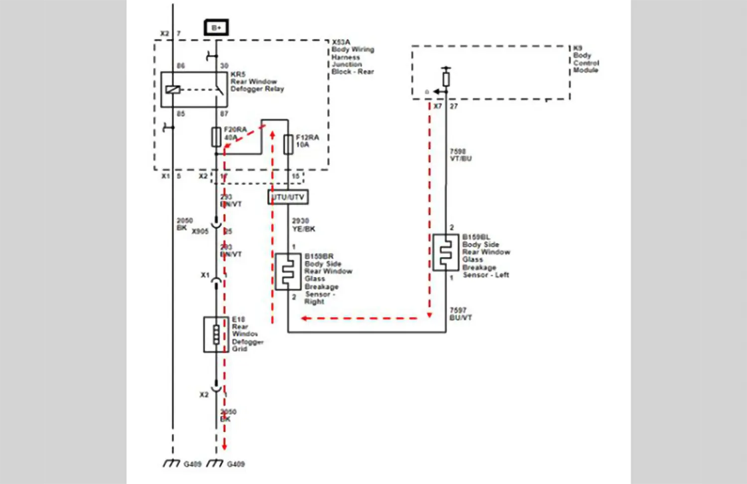

The issue stems from the Content Theft Deterrent System and a specific circuit known as the “glass breakage loop.” This loop is a continuous electrical circuit that connects the rear window defogger grid and the rear quarter glass panels. The Body Control Module (BCM) constantly monitors this loop by sending an 8-volt reference signal through it. Under normal conditions, the complete loop should have less than 20 ohms of resistance to ground. If someone breaks the rear glass, the circuit breaks, resistance spikes, and the BCM triggers the alarm. However, if there is a poor connection or high resistance anywhere in that loop, the vehicle’s computer can easily get confused. It might trigger a false alarm or stay awake entirely trying to monitor the faulty circuit. This creates a parasitic draw that can completely drain your battery overnight.

If you bring your SUV in for a dead battery or phantom alarm, technicians will hook it up to check for Diagnostic Trouble Code (DTC) B192A (Glass Breakage Sensor 2 Signal). If that code is present, they will test the BCM and measure the resistance of the glass breakage loop using a specialized test probe. If the resistance is over 20 ohms, they will have to hunt down the poor connection. This high resistance is most commonly found at either of the rear quarter glass assemblies. If you haven’t touched your rear windows with tint or stickers, this should be a straightforward warranty fix. But if you have, be prepared for the dealership to hand you a repair estimate instead of handing back your keys.
