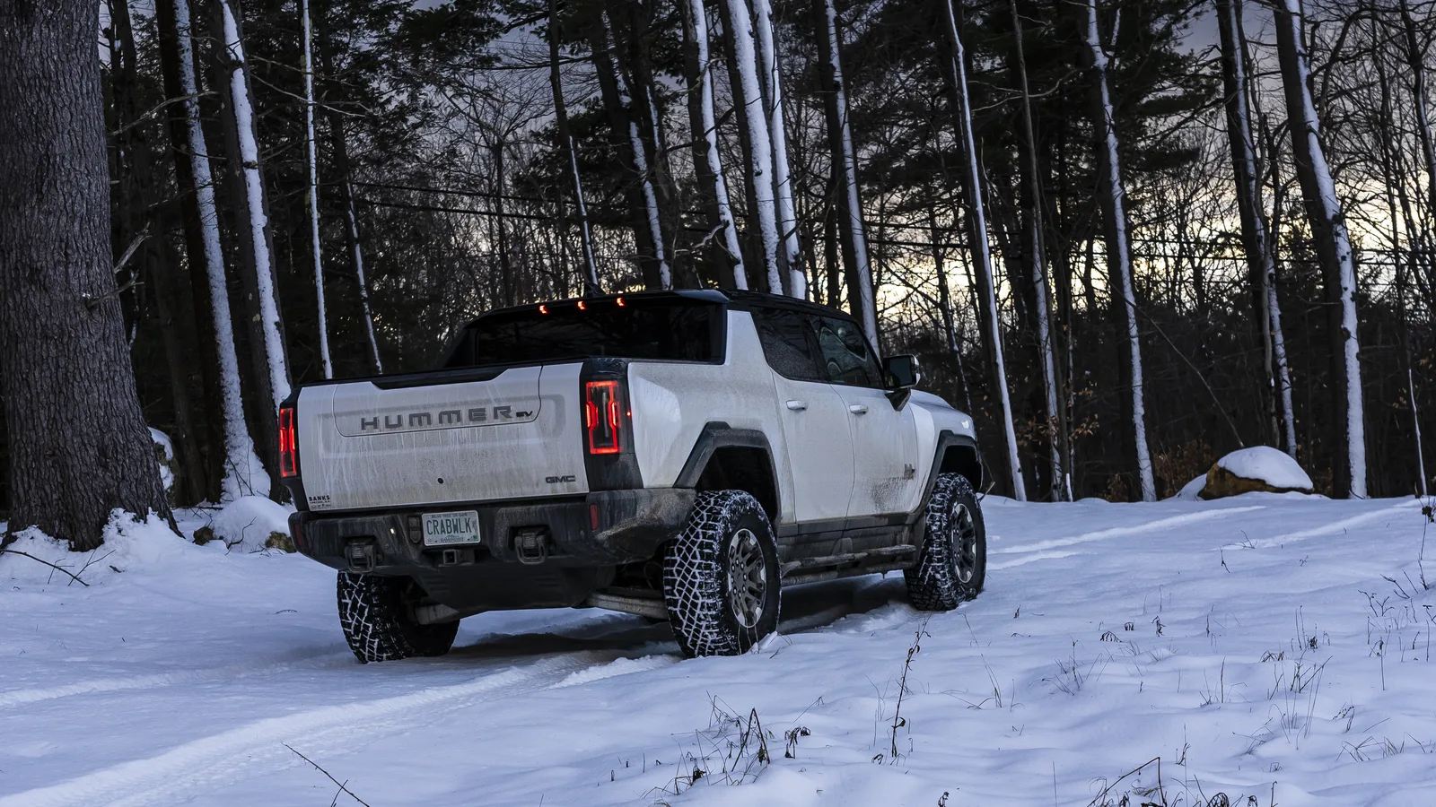

White GMC Hummer EV pickup truck on a snow-covered trail in the woods at dusk, seen from the rear
Both GMC Hummer EV body styles are listed in GM’s ghost blind spot alert bulletin for 2026.
