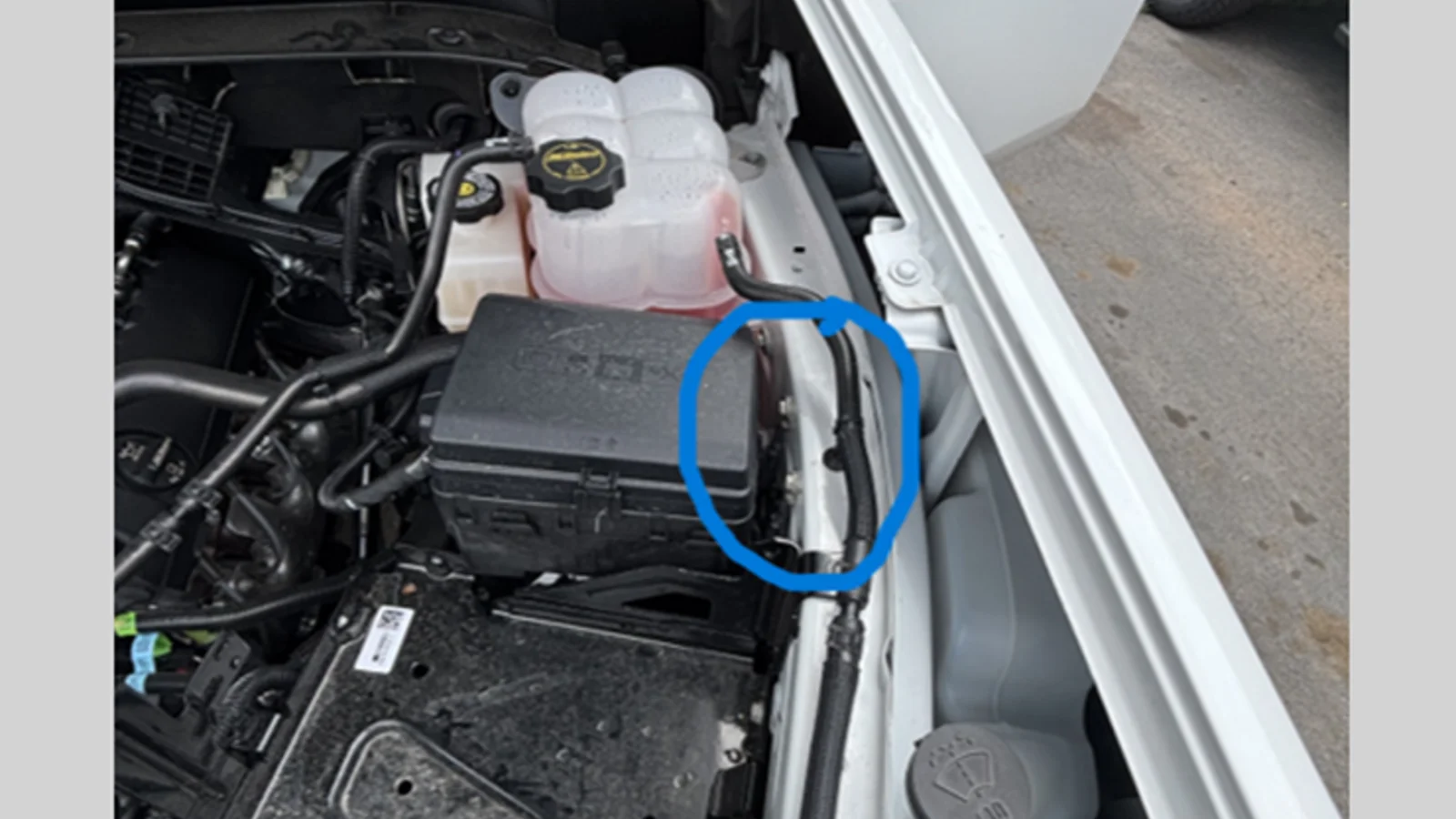

Under hood of a Silverado HD truck with a blue circle marking the location of grounds G103A and G103B next to the coolant reservoir and fuse block
Grounds G103A and G103B are located under the hood next to the X50A Engine Wiring Harness Junction Block on Silverado HD and Sierra HD trucks. Photo: GM TechLink.
All of these electrical gremlins can trace back to high resistance at grounds G103A and G103B on the body wiring harness. On the HD trucks, both grounds live under the hood on the inboard side of the left body structure, right next to the X50A Engine Wiring Harness Junction Block.
When the mating surface where those grounds bolt to the body gets corroded or contaminated, resistance climbs, voltage gets flaky, and modules all over the truck start losing their minds.
The Fix: Clean the Mating Surface
The repair is refreshingly simple. Technicians clean the mating surface on the body structure where grounds G103A and G103B attach, then confirm proper system operation. No harness replacement, no module swaps, just a clean metal-to-metal connection.
