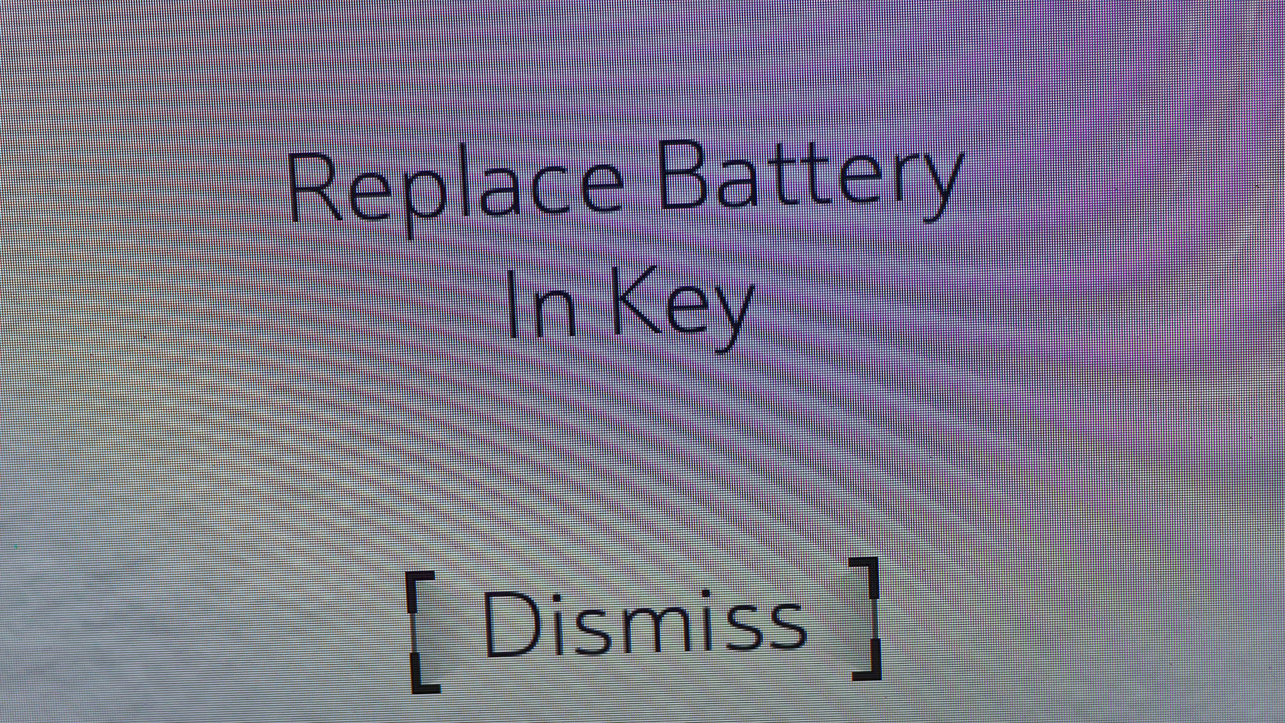

A digital vehicle driver information screen showing the text "Replace Battery In Key" above a "Dismiss" button.
If your dashboard specifically displays this “Replace Battery In Key” message, the 255-press trick won’t help—you actually just need a fresh CR2032 battery!
