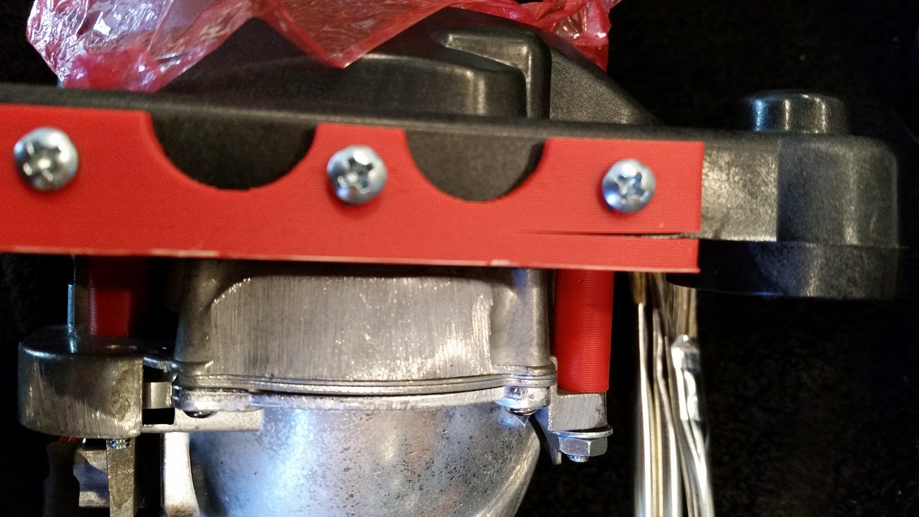

Note - I used Gorilla Glue Epoxy on all mating surfaces in addition to the screws to ensure there wouldn't be any problems in the future with further cracking/delamination of the printed brackets. My recommendation for anybody doing this mod is to chamfer the edges of the Projector Mount before you drill the holes and install the screws to relieve the stress.
