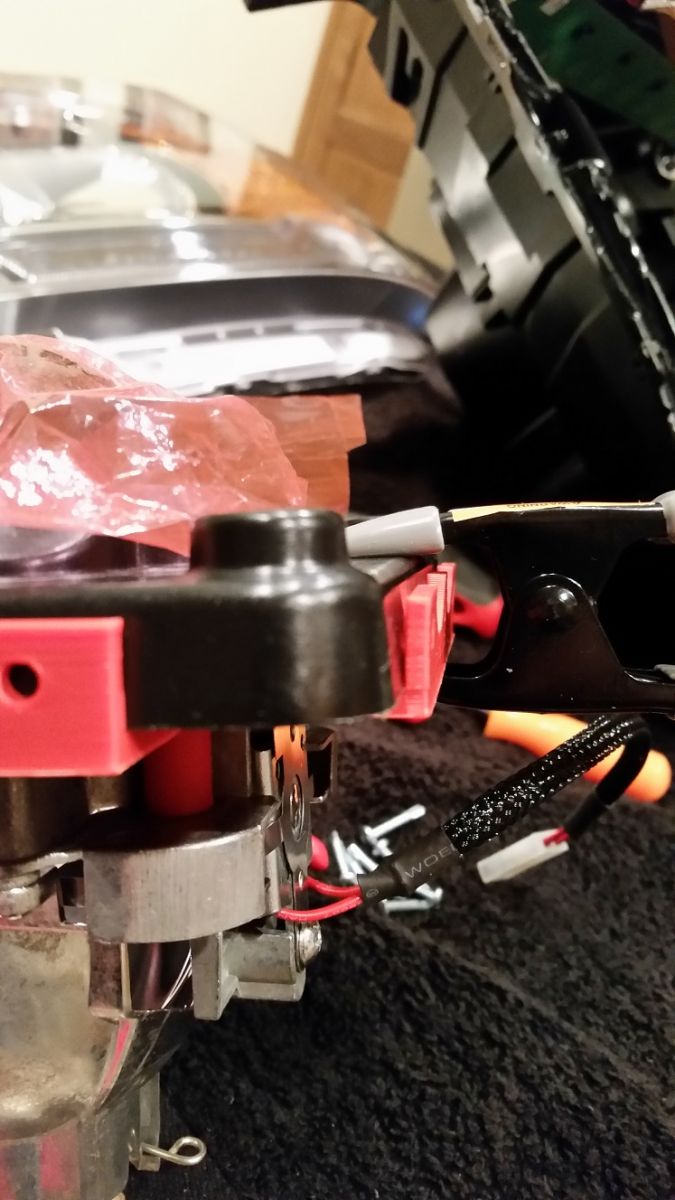

Fast Headlights Printed Brackets clamped up to Projector Mount. Note the gap at the top edge is caused by the width of the Projector Mount being just a tad wider than the bracket. I'd suggest chamfering the Projector Mount before you drill the holes for the screws.
