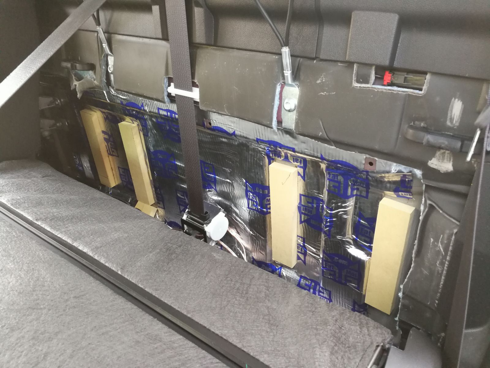

How I mounted the amp rack
Cut pieces of 3/4" MDF wood and JBWelded them to the back of the cab -- it's held the amp rack perfectly with no signs of movement whatsoever. FatMat was laid down across the whole back for sound deadening
