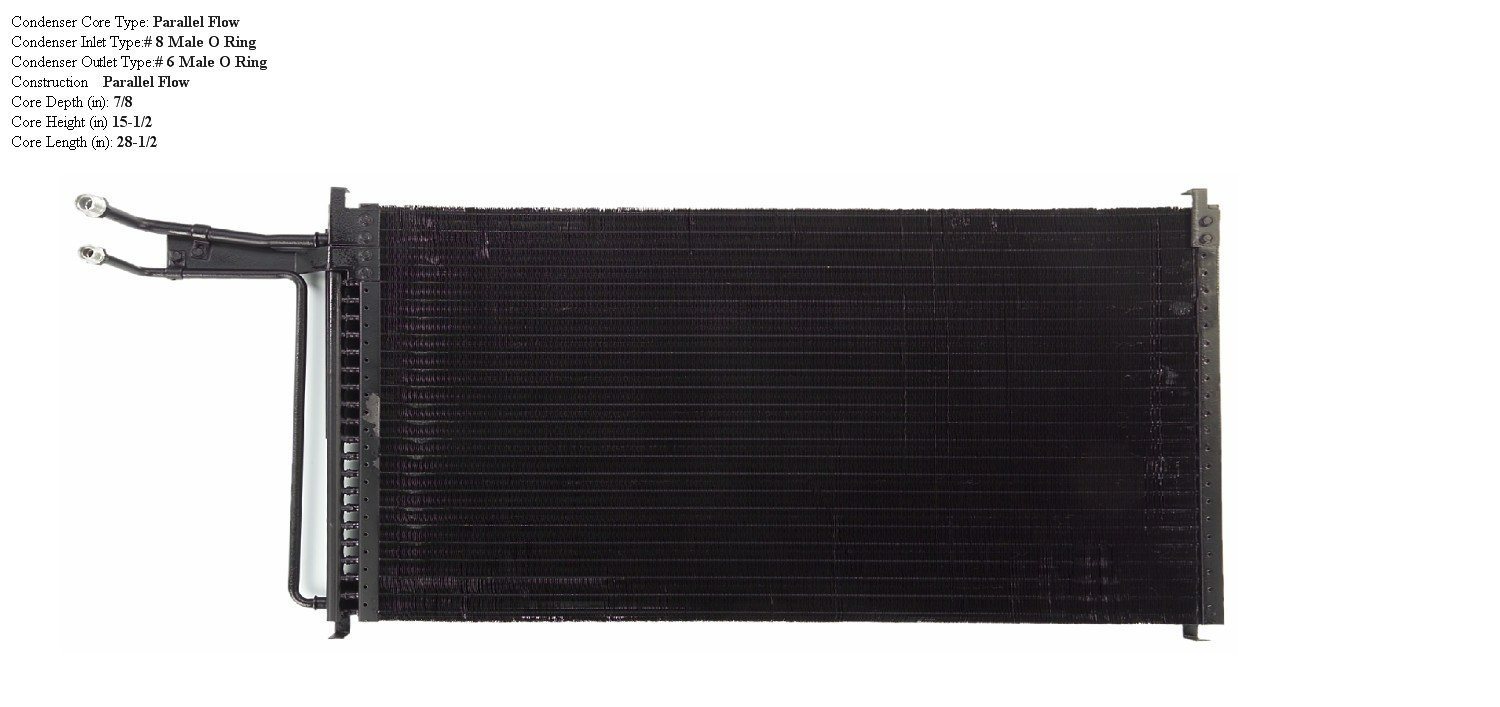

  18. No, just a restoration. An 81 Blazer has a pretty specific fit and there's nothing close that is going to work unless I feel like cutting up the core support or jery rigging it. Look at the picture of it in the original post with the out reached fittings should tell you it's pretty specific.

  24. I'm looking for a Air Conditioning Condenser for a 1981 Chevy K5 Blazer. All retailers are out of stock and don't appear to be getting any in soon. Used in good condition accepted.
