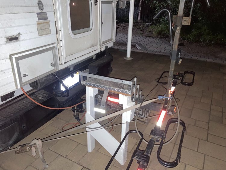

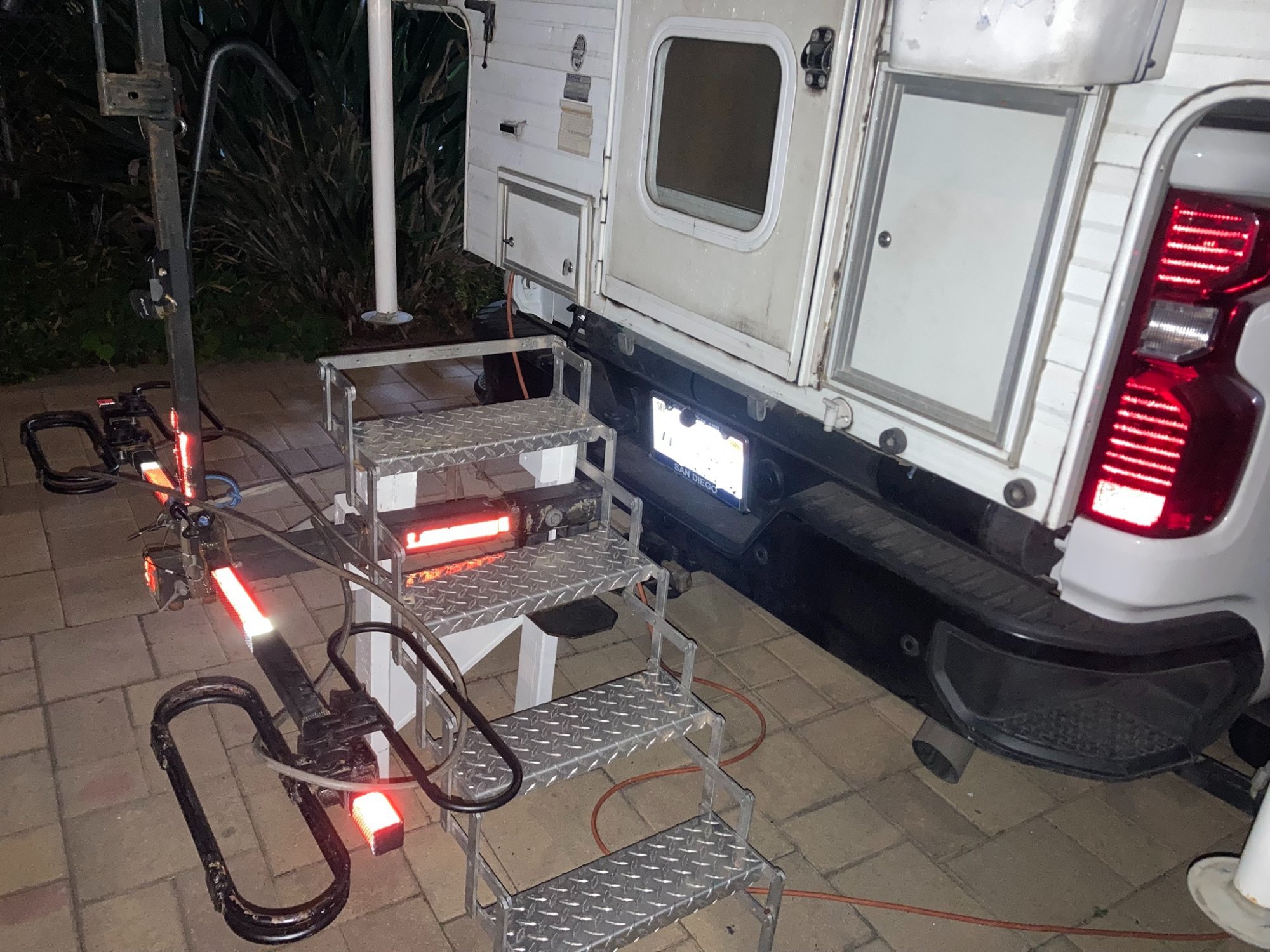

For many, many years, we have had a bike rack on the back. With hitch extensions, I could make a big enough gap to open the camper door and get in/out with the bikes mounted. I welded a step (black tongue sticking out under scissor steps) so we could step there, then on top of the hitch extension, and into the camper. As needed, we used a little step stool on the ground to get to the hitch step. With knee problems/replacement, wife can't yet step up that high, so I had to figure out a way to get more steps. Below are the pictures. The scissor step that came with the camper can rest on the hitch extension, and I built a wood structure to support and hold it in place. Works great and (most importantly) wife is happy. I added Timbrens in the back. It raised (at the axle) the truck about an inch, which is what I wanted. Yes, it rides just a tiny bit rougher . . . a lot like a 3500!! Hit some decently gusty winds in the mountains on the last trip and I think these made a big difference. Chuck mentioned a concern about only having 1 propane tank. I had that concern 19 years ago. Over the years I realized that I carry propane adapters and a spare 1 lb. canister. In the rare event you ran out of propane, just hook up the little canister. It'll run the refrigerator and heat water on the stove for a few days. Ok, probably can't run the heater or water heater. Actually, I also carry a 1 gallon propane tank for my propane generator that I never use. I've even had a stray thought about taking out one of my propane tanks and using the space for a 2nd house battery . . . still just a stray thought. If anyone is wondering, the tie-down strap in the lower picture puts tension on the bike rack so it doesn't rattle around. When bikes are on rack, another tie-down helps stabilize them (just snug tension). -
