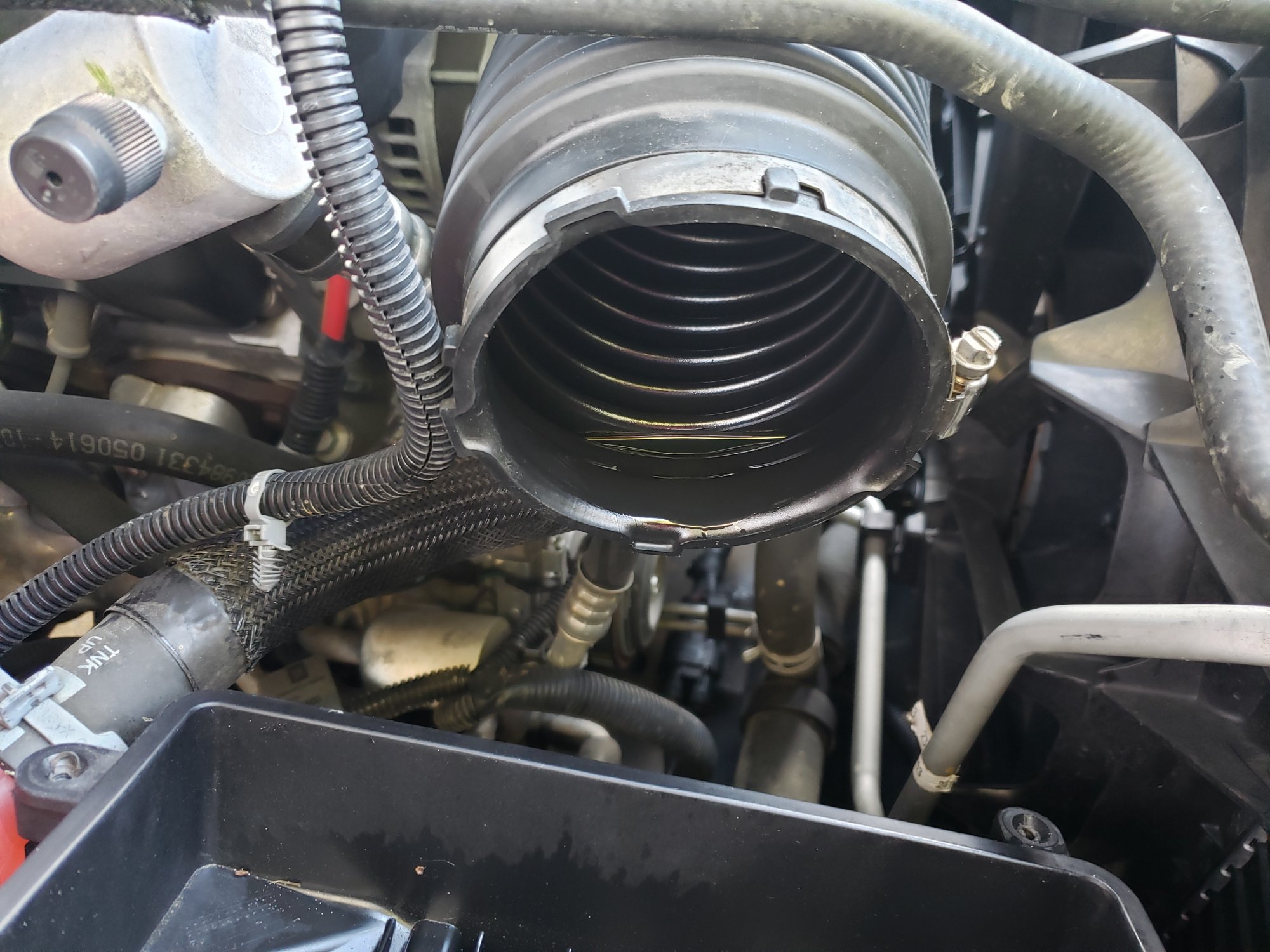

  1. Yea, it's pretty wild. I have not been back to the dealer yet, trying to do a little more diagnosis on my end. The oil is very clean so I'm curious if it's being pushed up there during an oil change or if it's from driving. Need to get a few more miles on before I decide. I'm not doing anything crazy during an oil change though, just pouring a 5qt jug into a funnel with a .5-.75 inch opening at the end. Most daily driving is relatively light foot, it spends lots of time in V4. But then I also tow 5-8klb trailers a fair amount, so it gets worked.

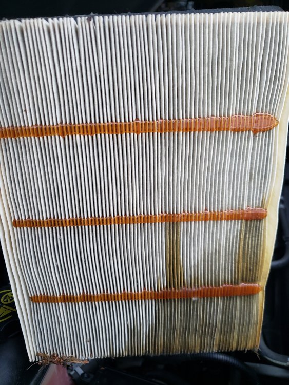

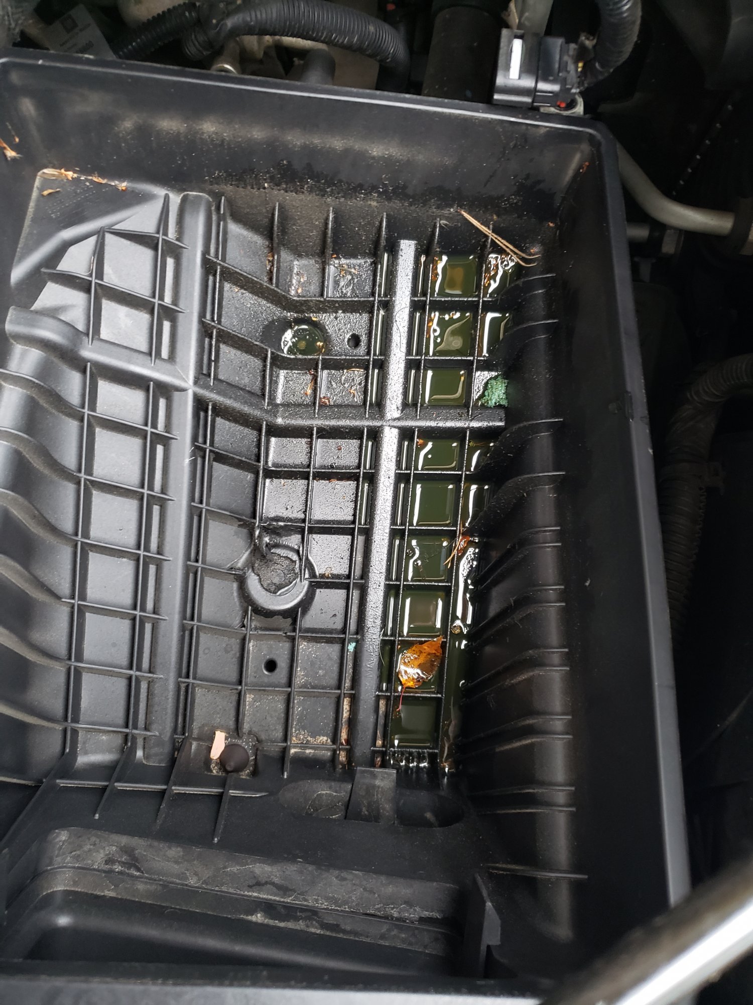

  3. That was short lived. New filter is coated and air box/duct is full of oil (only been about 800 miles since new PCV and cleaning the oil out). Will have to make another trip in
  4. Dealer said PCV valve and replaced. Also did the radiator. ?

  6. Anyone else see this on their truck? 2014, 5.3, 26k miles. Decided to check the air filter and found it oil soaked and the airbox has a lot of oil in it. Something I should take in or clean it and leave it? Don't want to pay their $99 fee to be told it's normal, but I do have a Chevrolet extended warranty. Also, I will not be adding a catch can, so we don't need to go down that road.
