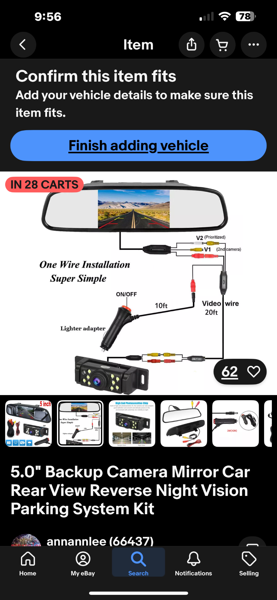

https://ebay.us/m/5OXvOD I’m dumb. I should just buy this. I’m operating off of what I tried to do 10 years ago. I didn’t realize I could just buy this. I’ve recorded front and rear view. Forget the factory system. i’m gonna look into these and the OBD-2 options… if anyone knows how to make the factory one work the way I want to please tell me. this is similar to the controller. I got for the LED light bars. This modern stuff is great.
I guess with the adapter from Amazon and the camera package from eBay I have both cameras on my rearview mirror. I can probably make it work so that the factory system still works.
I’d still like to get the rear camera to work similar to the way I’m doing it, but I guess I could always go cheap like this.. I don’t think I have any power up there, though I guess I’d have to figure out how to route it

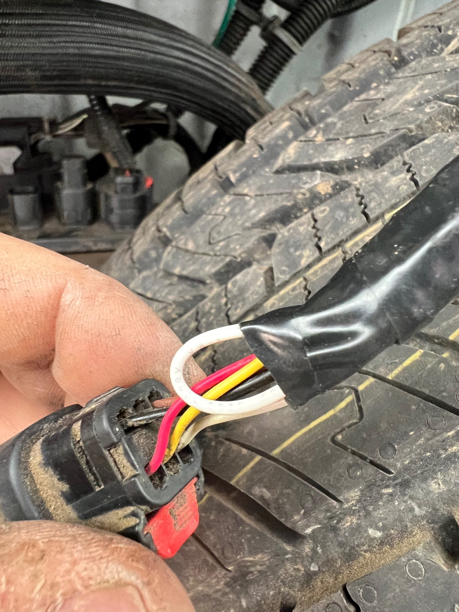

I’ve researched this for 10 years and I finally got around to doing it. Nothing on the Internet seems to help. This is a 2015 GMC Sierra 1500 WT So here is the deal there are 6 wires that go to the camera. Red, white, yellow, brown and 2 blacks Red wire is constant 12+ volt. White wire is 12+ volt while in reverse. If you apply an external 12 V source to the white wire the backup lights do come on, but the camera doesn’t. If you cut the wire, you can eliminate the backup lights, but the camera still doesn’t work. The yellow, brown, and two blacks have no voltage or negligible voltage, whether in reverse or not. I’m assuming my problem has something to do with one of the two black wires but I don’t know what it is. What am I doing wrong/missing? The goal is to install a diode, so the camera works in reverse and when a button is pressed in the cab. I already have a wire in between the cab and the Camera. But that’s pretty useless until I figure out how to trigger the camera on… I’m going to take power from the driver side fuse panel, where I have my other accessories connected so it’s only live while the truck is keyed on. Help would be appreciated.

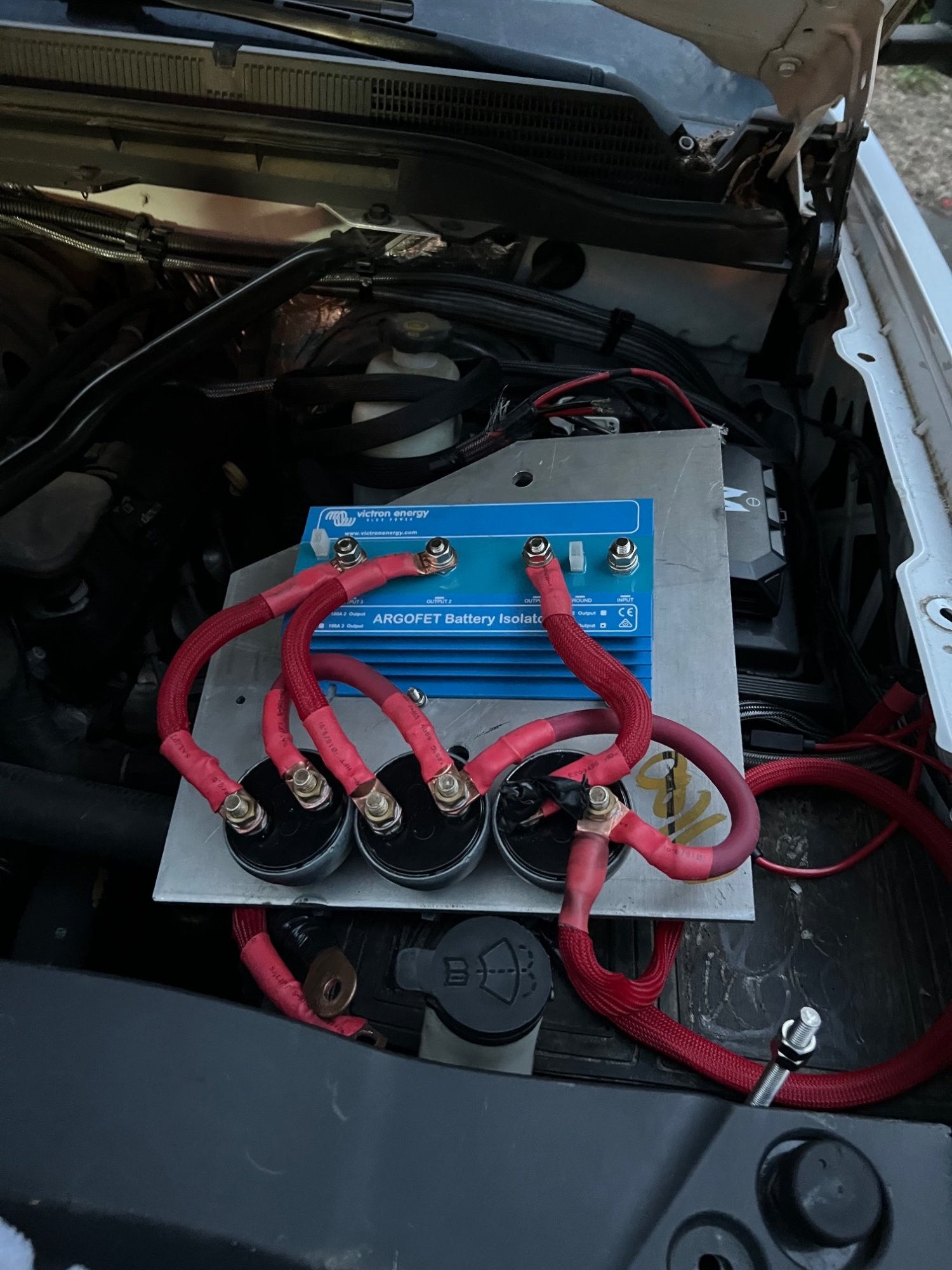

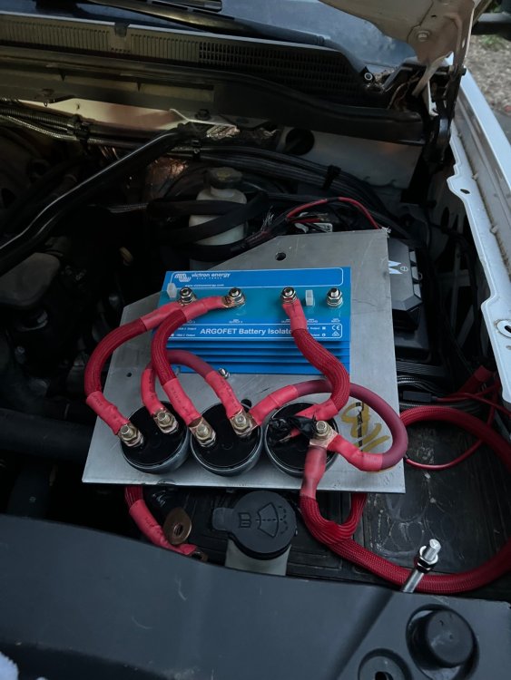

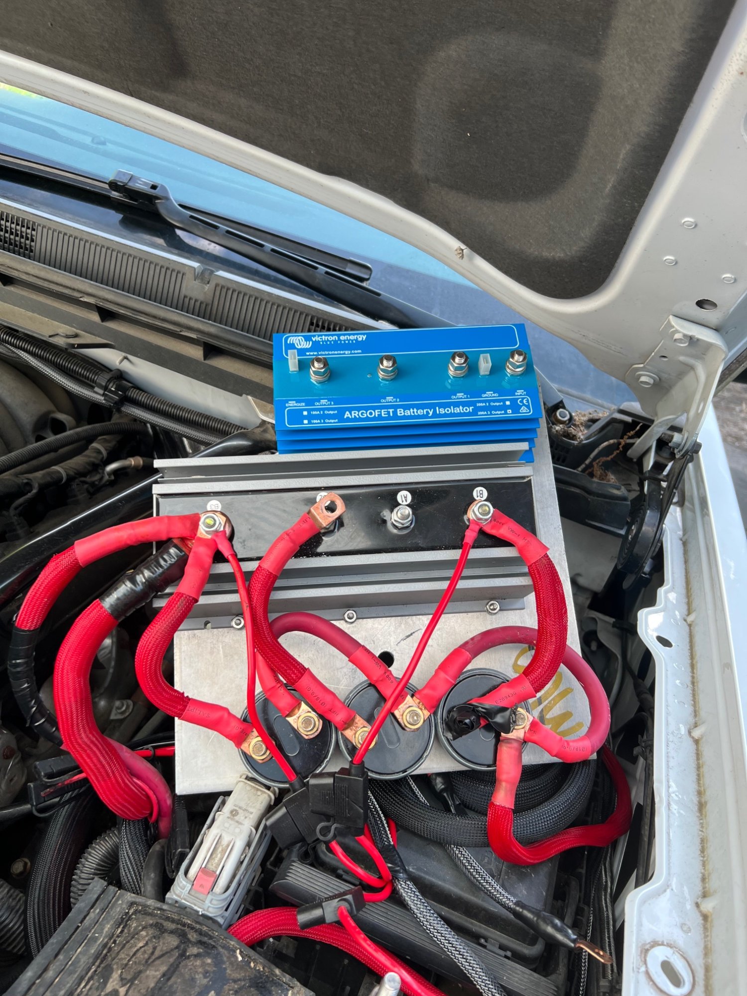

I solved the problem. I bought a modern non-diode isolator that has connections to energize the alternator. Other than that, you have to run the alternator to the input on the isolator, but you have to leave the other end of the stock alternator wire connected to the battery and its original Location. Inside the factory harness it must tell the BCU something. The new isolator is physically much smaller .. Which makes the install much more realistic and has minimal voltage drop which is a huge plus. -

I finally hooked up my battery isolator. The alternator won’t generate any power. when I have the alternator connected to the alternator post on the battery isolator and the main battery on one of the battery posts on the battery isolator. No power is generated. I do have all the grounds for all the batteries run through the current sensor “amp clamp”. I need to know how to make the battery control module “BCM” recognize the primary battery while hooked to the isolator. if I run a cable from the main battery in its factory configuration to the alternator post on the battery isolator everything works. but the issue is that defeats the purpose of the battery isolator. It would use the main battery to charge my other batteries also drain my main battery when the vehicle isn’t running. I don’t want to install a relay for the reasons listed above. how do I get this to work? and yes, I have a nine-year-old post on this. I finally just got it done. I just have figure this issue out and connect my light bars. It’s just a matter of hooking up a few wires..
