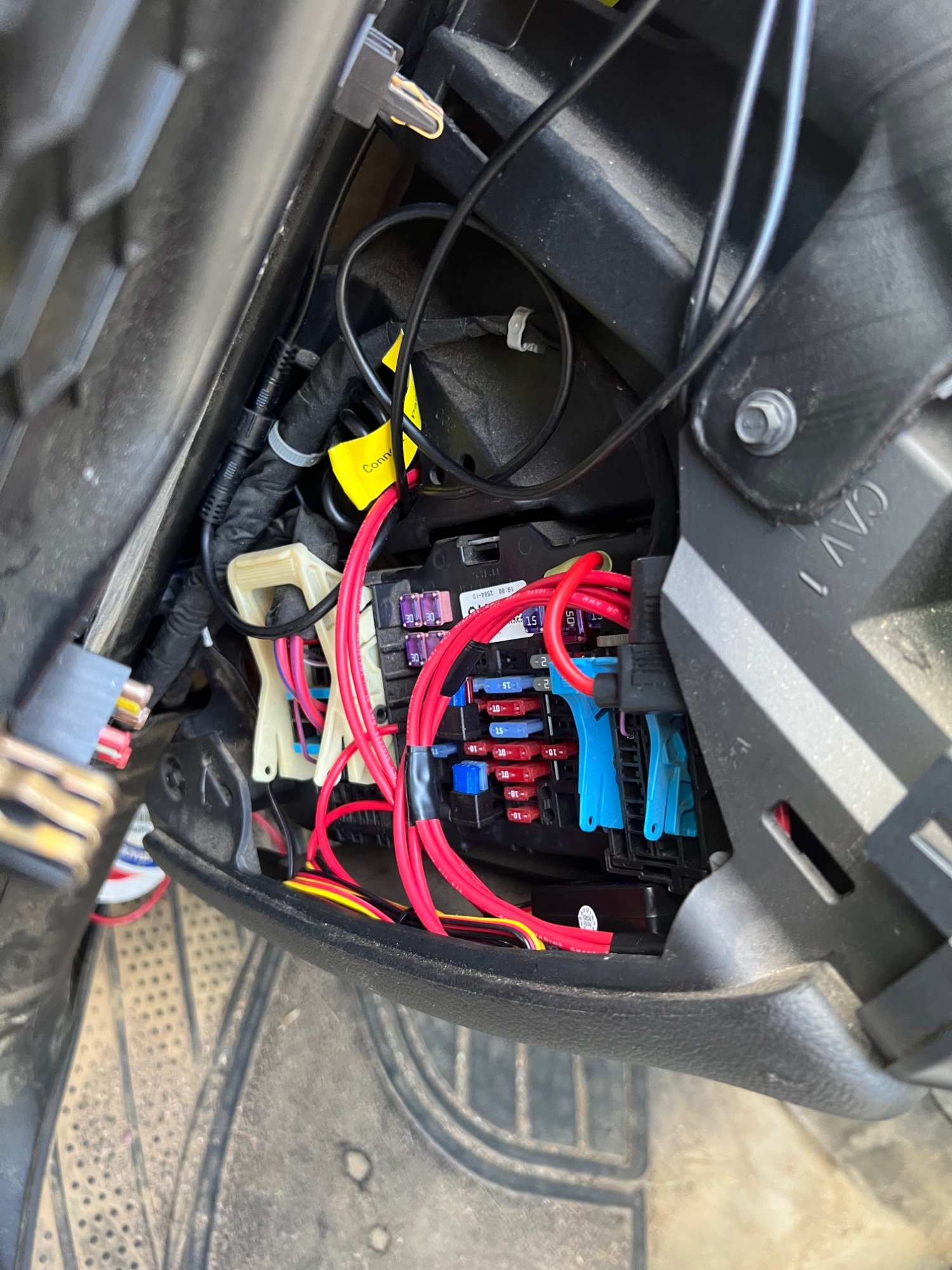

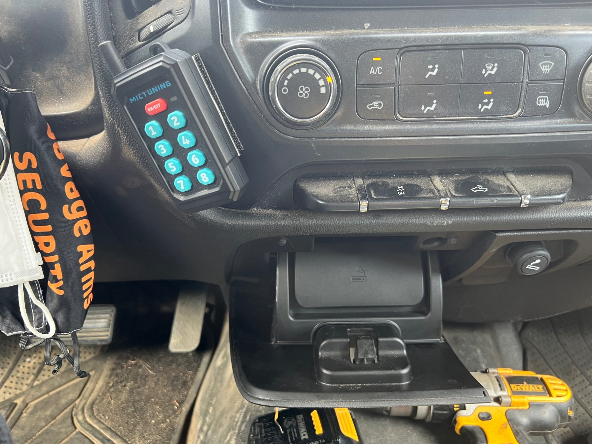

  4. To close this out. I didn’t have the wires backward . I had to put them back the way they were. IT works absolutely flawlessly now, short of a voice command for the bumper camera, but when you turn it on it defaults to that. maybe a future firmware update will improve that feature. The time lapse recording is fantastic. I wish the reverse lines moved to guide you. But in my case with not being able to see through my cap, it’s a massive improvement of factory ones worthless. The only change I might make is moving the battery positive to the three switches I used to connect my batteries.. But I don’t think that’s worth it because it has a limit of 48 hour record.. so one battery would be sufficient. But I’d like it to run off my internal auxiliary battery because it’s already on its way out so I don’t care what depth of discharge it goes to because it’s dying anyway… I also don’t want to connect it to my external auxiliary battery. Because if somebody steals it then I won’t have them on camera after they yank it. and completely unrelated, here’s a bonus photo of the smokers kit I put in I threw the drilling template and the screws inside the cubbyhole before I just threw a little double-sided tape on the insert.. 10 years ago I think the dealership told me they wanted like four or $500 for this. It was 30 bucks on eBay.

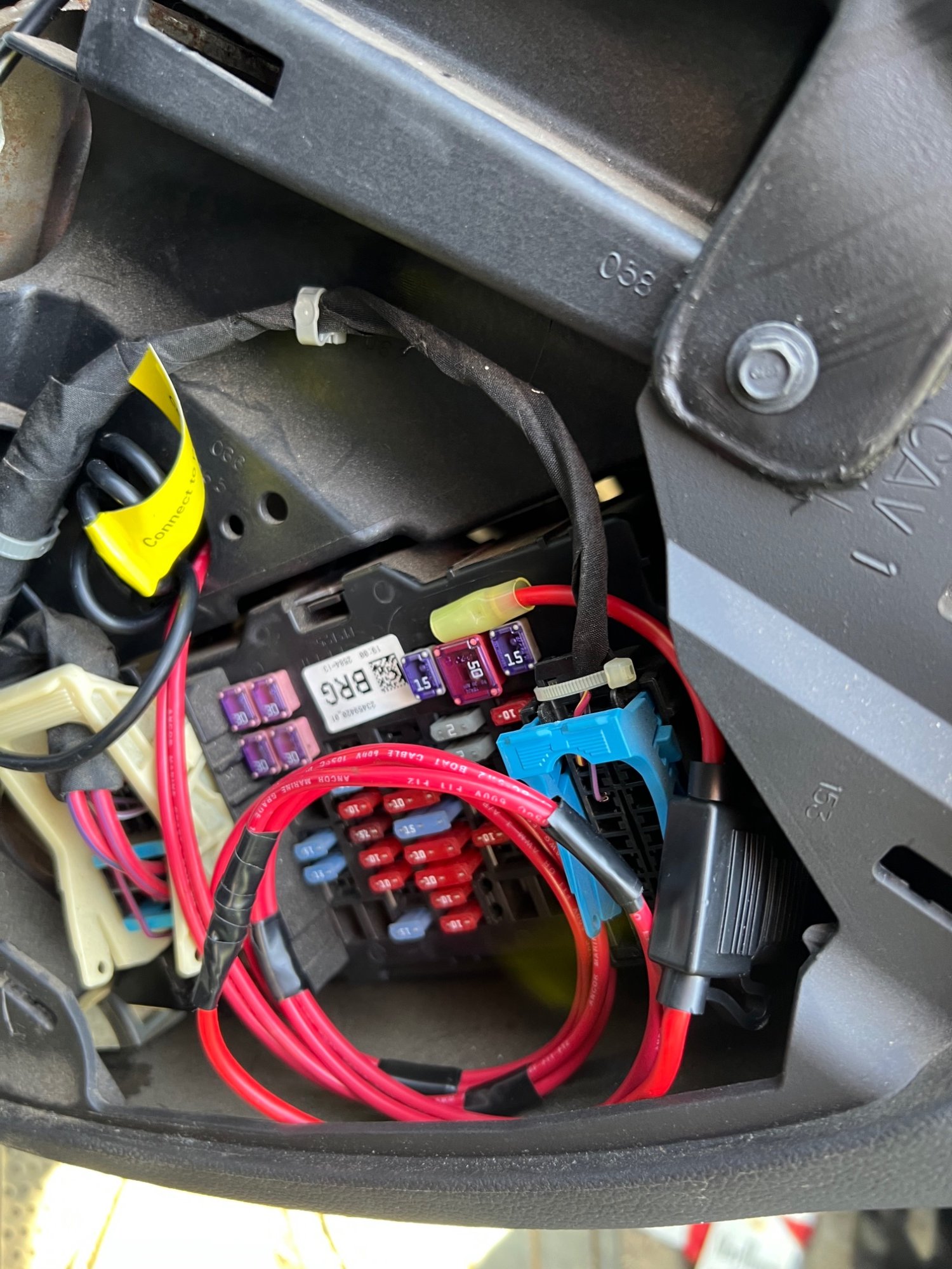

  5. I ended up using the information from this thread I used fuse 32 and 36 to tap off of. I think I had it backwards the first time because it was constant on. I just switched it and it seems to work fine. Other than that,The mirror says battery low one time and then another time it said battery level very low, but my truck doesn’t tell me any of that… I haven’t noticed it since I’ll have to check tomorrow I swear, I thought I heard it making a noise when walking past it a little while ago while it was off, but I can’t be sure I didn’t have my hearing aids in. I’m still using the accessory blade from where you would move the 50 amp cigarette lighter fuse if you wanted it to not constantly have constant power to charge your devices from for other stuff. later today, I’m gonna be installing the smokers kit and swapping out that socket for a cigarette lighter installing the ashtray. I’m likely gonna hardwire in a quad lock mount/charger for my phone at some point… I haven’t decided where I’m gonna get power from for that yet. Possibly a different location altogether. Currently drawing off the accessory for the cigarette lighter I have a three amp fuse that runs to both my battery isolator and my lightbar controller. I know I got a lot of extra wire, but I just always do that. because I had repaired where I had cut the wires on the original back up camera, I peeled back the shrink wrap and bloom. One of those wires is literally just glued together from the factory, but yeah, I tapped into the white wire and all is good for reverse.

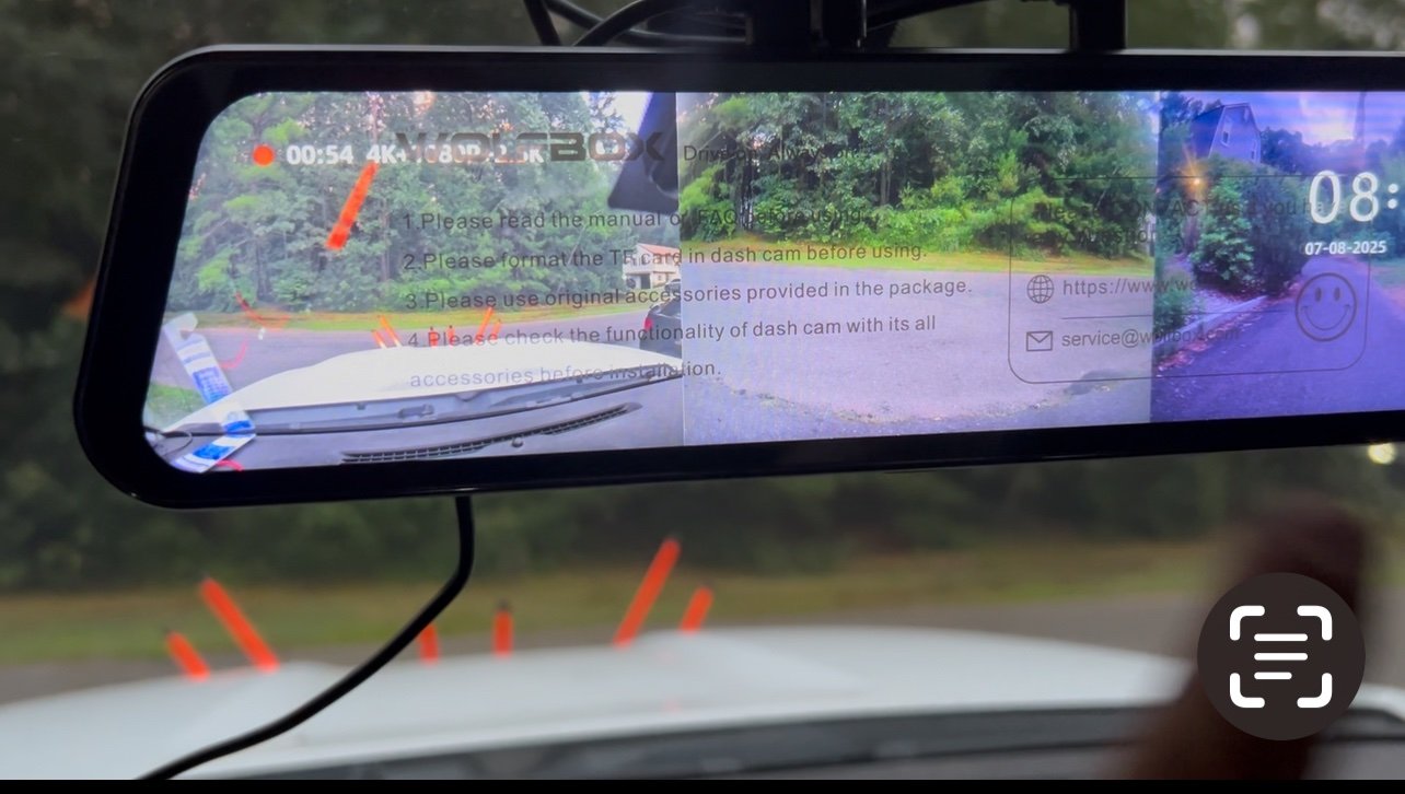

  6. Not bad.. just need to finish hard wiring, connect GPS, program it. I got Velcro on multiple places on the front. I can just move the camera around. on the back, I’m undecided if I’m gonna install another camera probably The rear camera has a red wire coming off of it that you hook up so when you put in reverse, it comes out automatically. I just have to tie that to the white wire from the existing factory camera. Apparently, I learned that the hard way.
  7. I got a J fuse holder just like the regular fuse holder in the photo so now I have access to constant power and accessory while ignition keyed.. I just have to pull that 50 amp J fuse, put it in the holder and then make a harness. I don’t think I’m gonna install a fuse block. it’ll just be the camera system, and the trigger power for my light bar controller, and battery isolator.

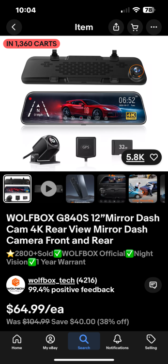

  11. You must’ve posted while I was typing. I really like that third brake light camera absolutely won’t work for my situation, though. Mine is completely obscured by my cap on my bed.. I’m sure I can look around but $400 bucks for the GM mirror is just not real I just ordered the “WOLFBOX G900 TriPro Bumper Version 3 Channel Rearview Mirror Cam” I may get additional cameras had a switch.. I’m probably gonna use some of this really good Velcro I use on everything so I can move the camera from my bumper to the end of my we which sticks out like 3 feet in front of my truck when it’s. in the rear, I’ll probably put wood in the license plate bracket on my liftgate and when I take the liftgate off, I may have one mounted on the bumper license plate or from the ladder rack.. I may or may not get some 10 foot extension cables so that way when I remove the items I listed above, I can just plug it in and avoid the switch altogether or at least for the front

  13. https://ebay.us/m/5OXvOD I’m dumb. I should just buy this. I’m operating off of what I tried to do 10 years ago. I didn’t realize I could just buy this. I’ve recorded front and rear view. Forget the factory system. i’m gonna look into these and the OBD-2 options… if anyone knows how to make the factory one work the way I want to please tell me. this is similar to the controller. I got for the LED light bars. This modern stuff is great.
