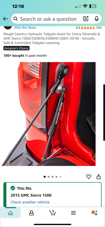

do you need any of the original bushings in there at all? Mine doesn’t have any right now. I wish I fixed this before the corner of my tailgate got bent. It’s not a big deal as long as I’m the only one to use the tailgate but anybody else does it the tailgate fall off they got all jacked up on there.
I’m definitely gonna buy these but as it is now, mine doesn’t always open all the way to flat unless you mess with it so I guess what I’m asking is will this resolve that or do I need the bushings still?

Yeah, I’m definitely gonna give this one a try only this brand because I’m putting on their leveling kit and an inch and a half a block whenever I get my ass out of bed and go to the shop

Right, but when the damper fails then a few weeks later it causes the plastic bushings to crack.  So you end up replacing both time-after-time.
OP - yes you still need the bushings in there or the tailgate will be loose.  But once you install the DeeZee cylinder you won't ever have to replace the bushing or damper again!
