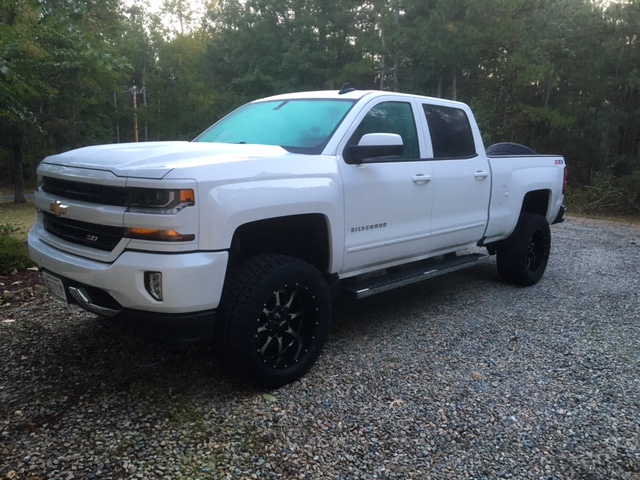

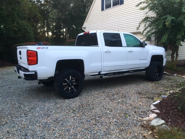

  3. 5" rough country bracket kit (keeps stop track width) with a 5.5" block on rear instead of the 4.5" block that comes with kit. So front is raised 5" and rear is raised 4.5" (stock block is 1"). Has a slight rake to it but I love the aggressive stance. Just need some power now! Lol

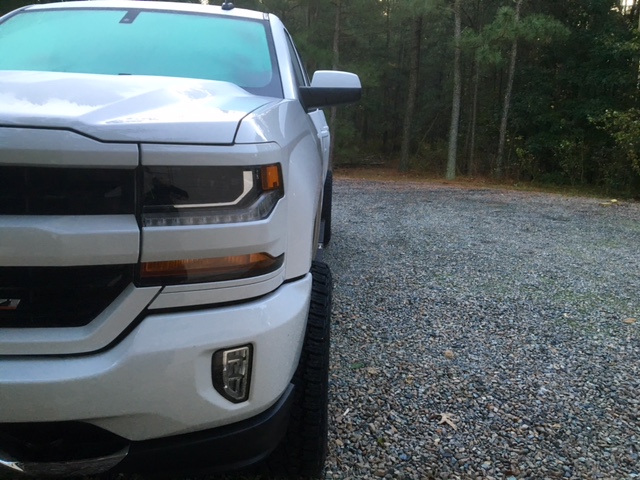

  4. Thanks man! Here is a better quality pic (still figuring out this forum)

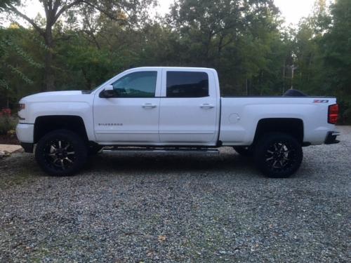

  5. Hopefully this is a better quality picture lol
  6. 5" rc lift. Kit comes as 5" lift in front and 3.5 in rear (comes with 4.5 block but your supposed to remove stock block) I did the 5" in front and left stock block in back for a 4.5" lift in back. Kit was a pretty smooth install and rides great
  7. 20x10 moto metal MO970 machined Offset -24 Wrapped with nitto terra grappler g2s 305/55/20

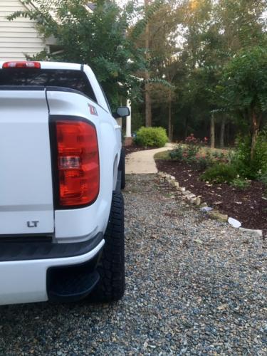

  8. New on this forum. Has been very helpful in finding the set up I wanted to run after endless hours on here lol. Bought my 16 Silverado 1500 2 months ago. Finally installed my lift last week. I'm running the 5" rc lift (bracket kit- keeps stock track width). Kit says to remove stock block from rear. . . I kept mine in I like the raked look. (Can't tell by these pictures will post better ones later) running moto metals 20x10s on nitto terra grappler g2s. Very minor trimming on inner lower valence. Other than that rides great! Imo I think it looks great!
