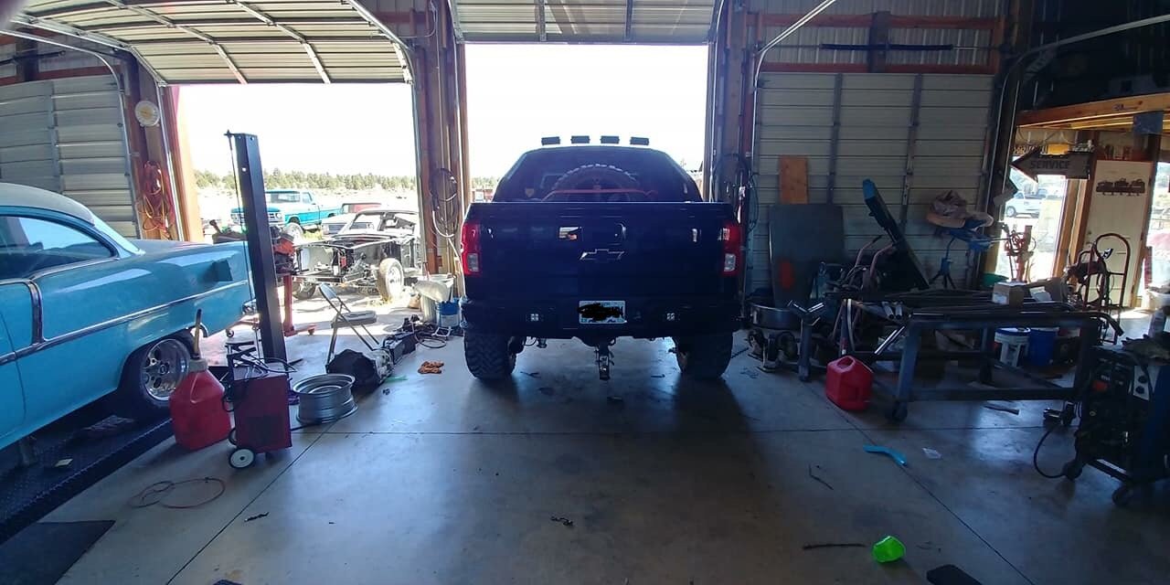

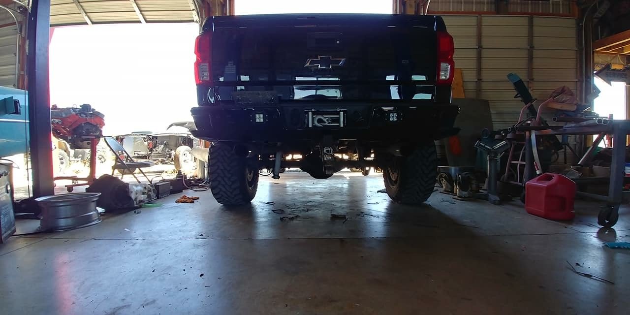

  17. Rear winch done. I welded these brackets and plates onto the hitch receiver.

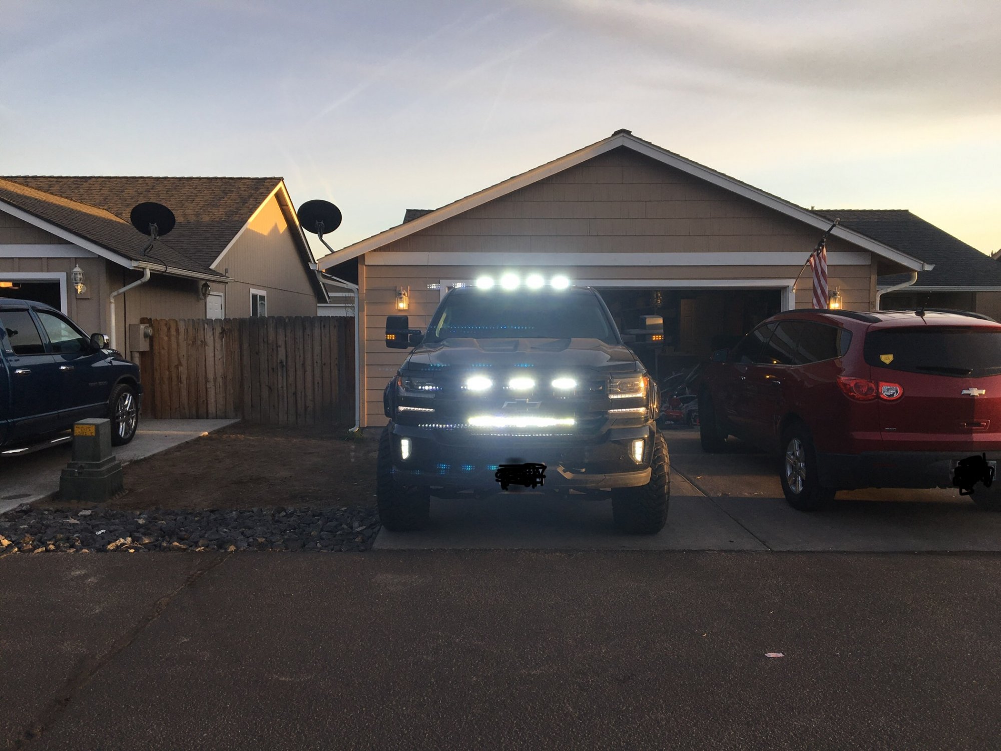

  18. What would you like to see? Current mechanical mods are a mild cam, dual Borla Exhaust, 4.11 gears, 4 corner air bags, compressor pump and 3 gallon tank, 50 gal aux fuel cell with auto pump to main fuel tank, front hidden winch. Full Upgrade tow mirrors (DQS). As stated 6” lift, 35x13.5 tires, fuel beast 20” wheels -44 offset. This week I am doing the rear hidden winch and upgrading the fuel injectors. Future mods will be a supercharger and power output to 700hp... hopefully. I have quite a bit of LED lighting on this as you can see. The sport bar is the GM aftermarket bar and I added the 2 middle lights. I have the spare 35 in the bed of the truck leaning against the tool box with a bracket that I built for that. Following the angle of the sport bar.
