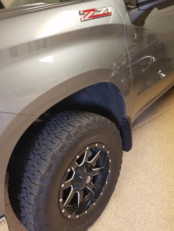

I put 18" wheels and 305X65 Goodrich T/A's on my 2019 ZR1, with a mild 2" factory lift. I went 18" for one primary reason, I like to air down when off road or spending a lot of time on rough back roads. I run at 35 psi on the road, but go down to 23 -25 psi off road, no lower so the bead doesn't "roll" off the rim. The ride improvement is noteworthy to say the least, less jarring and tail-end bouncing, and the tire just "conforms" to the trail when really 4X4-ing; crawling over the really challenging stuff. The T/A's have a lot of tread on the sidewall and with the lower pressure you just get a lot more compliance with the surface and much better traction. It also really helps in sand which you spend a LOT of time on in this part of the country (AZ, UT, NM, some areas in CO). I also just feel personally that a 4X4 looks better, more "right", with more sidewall on the wheel. The down-side of course, is how far on the pavement you have to go to get a decent place pressure station to re-air. I have had no issues traveling 20-30 miles on the pavement at the lower pressure at 70+mph as long as I keep in mind the lower cornering capability of the truck (minimal). Them damn little plug-into-the- lighter compressors take forever to air up big tires, so I just drive to the closest service station on the pavement. Never had an issue with the tires, and I've been doing it for a loooong time on all the 4X4's I've owned over the years. YMMV...... -

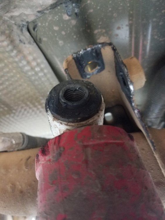

A FWIW update: Done a few dirt roads and one serious off-road trip into the majestic Sonoran Desert I live in. Off-road included serious articulation on extreme inclines (forgot to check my inclines in the DIT ?); boulders, big rocks, washouts, loose rock, that kind of stuff. Fun! That truck is very capable in pretty challenging terrain. I like it better every day. A little Stevie Ray Vaughn on the Bose made the "test" that much better. Crawled under with a wrench this AM. Mount bolts are still tight. ? Locktite? Maybe........ -

Why not? Suppose the sleeve inside the shock mount bushing tends to compress or wear just enough that the tension on the bolt is reduced? What if there's some super funky harmonic that develops in that particular location that backs the bolt out? Maybe, since the bolt is not shouldered, it's fully threaded, that the interaction between it and the inside of the sleeve creates a dynamic that loosens the bolt (you can see the marks of the threads inside the sleeve in the photo). Maybe a combination of all of those factors? Danged if I know. Are you telling me that you've never, ever, in your whole life, ever had a properly torqued fastener back off? Like, ever? I sure have..... And, somehow I doubt that a TTY bolt is used on a shock mount...... Anyway, here's the deal: as I said earlier, take it for what it's worth. I'm just passing along my anecdotal experiences FYI. Readers of the thread can check the bolt on their truck, they can even back it out and put some locktite on it just in case, it's easy to do. Or not. It's a lot easier in the driveway to find and check the bolt than it is on Black Bear Pass. YMMV.... -

I don't think this was a dealer screw-up; although that was, of course, my first thought. But I've gotten to know the suspension tech that did the work on the suspension pretty well, and he's very thorough and meticulous. He takes a lot of pride in his work, and was very embarrassed/concerned that it might have been his bad. I watched him re-torque everything else he did and the rest checked out just fine. It was one of the other techs there that said he'd seen 5-6 other instances of this happening even on stock trucks. Take it for what it's worth. I think I did suggest in my OP that others reading this thread to "put a wrench on the bolt(s) or even pull it out quick and put it back with some locktite." And, yeah, I can go to another dealer for future work, but who knows what you'll get there? And, things are different these days than maybe 5 years ago; getting another dealer to work on your truck that you didn't but from them can be problematic on a few different levels. They can be real pr'ks...... Ask me how I know....... -

Just a heads up from the "For What It's Worth Department" Started hearing something coming from the back when I went through deep dips and especially going over those speed control bumps in parking lots, like some loose pipe or 2X4's were bouncing around in the bed; and the back end was a little "bouncy". Nothing in the bed, so I crawled under and noticed the top right shock mount bolt was gone, and the top of the shock was whacking the mount, frame, and underside of the bed. I have a dealer-installed factory 2" Rancho Iift on my 2019 Z71 Silverado. Took it in to the dealer, and while it was on the rack I talked with the suspension technician guys. One of the techs said he'd seen 5-6 of these, on stock suspensions and a Trail Boss, always the top right shock mount. Like, it's a "thing" with these trucks. So, just letting y"all know that you might want to keep an eye on yours, maybe crawl under and take a look every once in a while. Maybe even the next time you have it in the air for something like an oil change or something, put a wrench on the bolt(s) or even pull it out quick and put it back with some locktite.
