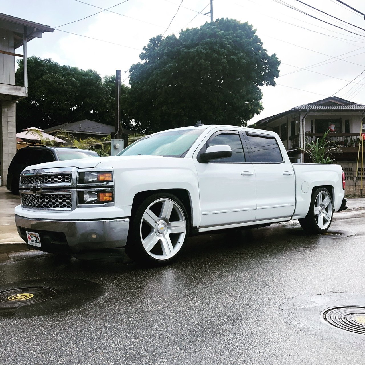

  8. Front- Replaced stock arms with Moog arms Belltech 3” drop spindles Viking coilovers Rear- Maxtrac flip kit and shock extender kit Also put smaller bumpstops Everything rides smooth now that I have the Viking coilovers. I used to have belltech street performance struts in front. They would bottom out. With the Viking coilovers I haven’t bottomed out yet and I don’t have to slow down on dips on the freeway lol.

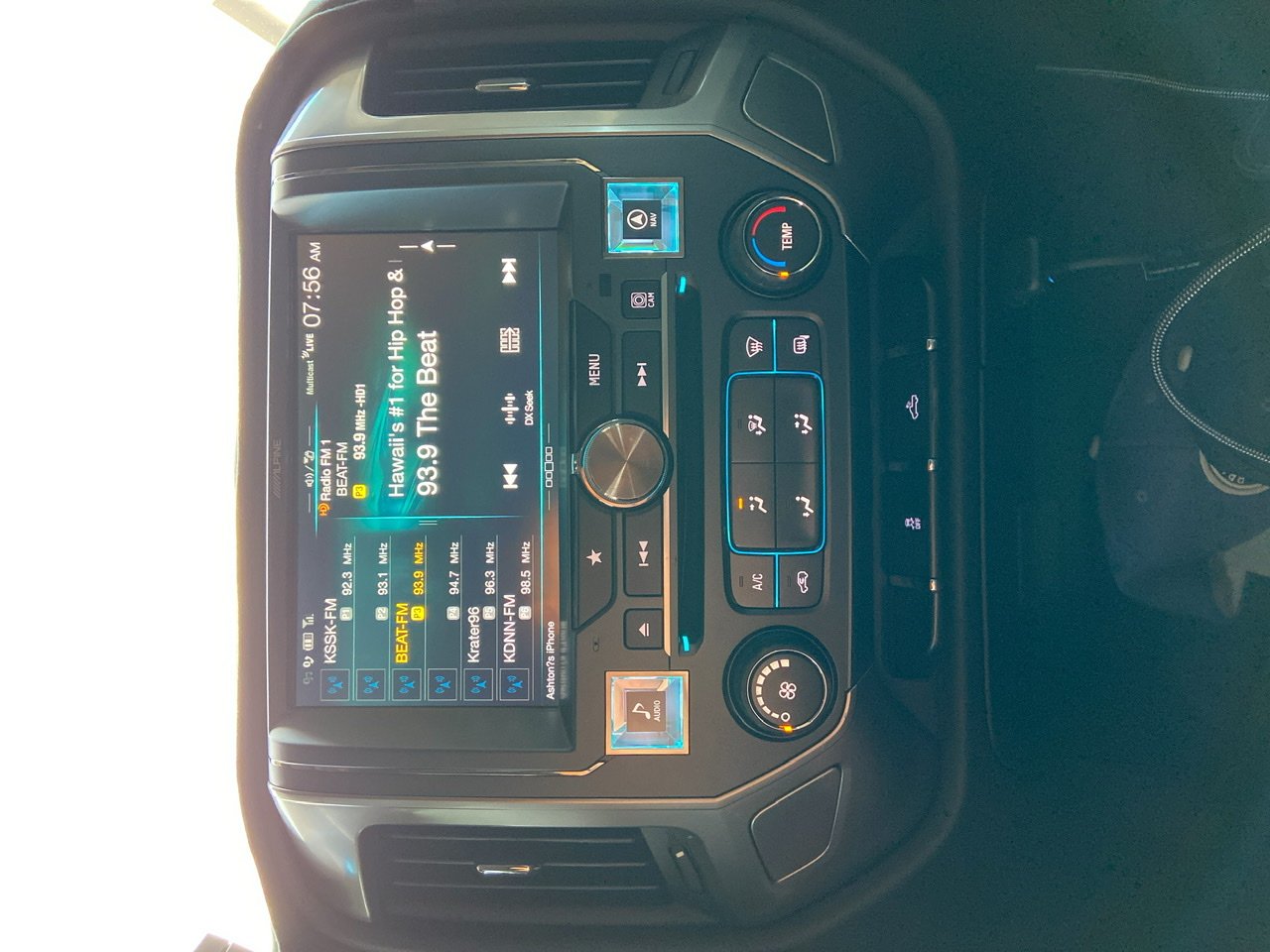

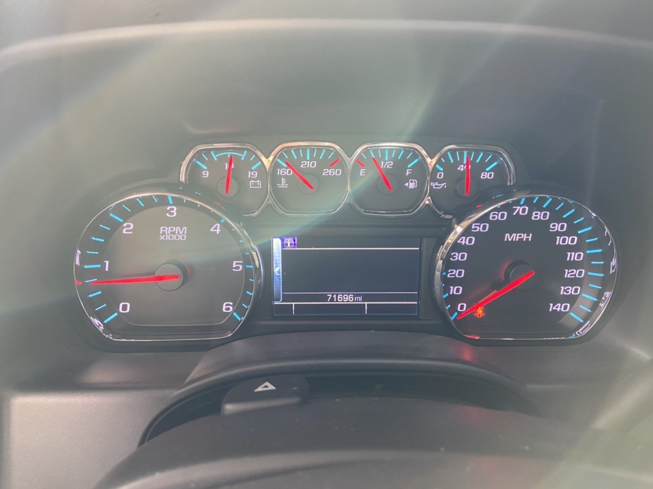

  9. No it’s not. But I got it for $850. It worked fine in the previous owners truck but for some reason I’m losing the cluster screen info. Even called Alpine and the tech said you may or may not lose that screen, it didn’t sound like he had firm knowledge on it. Maybe I need to try a different audio shop for installation.
  10. Just had a shop install my Alpine x110-SLV and now the screen in my dash no longer displays any diagnostics like the tpms, gas, oil, speed, etc. I know it displays some of it on the alpine screen itself but from what I’ve seen on other ppls installs, is they still have info on their cluster screen. The cluster screen only shows the “info” icon and drop down menu. But that’s as far as it goes. The only plug I’m missing at the moment is the camera input rca which is why I have no backup camera right now. But I can’t see why that would cause me to lose my cluster screen info.

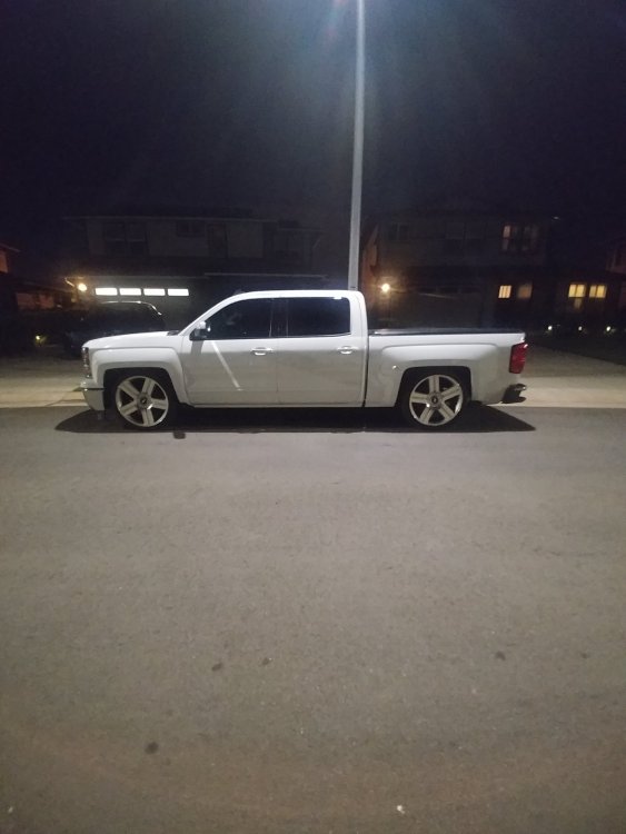

  11. Yea I hope the Vikings are good.. Thanks that makes me feel better lol. What size drop are most of those Viking customers running? Right now my truck is pretty slammed, I have drop arms and belltech drop struts in front and maxtrac flip kit in back with belltech shocks. I think I'm at 5 6 or 5 7 and I have 24s. Of course the ride sucks right now, will the Vikings make any difference with such little space between the tires and fenders?
