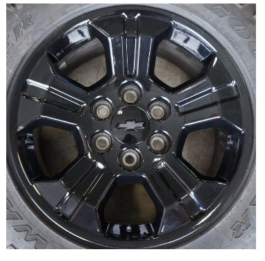

  3. Hey guys, I have been looking around and somehow have NOT found a clear answer one way or the other if the 2019+ brake upgrade will fit behind the 18" Midnight Edition wheels. These wheels; Also wondering if they are going to fit behind my winter wheels, which I believe are identical wheels except silver. Not sure how I haven't been able to find the answer for atleast these ones. It seems like they had to come on like half of all Silverado's produced from 14-18 lol... (those black ones came on my LTZ Midnight edition, but I got the silver ones super cheap so I put them on for winter). If they don't fit, has anybody fit them by machining the bump off of those calipers? I don't mind doing that. And I would prefer to do that rather than run spacers. I am going to pull the black ones off soon and try to get a solid answer myself based on the dimensions that @AlljackedupZ71 posted in this thread (thanks for those BTW); If I could find somebody who is running them though I would feel much more confident ordering the parts (I need front rotors anyways).
