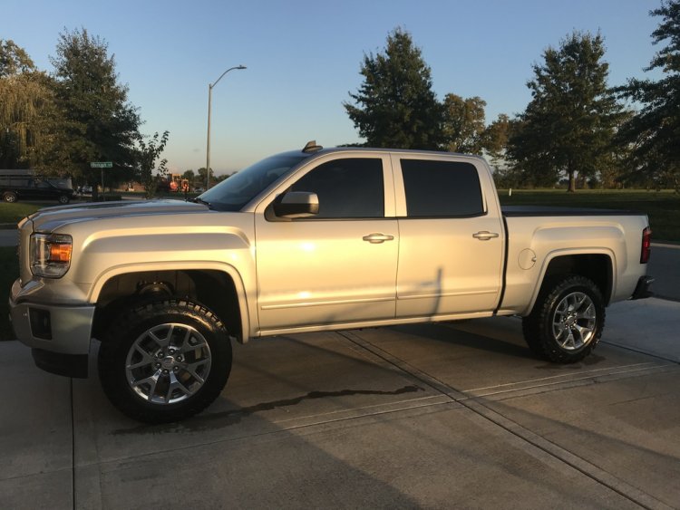

  1. I put a motofab lift on my 2015 GMC sierra 3 inch up front 2 inch the back. I was having no problems and I had a 275/55/R20 tire on for a month before I got new tires like I said with no problems, this was with the lift on. I got 275/64/R20 ko2's put on and the first turn on to the highway the traction control goes off but as soon as I straighten out it was fine. I've put new wheel sensors on the back today but didn't help and waiting for the fronts to arrive tomorrow. It only happen when turning sharp or aggressive. I have called around to shops and most say they have never heard of this issue and some say you need to get the ECU for the sensors calibrated. I have a buddy that has a 2 inch level kit on a 2014 silverado but 275/60/R20 ko2's and he is not having this problem.
