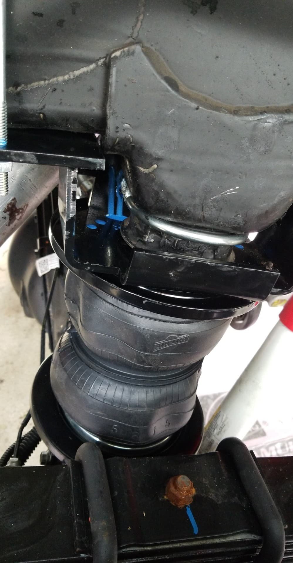

  4. That's what i'm going to do, I heard these rancho shocks are pretty much junk. I did put the air lift on today and it looks good. I'm pulling a 37ft bumper pull camper that weighs 8500# dry, which I failed to mention. I bounced to kingdom come on those Alabama interstate 10 bridges and was concerned. I still think the springs look bent upward in the center which is not normal in my book. I will schedule to have a tech look at it and let you guys know what the diagnosis is. Oh and the tires it came with are the Firestone Transforce AT with the 17 inch wheel. I got nice aftermarket wheels and toyo tires of the same size.

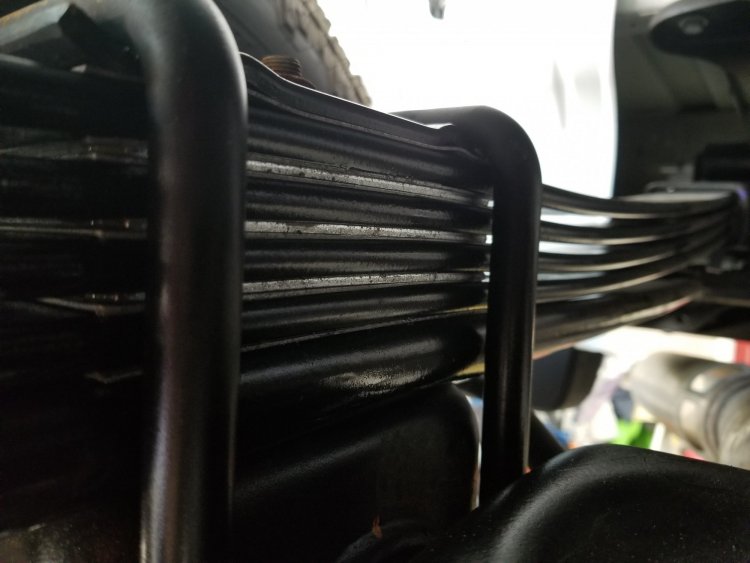

  5. I noticed this from when I first purchased the truck and was told it was the tires and it would go away with first 1000 miles. Well i'm 3600 miles in and its still just as bad as the first day. When changing lanes or passing someone it feels like the trucks rear end is catching up to the front with a side to side boat feeling. I crawled under the truck and noticed that there is a front sway bar but no rear sway control. Would this be the problem, or is it just possible that it is the tires. I ran lower pressure and higher pressure on the tires and it is the same either way. I also put a new set of the Toyo A/T's and the issue persists. I do plan on the airlift 7500 on today in hopes it will help some. Does anyone else know what the issue is? Greatly appreciate any help! Update. I found it was impossible to get the air bags installed in between so I inspected the leaf springs and this is what I found. Do they look bent to any of you or is this normal? Possible defect of springs?
