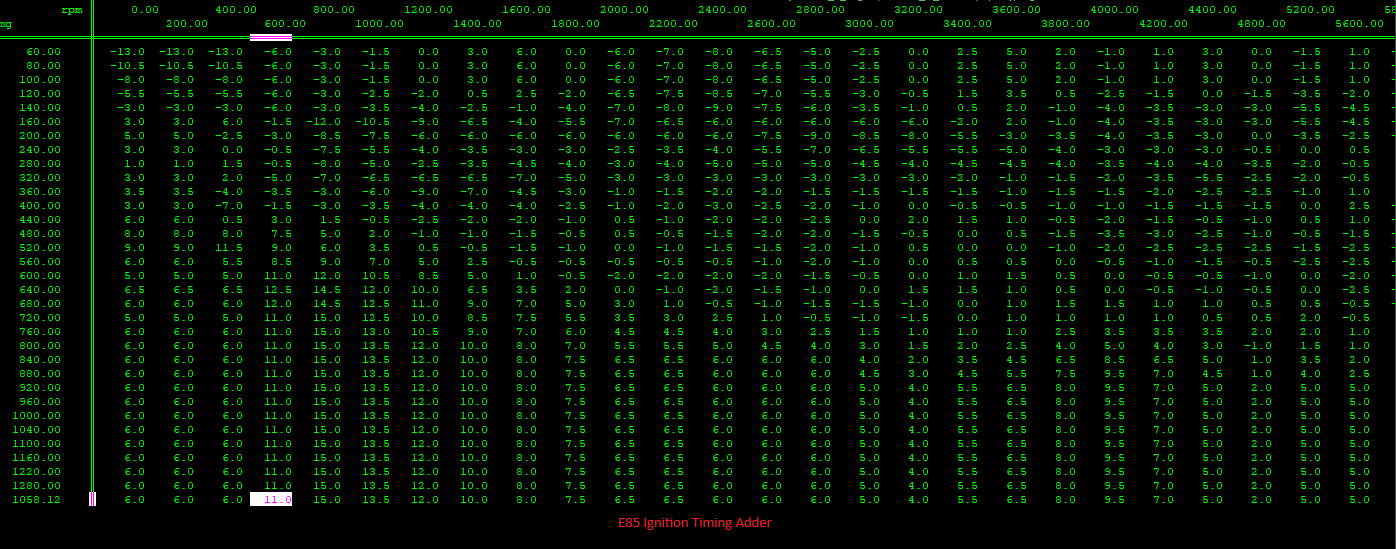

  1. What are you using to log the truck? Have you look into getting HP Tuners MPVI4? These ECU's have a ignition timing map and modifier specifically for ethanol content. The ECM (E92) uses cylinder airmass (load) x RPM to add ignition timing based on ethanol content percentage which is multiplier map 0.00-4.00 to control where it adds timing and how much it adds based on those variables. I have been doing a ton of R&D for my calibration company on the LT DI engines and these ECMs specifically. Getting fuel trims dialed in closer for the VVE and MAF calibration tables helps quite a bit in the response and drivability. There is quite a bit left on the table for sure. The pictures are screenshots of an example of 2 of the ignition timing maps. It is much more complex than these two maps but this post would be a couple miles long explaining the whole ignition timing logic and other systems that play a role into this. The first map think of it as the base timing map. The second picture E85 Adder map gets added to the base, but scaled by a multiplier based on Ethanol % before being added.
