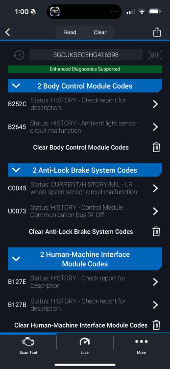

  1. I re-did the frame grounds, reset the system and then plugged in the new code reader. This is what it’s telling me.
  2. Excellent suggestion, and quite logical. I’ll see if I can snag myself one.
  3. So I’ve gone through the normal process of trying to identify my issues here: grounds look OK (I cleaned them and re attached the frame grounds, the under dash ground looks fine and it well attached), I changed out all the wheel speed/abs sensors, and have tried to read the code to see what else could be wrong but my code reader won’t pick up the stabillitrack light or the park sensor. Should I change the negative battery cable next? Maybe swap out the BCM? I can also change out the wheel hubs but they look and function fine. What else am I missing?
