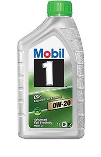

  16. Hello, Getting close to 2nd oil change on my 2020 Sierra 3.0L Duramax. To make certain I purchase the correct oil, I've included a link below. The best I can determine its the Mobil 1 ESP X2 0W-20 which has the DexosD rating. Other than the AC Delco DexosD, can others confirm that this is the correct oil for the 3.0 L Duramax? It appears at this point the local auto parts stores do not stock the Mobil 1 ESP OW-20 as of yet. The link below gives the product description. Thanks - J Tab www.mobil.com/en/lubricants/for-personal-vehicles/our-products/products/mobil-1-esp-x2-0w-20/
