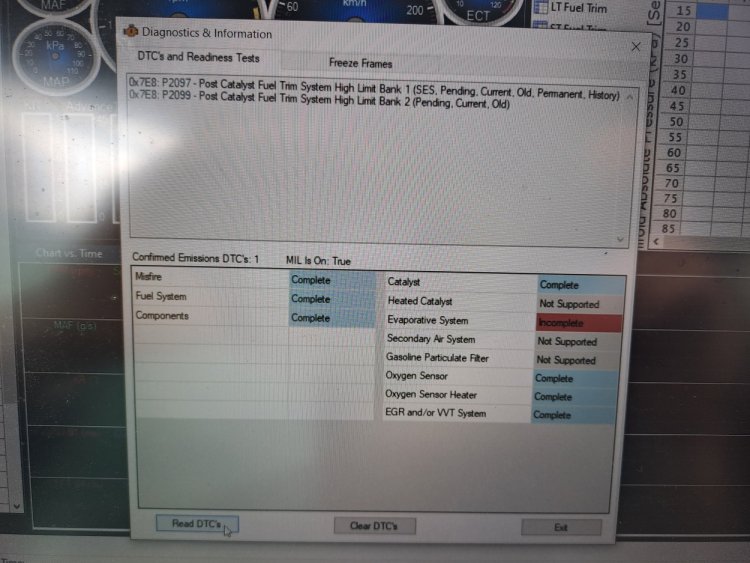

  6. According to my dianostic check the troublecodes are p2097 and p2099. The last time after I reset the dtc only a p2097 popped up. As you can see in the last picture of the freezeframe. Your dianostic aid is very helpfull but the links don't work here in holland. For example, when I click on the "fuel system diagnosis" , I get a no access message on my computer. It's like the website is blocked off. Or maybe it's only for people in the US? I don’t know. Is there perhaps a different way to check the fuel and injector system? Maybe a different link? Thanks for the great input by the way.
