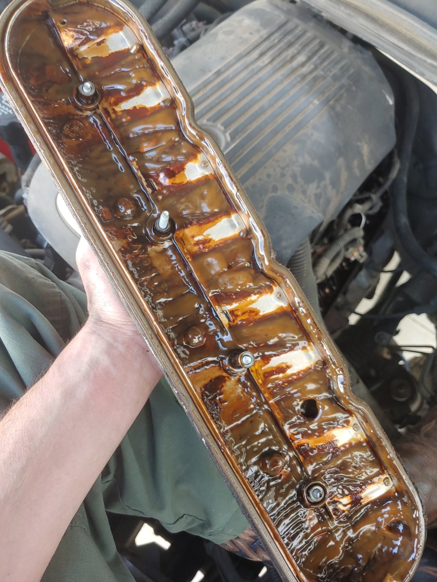

  1. Thanks is there anything I need to do with all the goo inside the valve covers other than just clean them out?
  2. This is what I found after removing the valve covers. So the heads are cracked correct? Are there any other issues that could cause this?
