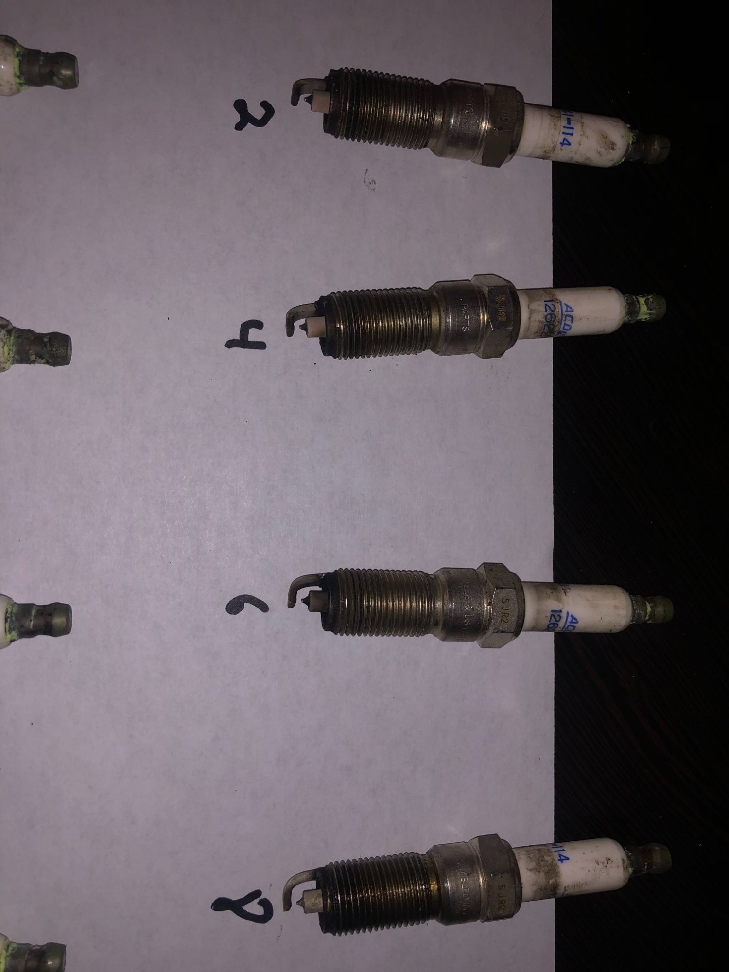

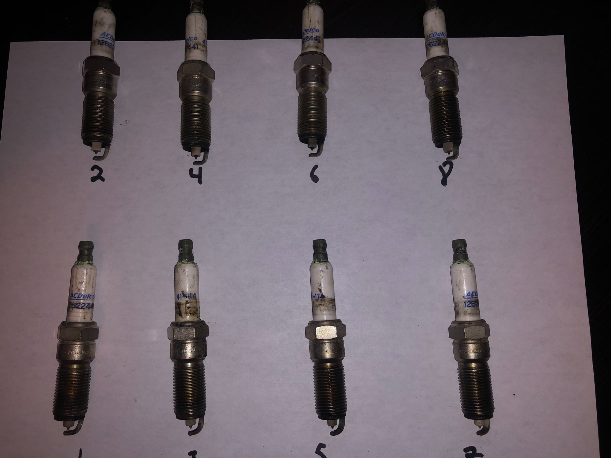

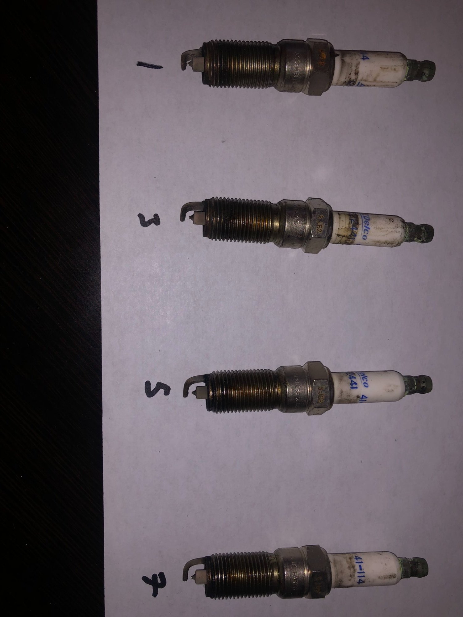

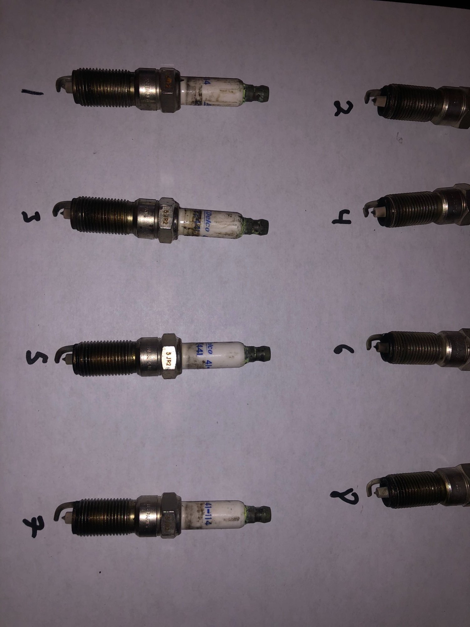

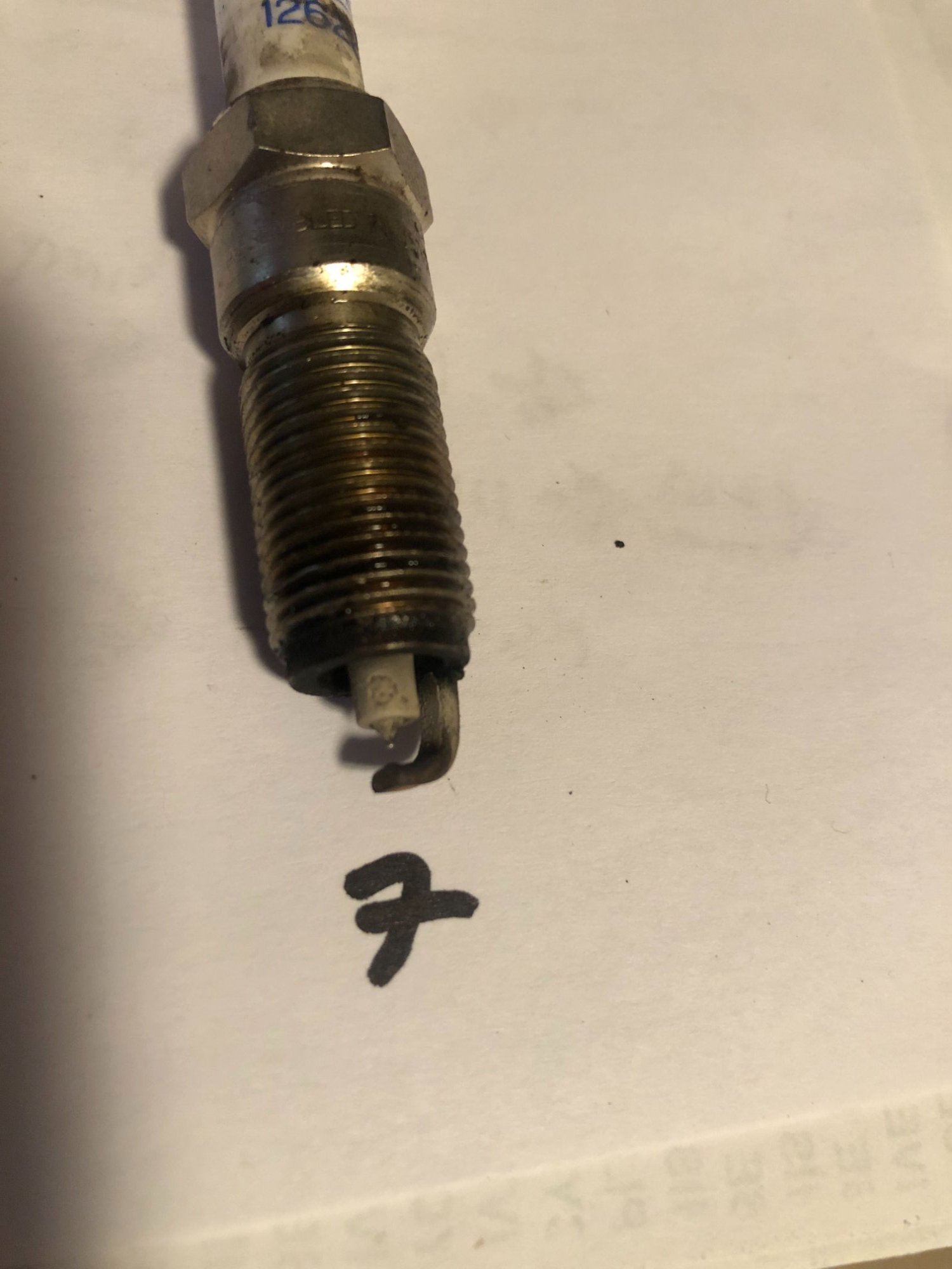

  2. I got the truck back last night, haven't had a chance to drive it much yet but it does feel smoother overall. Need to drive it more to see how it behaves. What I see on the plugs is the gaps are all over the place...especially Cylinder 1 is way different gap wise than the rest. Cylinders 7 and 8 have a spot with buildup or defect on the porcelain. Cylinder 6 porcelain is darker than the rest. At least half of the plugs appear to be a little wet on the threads...I brought this up to the techs but they didn't seem to think it was out of the ordinary. The plugs don't look fouled to me but with the inconsistencies in gap, porcelain defects/buildup on 7/8 etc... I wouldn't be completely surprised if a couple of them were causing misses. Here are the plugs (I have to do a few pics at a time so next post will include the remaining two pictures): Cylinder 7 porcelain blemish:
