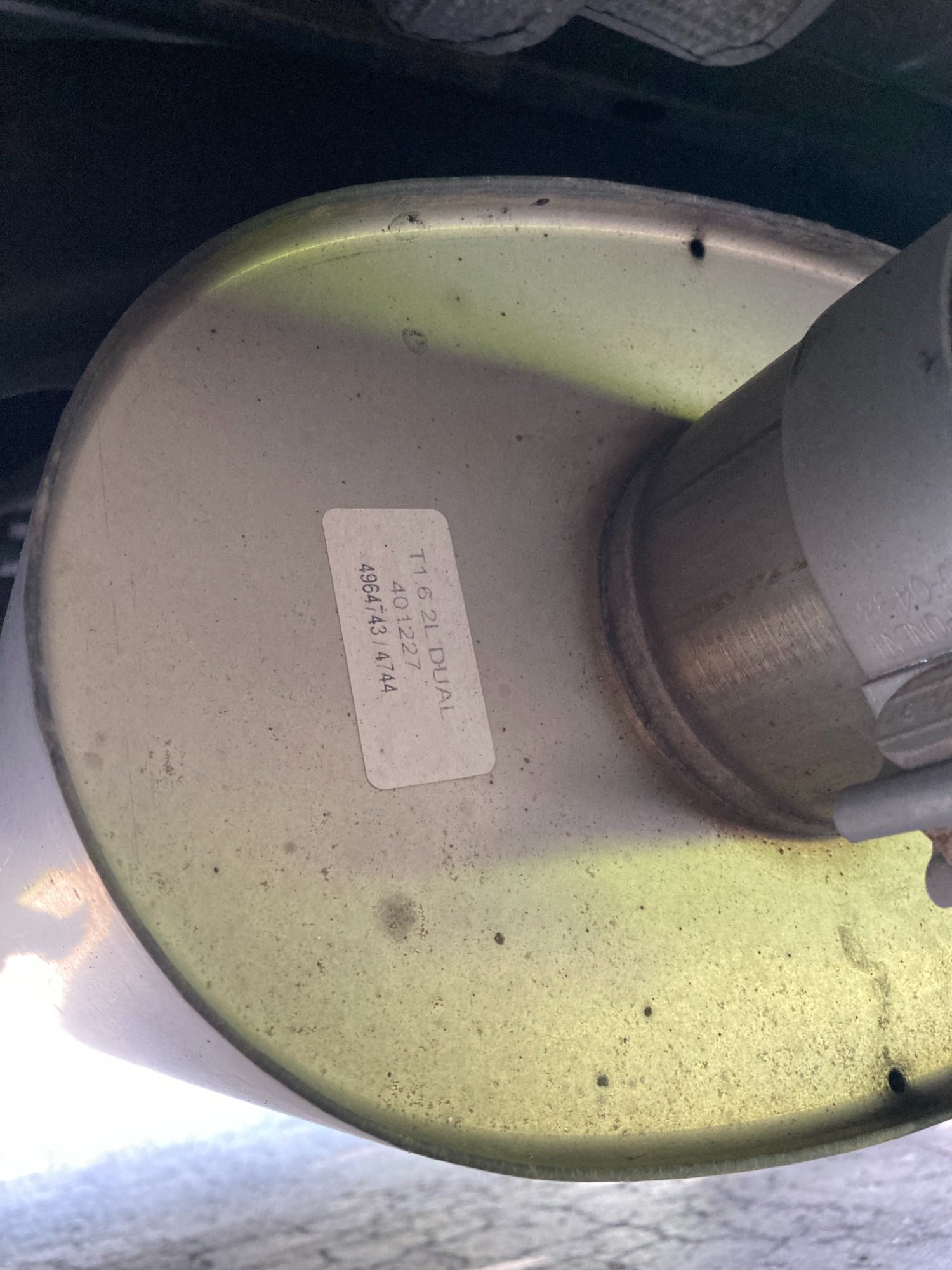

  2. Thanks for the update - And pardon my ignorance, but what is L9?
