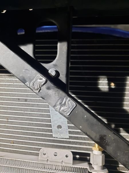

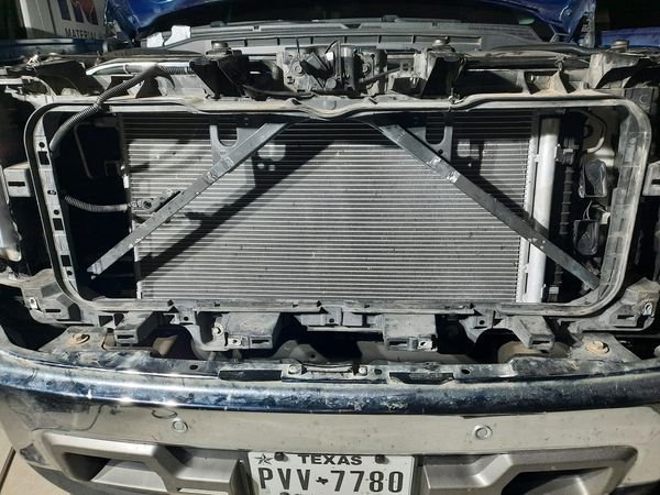

Had to cut away some plastic and a little bit of the radiator core support for the intercooler fitment. Made some brackets and bolted her down. -

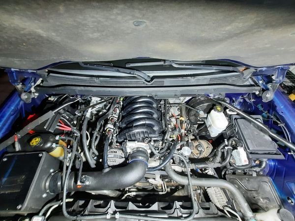

Just an updated pic with the exhaust removed. ** There's something hiding under there behind the axle ** -

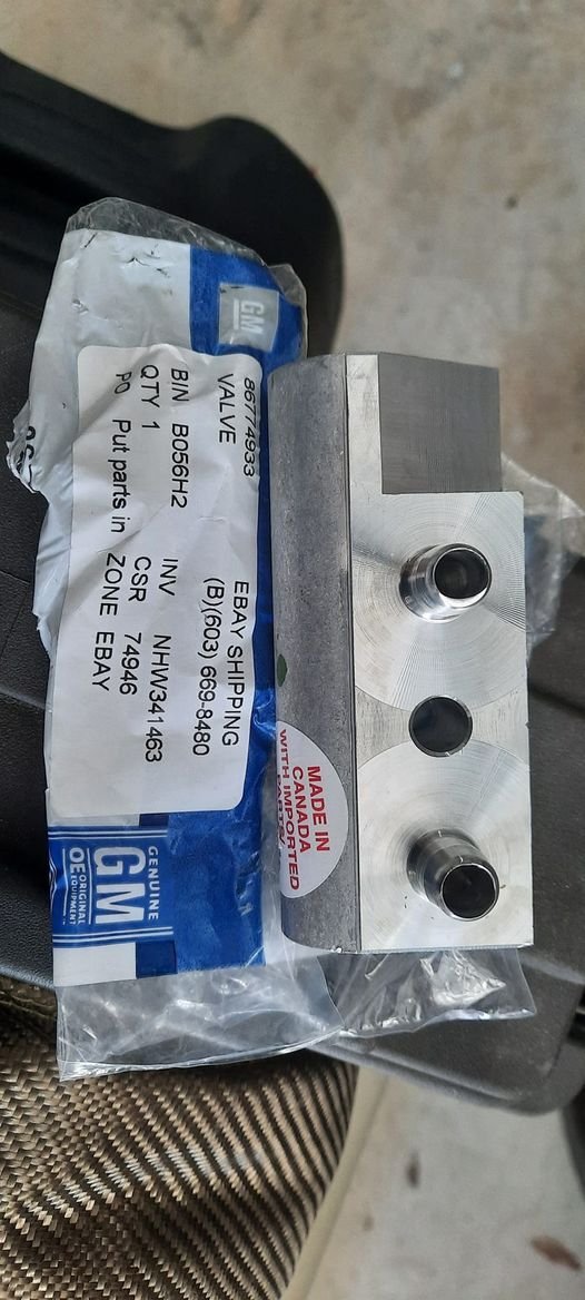

If you have a 6L80E transmission, this is a mandatory updated replacement part. This is the lower temperature thermostat for the transmission cooler lines. -

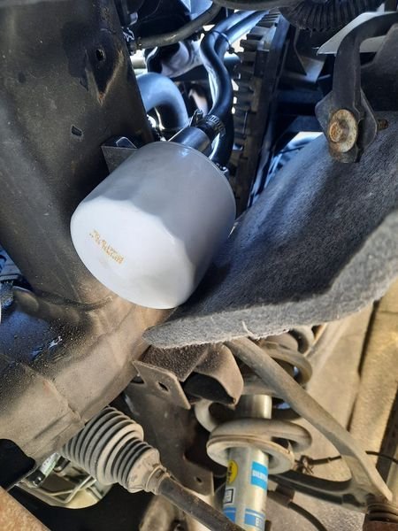

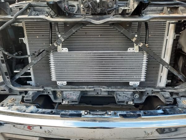

Added a 40k cooler in front of the condenser and a remote transmission filter. The factory routing sequence: Transmission. Radiator. Condensor/Aux. Transmission. My sequence is: Transmission, Remote filter, Radiator, Condensor/Aux, 40k cooler, Transmission. * The last 2 pictures are showing where the condensor and aux coolers are divided. -

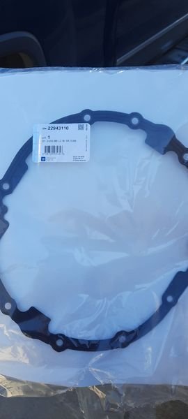

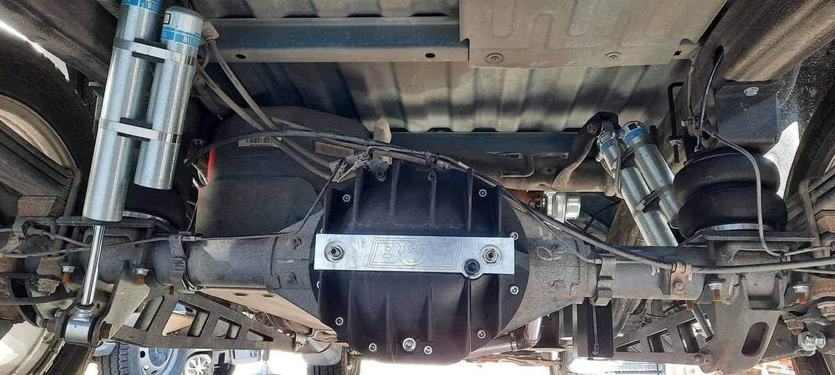

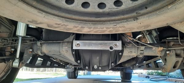

B&M differential cover installed. I needed to drain and refill so I figured why not change the cover out? Even though the original seal is reusable, I went ahead and replaced it due to the age. -

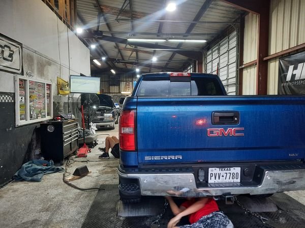

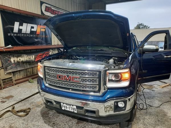

Dyno Day! I couldn't get real numbers because of the factory driveshaft was still installed at the time... so I could only Rev it out to 5400 in 3rd gear. Even with that, it still made decent power. Gained about 40whp just for going from 87 to E85. Gained about 105whp with all mods and full stock exhaust/manifolds, prior to turbo. -

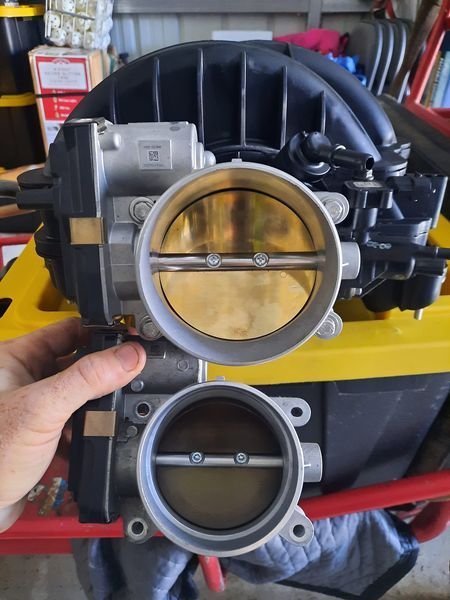

Installed: L86 Ported Intake Manifold LT5 Throttle Body No other parts needed for install. The throttle body mounting holes have to be honed out to align with manifold and the inlet of the manifold needs to be ported. -

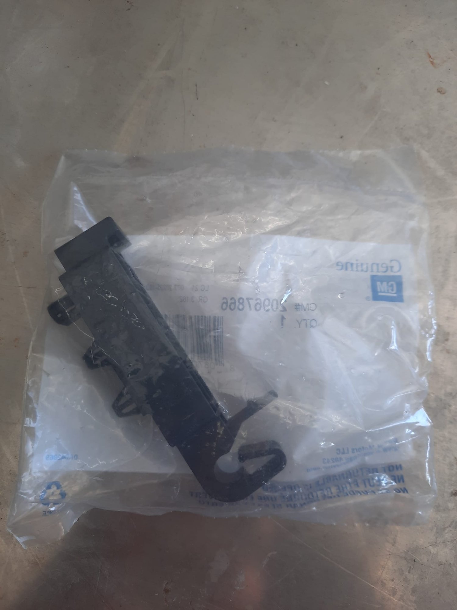

Cut the fuel line and installed the sensor in it's original location next to the plug with the OEM clamp -
