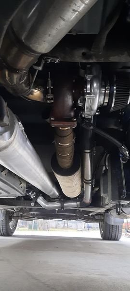

  2. My exhaust after the turbo is an inch bigger than the turbo outlet and it's only about 6' long. I am using a Magnaflow straight through 4" In & Out. The turbo wasn't small if I wanted to keep it under 4500 RPM's. It's the smallest turbo that I would recommend for a 5.3. The exhaust side was choking it. Now the truck is a different animal but I'm still keeping the boost around 6 PSI to keep it at 500 WHP to keep my trans from slipping.

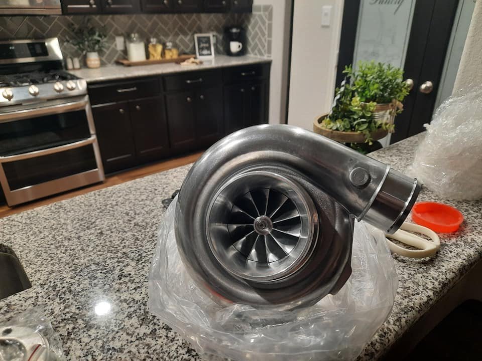

  6. With the VS Racing Billet 75/65 turbo, it made 505 WHP at only 7 PSI. The graph showed how restrictive the turbo was in the higher RPM's due to the smaller turbine so I swapped the turbo out for a On3 Billet 78/75. I plan on putting the truck on the dyno again this weekend.

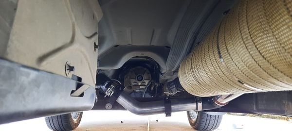

  7. Turbo setup is done for the most part... few things in the tune need dialed in. Completed the 4" stainless exhaust with 2 mufflers and 1 resonator, all coming to a 5" tip. I wanted her quiet and it surprised me how quiet it is!

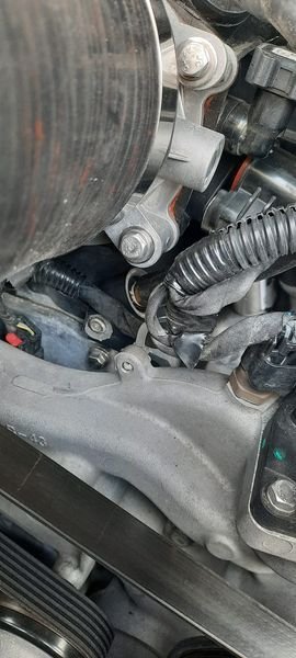

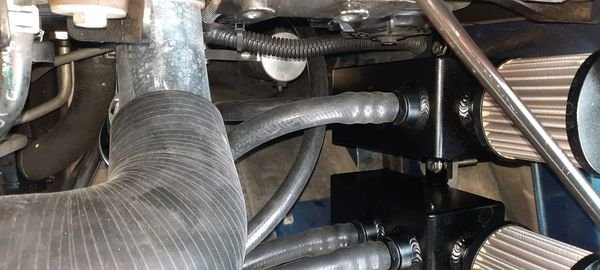

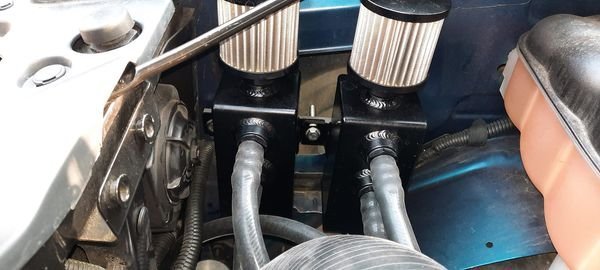

  8. 2 Breather tanks and 1 catch can setup. May seem overkill but it beats not being good enough! 1/2" hose to each valve cover. 1/2" hose to 2019+ oil fill tube w/ an10 180 fitting. 3/8" hose to gutted PCV valve tapped with a 1/4" npt 1/2" barb.

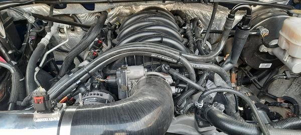

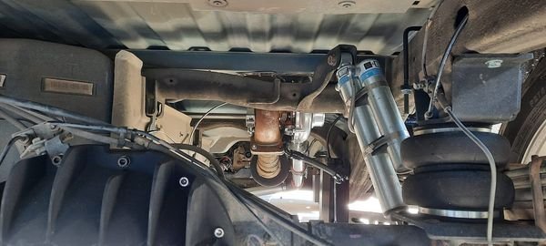

  9. Fitment of the 4" piping was pretty tight but the spare tire still fits just like factory. I kept the drain simple by making it gravity like any front mount turbo. Can't go wrong there. No need for check valves or 2 pumps.

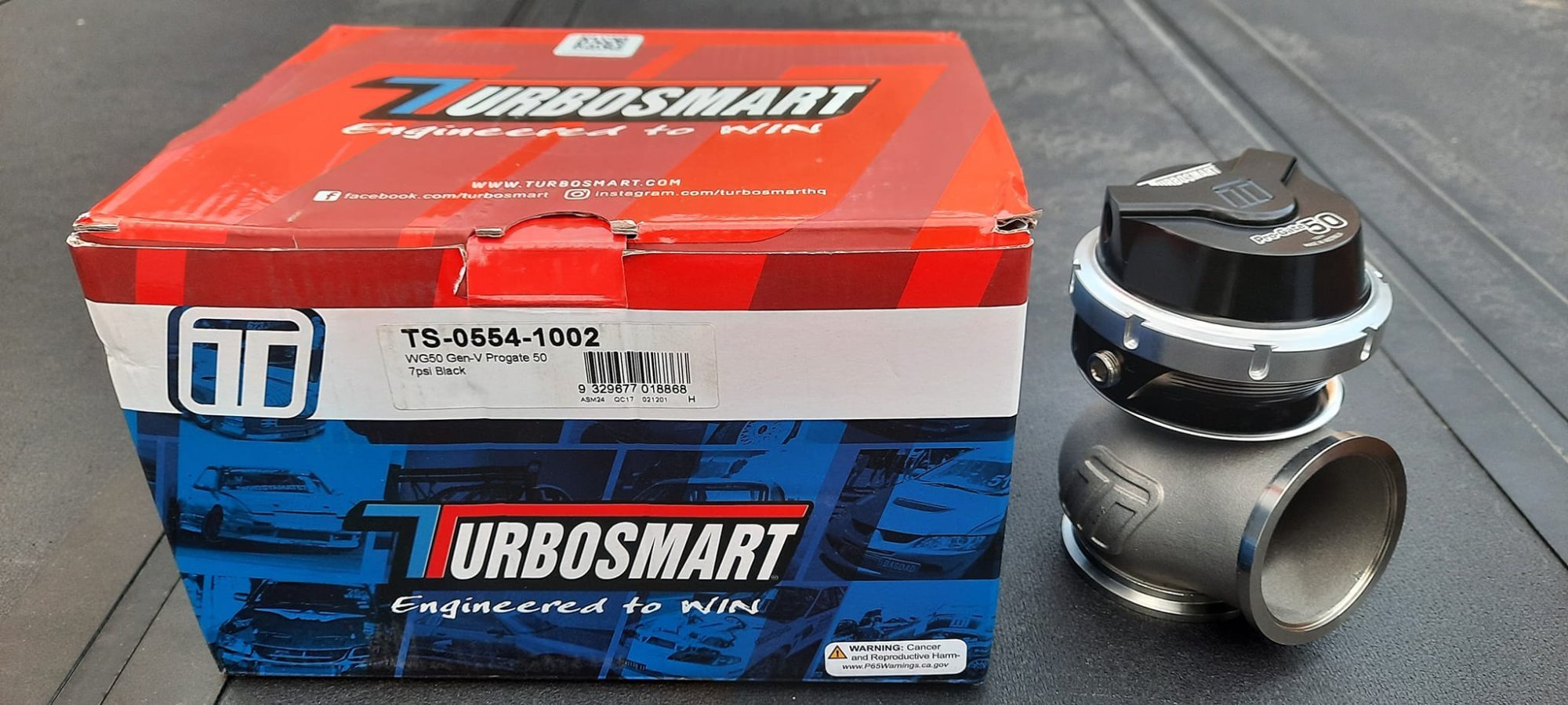

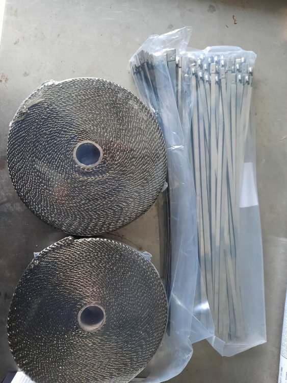

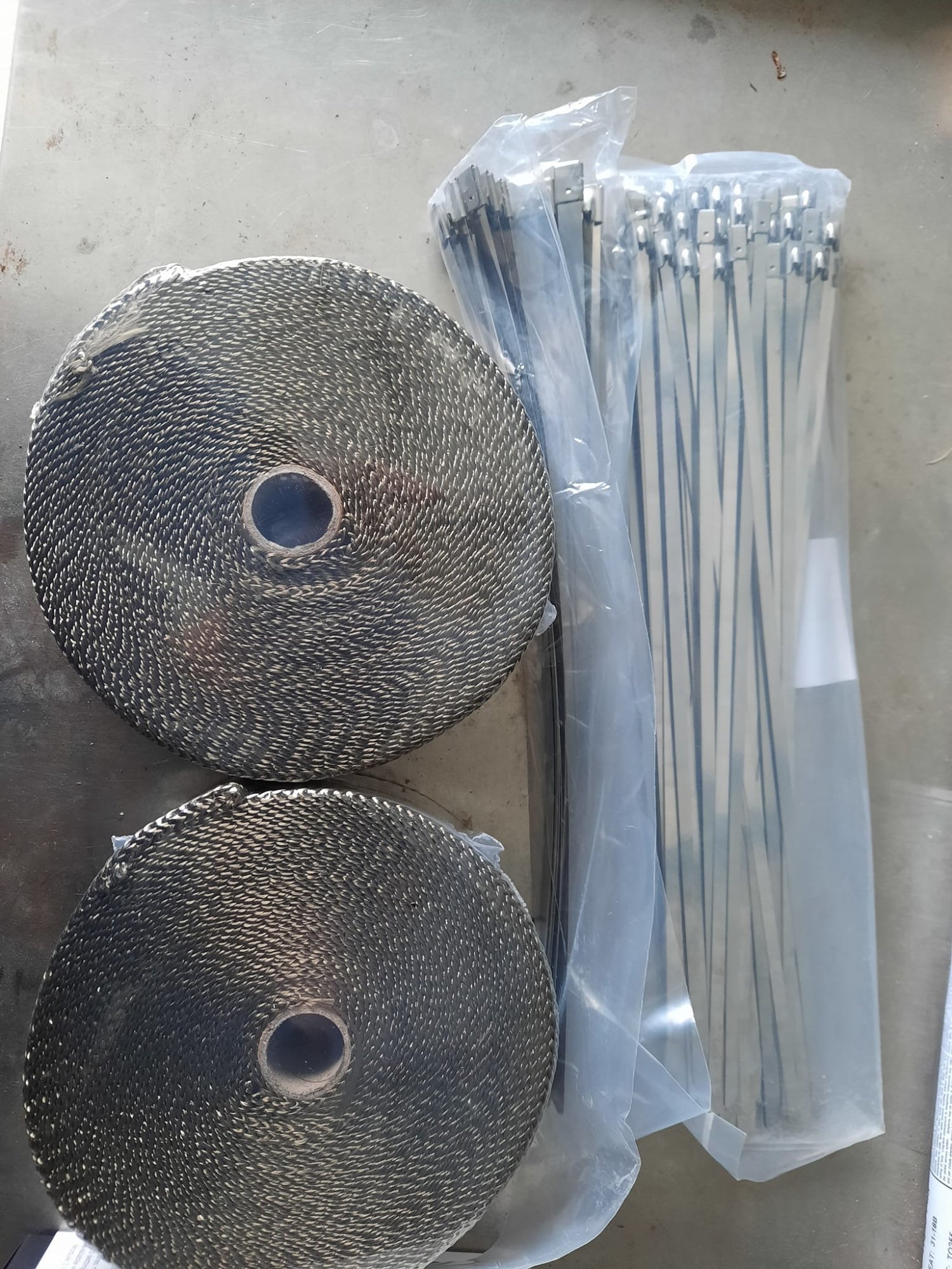

  10. Just about done with turbo. My divorced oiling system is complete, purged and tested with constant 40 psi. Ran out of titanium wrap and had a extra spool of fiberglass wrap for the muffler. Figured why not.. Now I just have to coat it all with the black silicone coating once it dries to help protect it. I just have a couple more welds to finish the other half of my 4" piping from the turbo back to the 5" tip and pipe my wategate back into the exhaust after the turbo. Then weld my MAF & wideband bungs. Then back to the dyno.

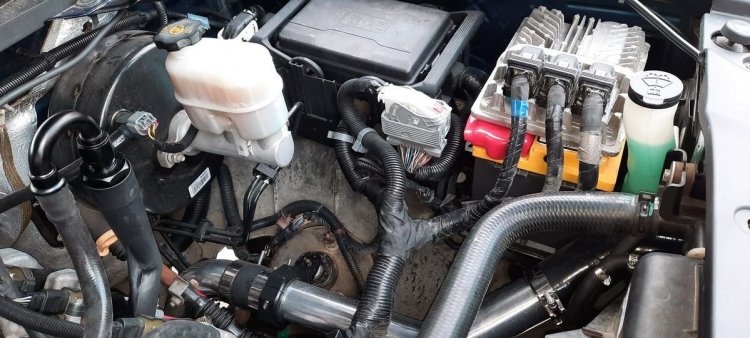

  11. Relocated ECU onto secondary battery to allow room for intercooler piping to the turbo.

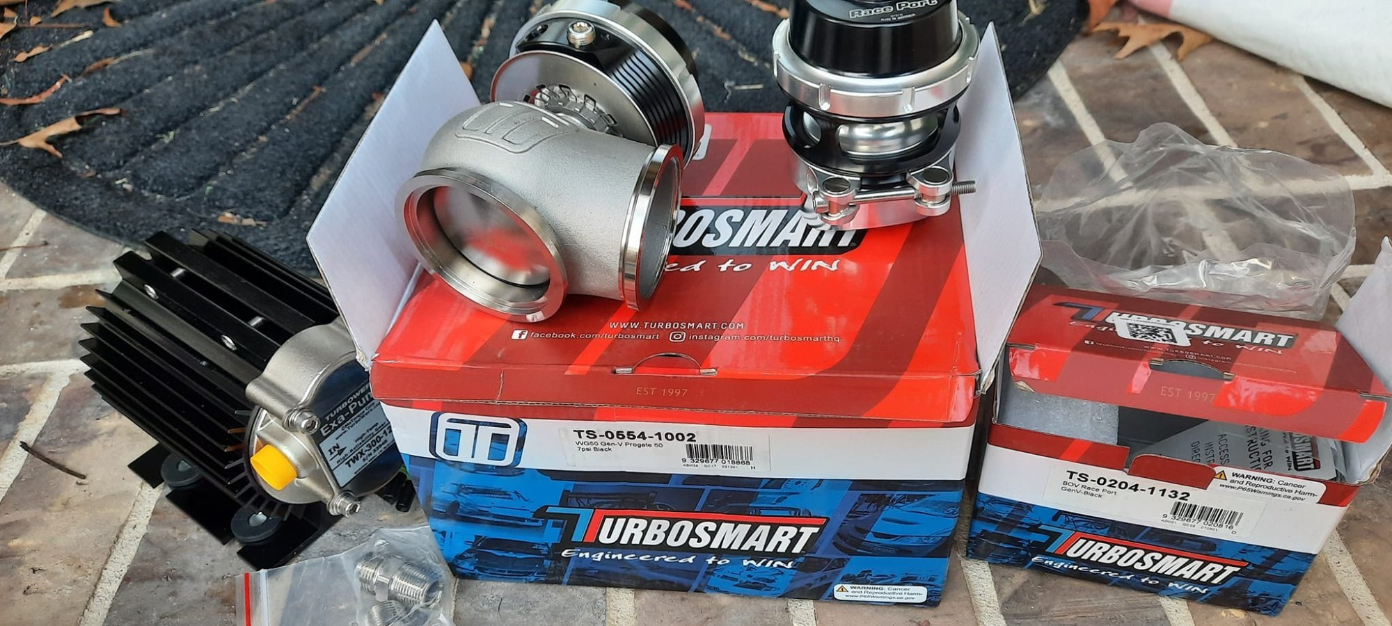

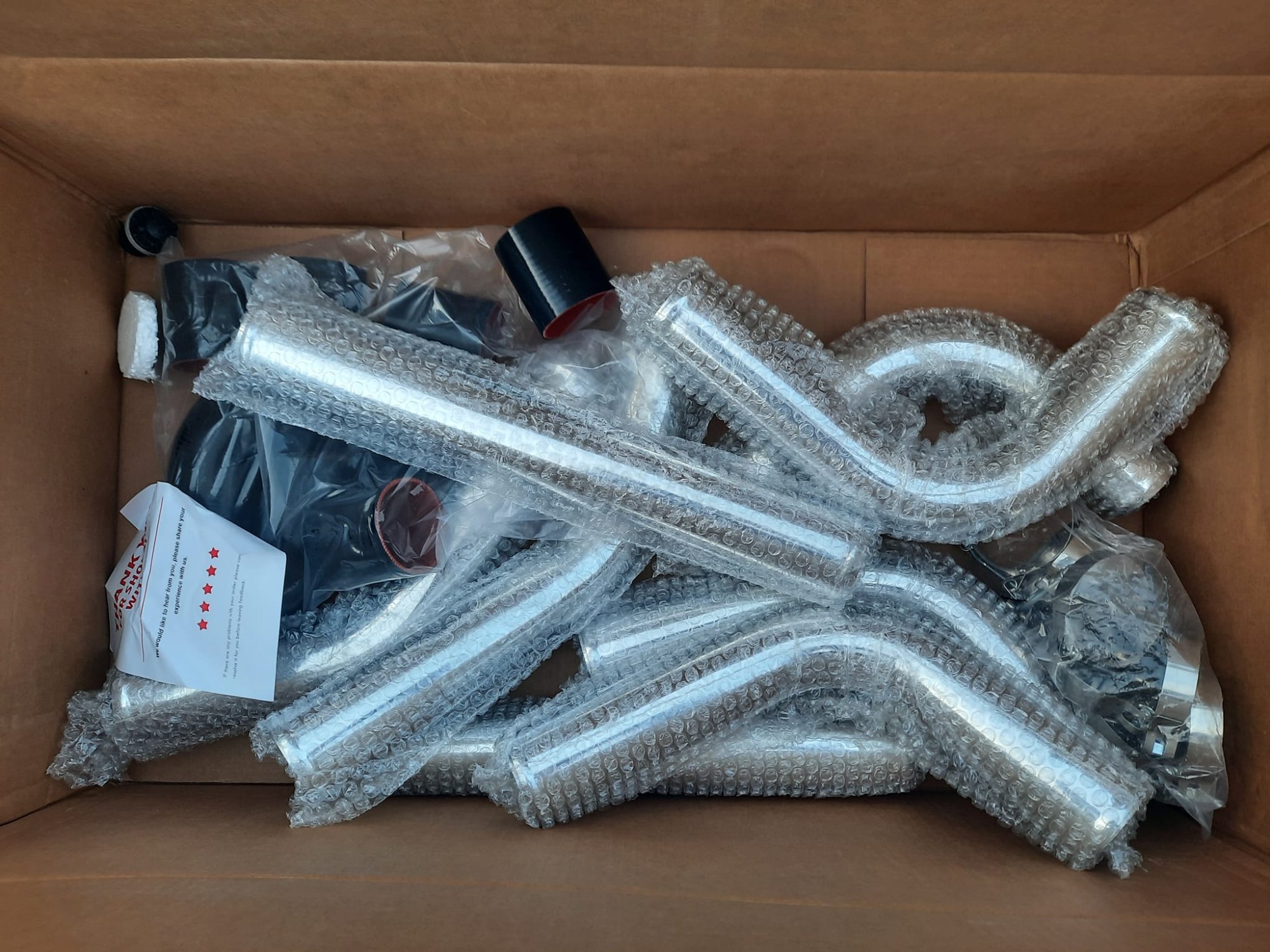

  13. Onto the turbo portion. Here's where it gets really fun... Many hate on rear mounted turbos but hey to each their own. I prefer to have the heat out of the engine bay and no clutter in case I need to work on something. A few random parts.

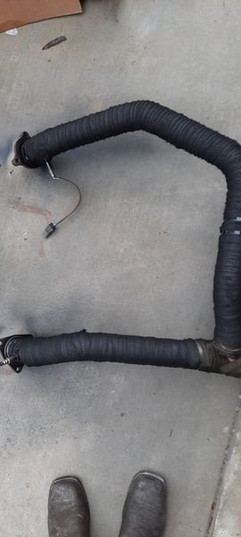

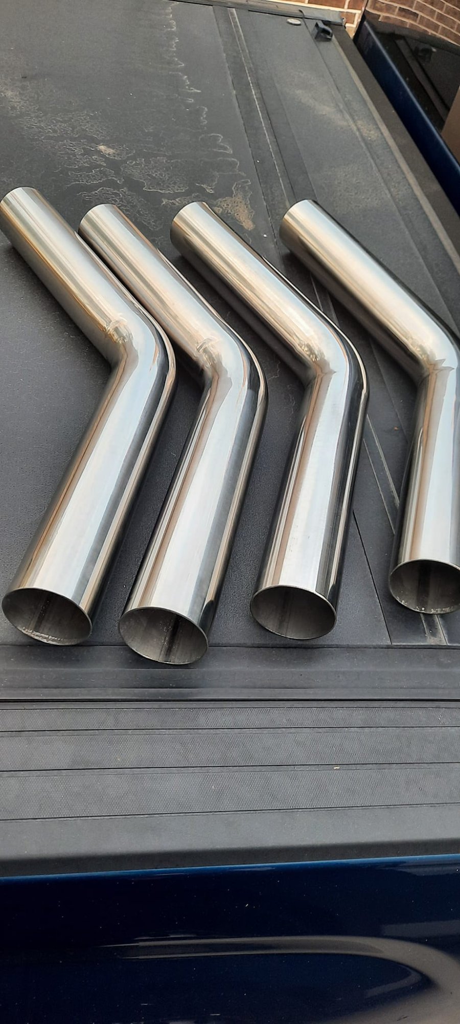

  14. Made the Y pipe from stainless steel 45 degree mandrel bends. Heavily titanium wrapped and coated to retain the heat.
