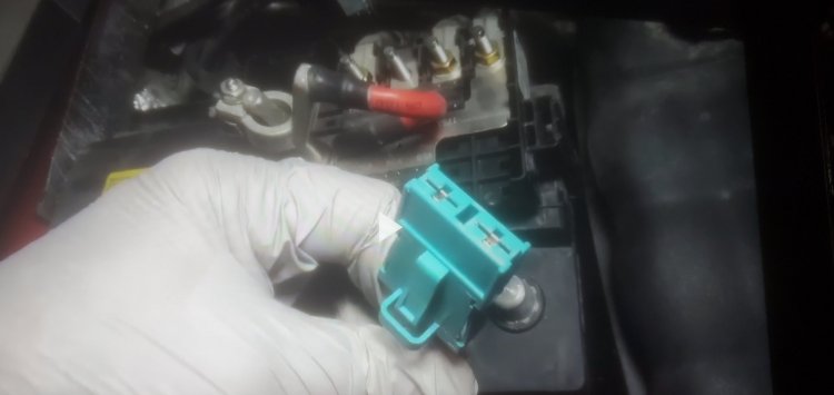

    2017 Chevy Silverado 1500 LTZ Z85

  1. Hey thanks for finding those guys! I went with GMpartsstore.com. Price was $37.92 and had the fastest shipping from what I saw. 6 to 8 days out with expedited, ordered from them before and they delivered 2 days early so hopefully they repeat that. And again, Newdude is the man! Seriously awesome and still grateful lol.
  2. I couldn't agree more! Newdude is the man for sure. I am blown away not only did he show the exact part I need but included the part number as well. I spent hours searching "2017 chevy fuse block connectors" "GM Connectors" "Fuse block connectors" etc. But I just could not find anything that would work! Seriously props to him 100%
  3. Wow! I spent hours searching and I just couldn't find it! Thank you so much!
