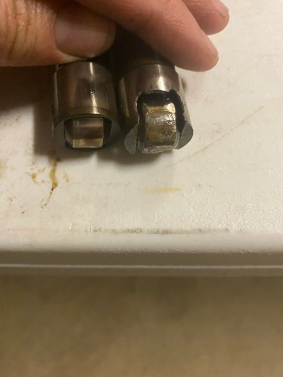

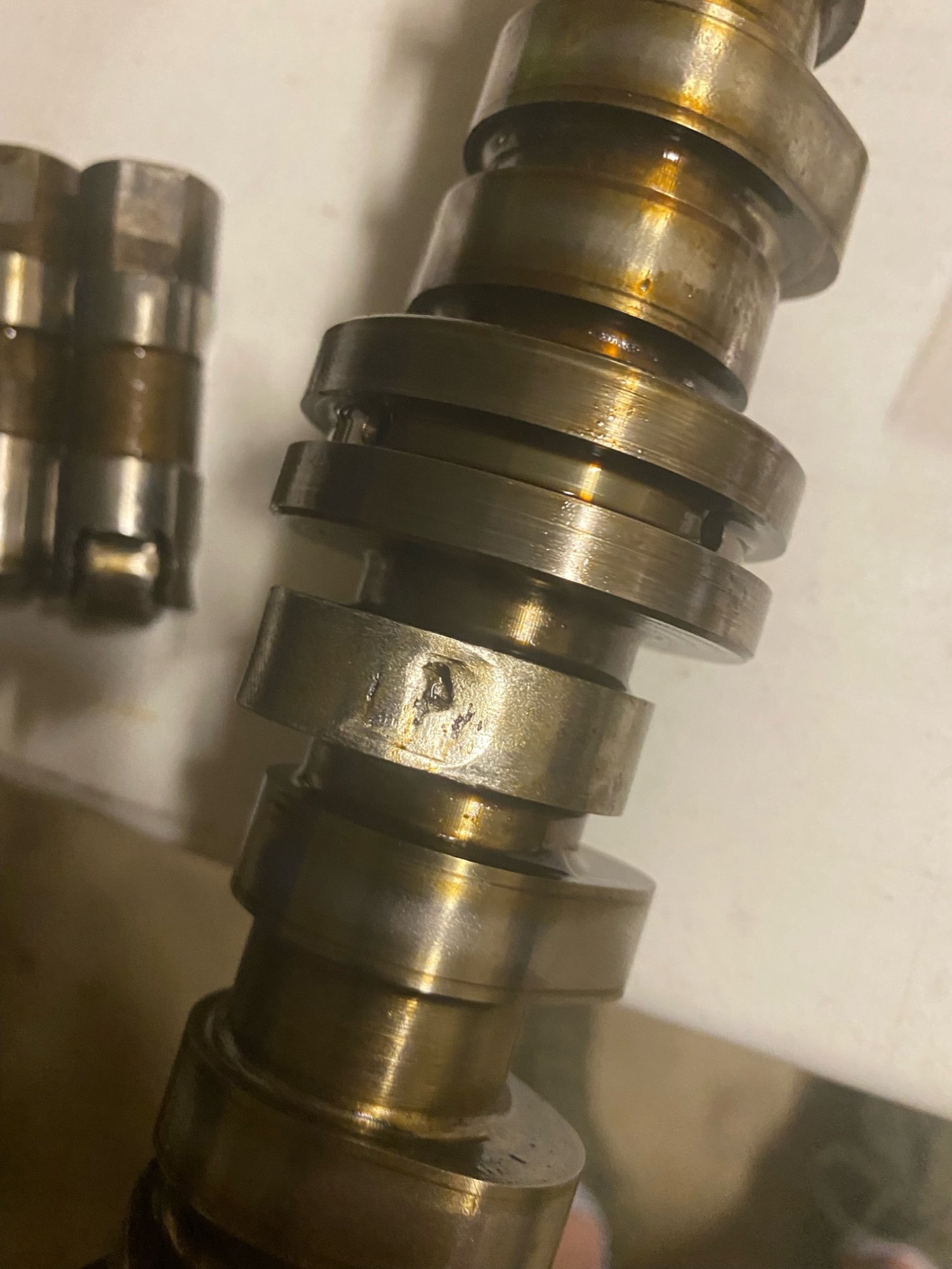

  3. First of all, I owe you guys. Had a ticking noise, and through this forum guessed that it was likely a collapsed AFM lifter. After getting $4k-$6k quotes to repair, watching a LOT of YouTube, and reading on this forum, I decided that if I was going to spend that kind of money I’d rather delete the AFM altogether. So, DIY, here I came. I think I made the right call. Imagine my surprise when I opened it up and did NOT find a collapsed AFM lifter. Instead, I found a stuck roller lifter in Cylinder 3. Wouldn’t pull out, so I had to knock it back into the block and fish it out with a magnet after removing the cam. Pics are what I found. My questions - what would cause this, and what would you do after finding this? TIA!
