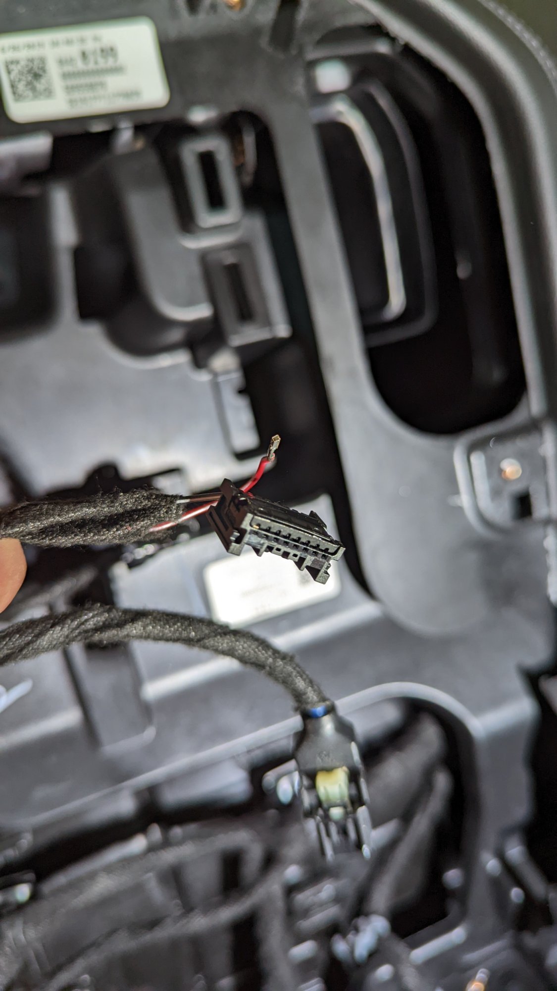

  1. Figured it out. in case anyone needs it, the wires are on the 2 outside pins. Red on the left, black on the right when your looking at the plug.
  2. Anyone have a picture of that connector from behind their infotainment screen?
  3. Hi group I didn't know where else to turn and I have searched the web for what seems looked forever. I was installing upfitter switches (which are awesome) and when taking the infotainment system out, 2 wires pulled out of the black plug. There are 2 plugs connecting to the screen. One is a black flat one that only has 2 wires (red with white stripe and black with a white stripe). Both wires pulled out of the connector. Does anyone have a picture or know what pin out they go into. Here is a picture of what I'm looking at.
