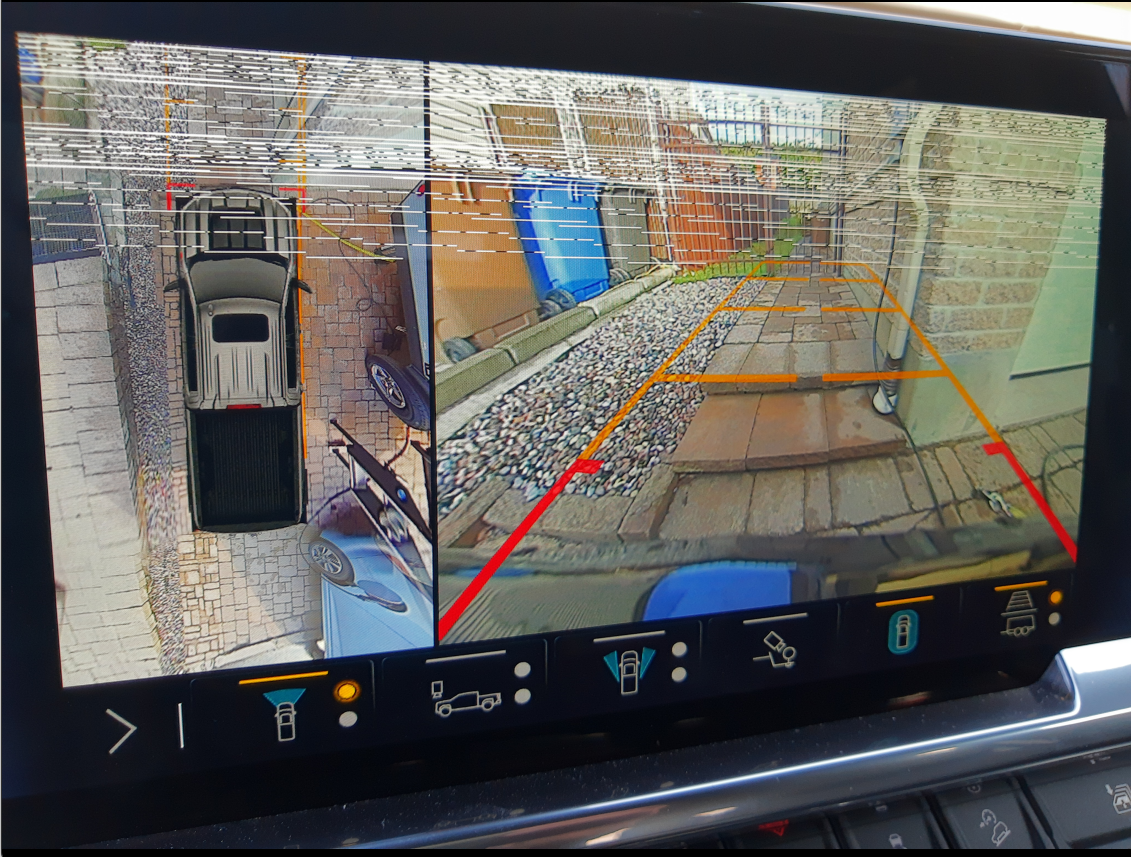

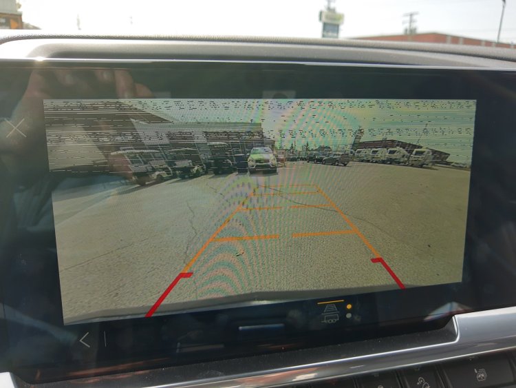

  3. Hello everyone, I have a 2022 Silverado Trail Boss Duramax 3.0L that has camera issues since I bought it in August last year. Everything works fine until I plug in a trailer. A couple of seconds after connecting a trailer to my truck, the backup camera starts showing white lines at the top of the screen and remains in this state until I unplug the trailer, stop the engine, lock the doors and wait a couple of minutes. Here is a picture and a movie demonstrating the issue: Picture and movie link: https://photos.app.goo.gl/u2JnsMvD3vdHMwMu7 I could reproduce the issue with my trailer and with two other trailers in my travel trailer dealer inventory. More than this, I can reproduce the issue only by connecting this 7-way RV blade LED adapter, without any trailer connected: https://www.curtmfg.com/part/57003 So the problem is clearly on the truck side. Somehow, the additional resistance in the electrical circuit impacts the backup camera image. In conclusion, here are the repro steps: 1. connect a trailer (or the above electrical adapter) to the truck's 7-way plug 2. start the engine 3. switch from main menu to truck's backup camera -> observe backup camera top of image becoming corrupted 4. unplug the trailer (or the above electrical adapter) -> observe backup camera top of image stays corrupted 5. turn off the engine, lock the doors and wait a couple of minutes 6. start the engine and switch from main menu to truck's backup camera (nothing is plugged in the 7-way plug) -> observe the backup camera image is cristal clear Does anybody electrical savy have an idea what could cause this issue? It is important to note that only the backup camera has the top image corrupted, the display does not present any issue in any other menu, only in the camera mode. Thank you in advance for your help!
  4. Hi gemarsh, The lights flash form time to time. I looked in manual and it looks to be indeed the truck probing the trailer is still connected as a theft deterrent measure, so this is ok. I did another test today using this electrical adapter for led lights trailers, without connecting the trailer: https://www.curtmfg.com/part/57003 The tools has integrated resistors. Five to ten seconds after plugging it in the truck's receptacle, I can reproduce the issue! If someone with electrical knowledge has an idea it would be very helpful.
  5. Hello everyone, Today I took my trailer out of storage and the brakes are working! I towed ~20km without any braking issues, so the brake controller replacement seems to have fixed this issue. On the other hand, I still have the camera issue. Every time I connect a trailer (I tested today with two different trailers), there are white lines at the top of the image. They dissapear only after disconnecting the trailer, shutting down the engine, locking the doors and waiting a couple of minutes. I attached here a fresh picture, maybe someone has an idea. I also noticed that the trailer led lights are flickering when connected to the truck with the engine off. Any help on this subject is greatly appreciated!
