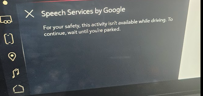

  2. I took my vehicle in for service, and provided the issue details as well as Repair Bulletin #PIT60328. Response from service tech is: "Engineering is working on a fix. No repairs to be made at this time".
  3. Update, Services by Google notification is now not every start up, I would say about 75% of the time, so intermittent. Blower speed change also now intermittent, and at times seems to fix itself without me toggling mute on off.
  4. Issued almost 3 months ago............. Not good. https://www.repairprocedures.com/bulletins/document/pit6032b/6378631.html
  5. I really want to just roll back the update. Is that possible? Can't find out how. I'd also be willing to factory reset the software if that deletes out the software updates.
  6. 2022 Sierra 1500 AT4 with Technology package. Installed the 2nd OTA update a couple weeks ago. I got 2 OTAs in about a week time. This one is GM N23-240353. Two issues that weren't previously issues. Now, upon startup of truck, I have to x out of this notification Second issue: about 5 seconds after truck is cranked, AC "pauses" as if the microphone has been activated on Android Auto. It doesn't blow normal until I either mute the radio or toggle the microphone button - then it normally starts blowing normal. Both super annoying. Anyone else seeing this and anyone have any ideas? I've totally disabled the Speech Services by Google app, didn't help. It did eliminate the pop up, but AC issue still prevalent.
