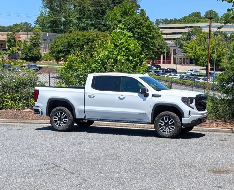

  1. I installed myself. Not any harder then other trucks I have done, except the control arm bushings were difficult to press in without having a press. The polyurethane bushings wouldn't shrink no matter how long I left them in the freezer.
  2. I installed Bilstein 6112/5160 and Bilstein control arms to give the front a 1.2" lift. I think they should have come this way stock. I get that it's a truck, but GM's off-road oriented truck probably shouldn't have the same rake as a regular truck and a little bigger tire. It's not perfectly level and I'm good with that so I can still use it as a truck. Currently have 285/65-20 ridge grapplers that need to be replaced soon. These fit stock but needed a 1/2" wheel spacer to clear new control arms and a mud flap delete after spacer.

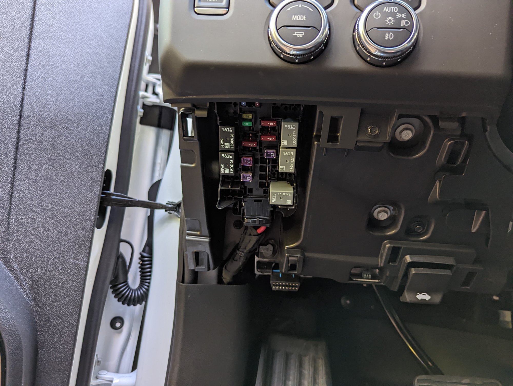

  8. It's a ground signal that goes to bcm.

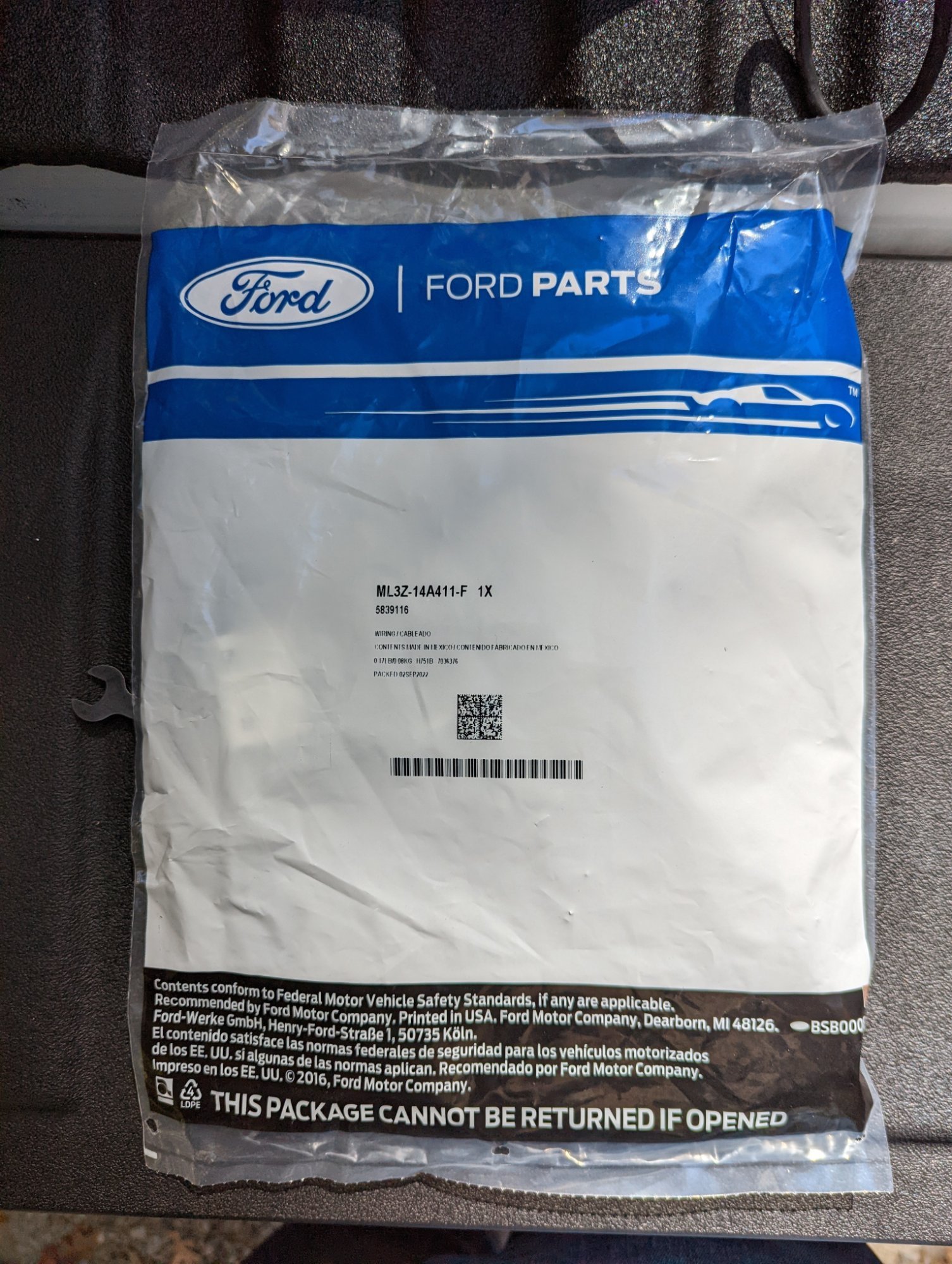

  9. Ford cargo light switch harness. I think it was $34. Didn't get a part# for the switch as it was given to me and I didn't take a picture of the back of it. My friend had ordered it for a 2022 f150 but he had to order for a 2021 as the 22 was too new to be in the system.

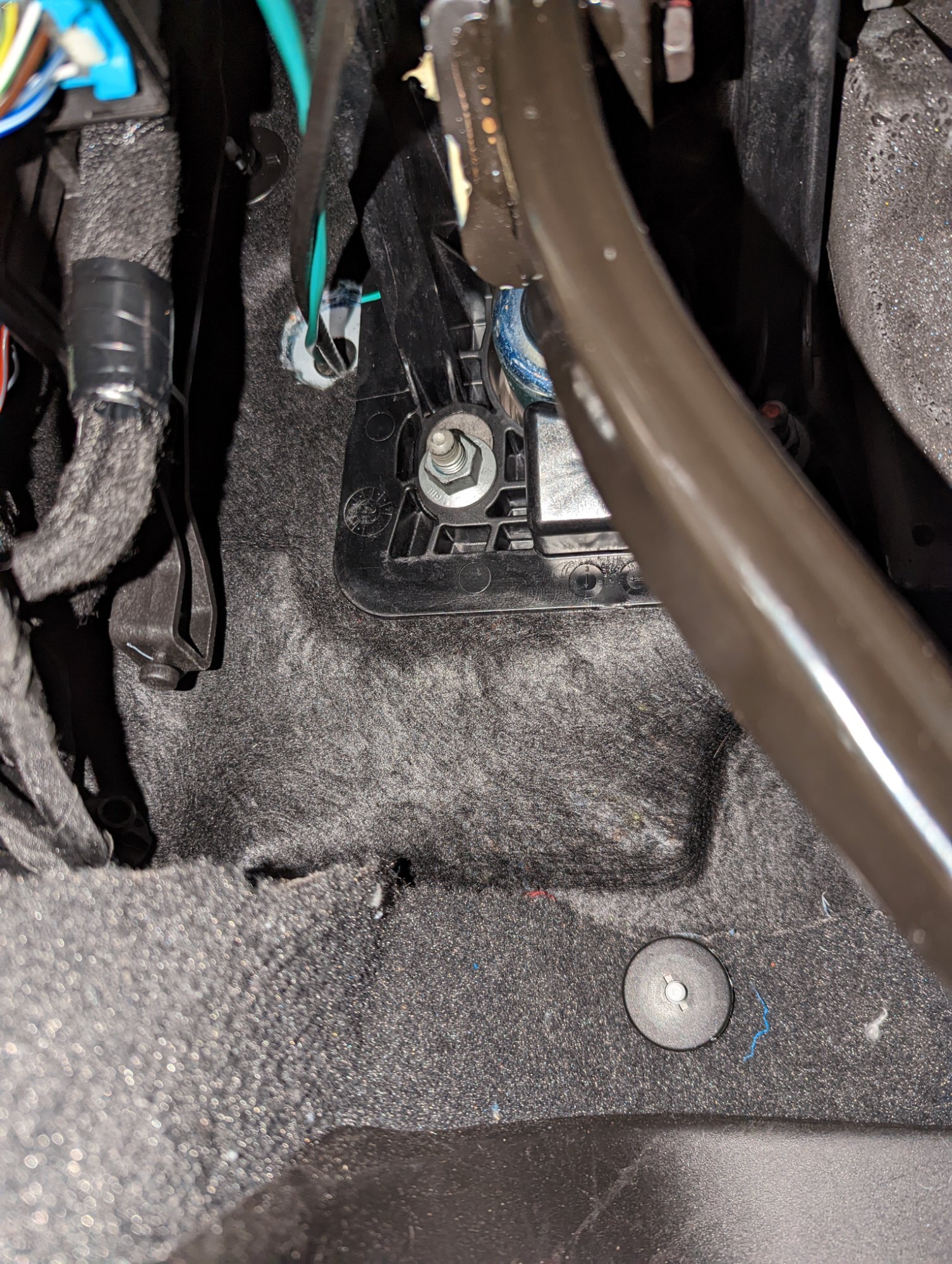

  10. Routed through hood release firewall grommet

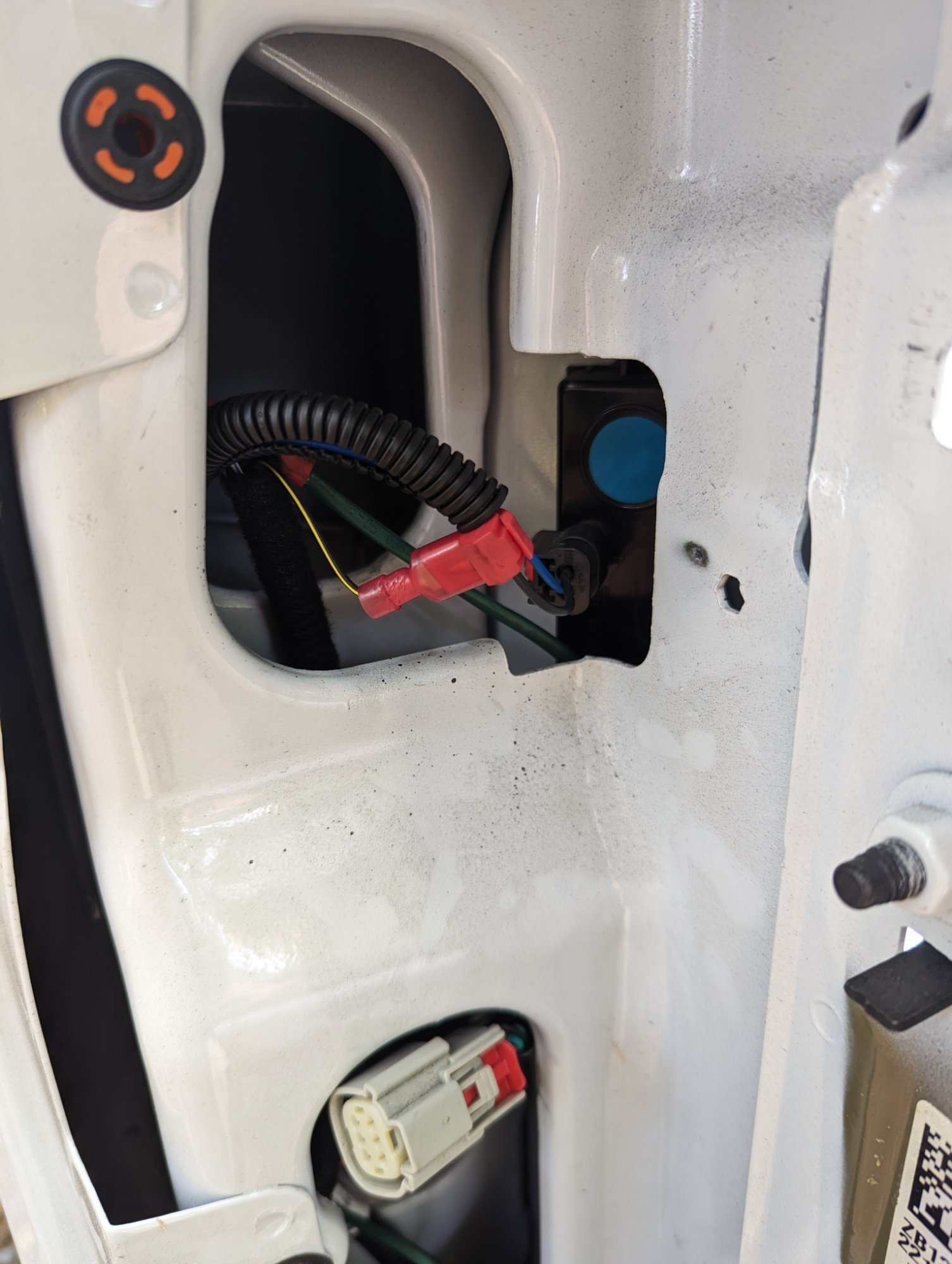

  11. Route a single wire through firewall into engine bay and underneath to tail light. Cab wire to the switch and connect the ground.
  12. Remove connector from back of switch. Make t tap to grey wire coming from truck cargo switch.

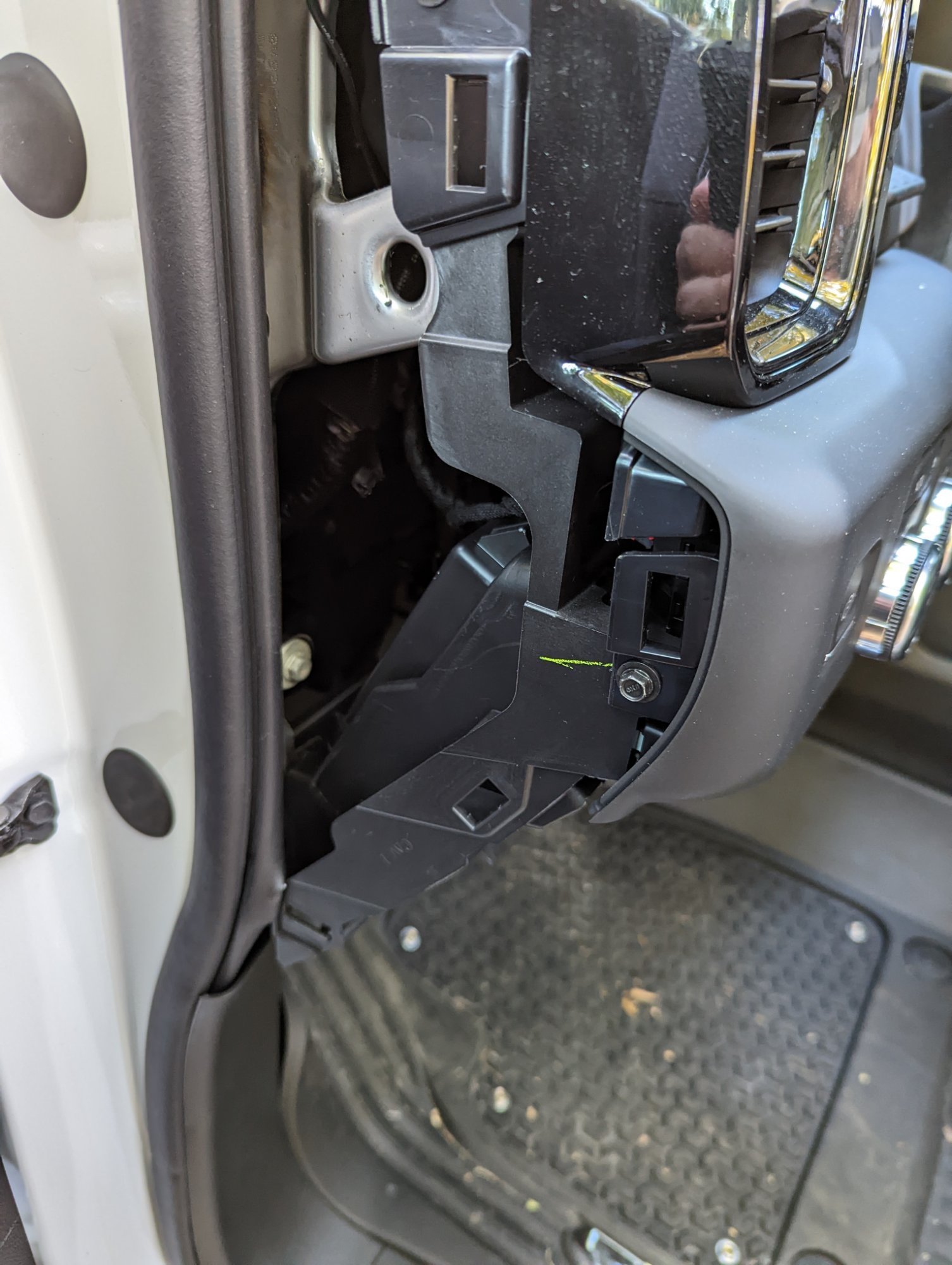

  13. Remove side panel on dash, bottom panel under steering wheel, to access 2 (7mm?) screws that holds the left side switch panel in place. Remove switch panel. All these come off pretty easily.
