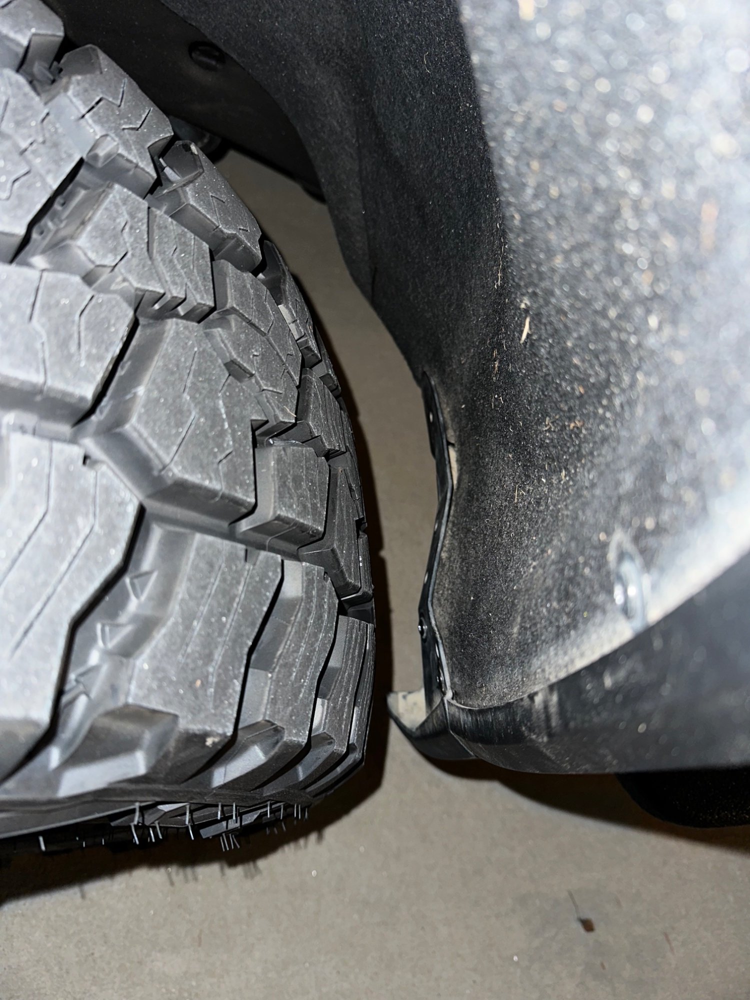

  1. Thanks! So far I really like them, seem to be quieter than the duratracs. The rubbing was only at full lock when stationary but there was a little when compressed and turning at just the right angle. Removing the front rear mudflap bracket and reinstalling the mud flap and bolting it directly to one of the existing lower holes from the bracket was easy and provided the needed clearance. Ordered the mud flap delete kit as well, but mainly for the capped look.

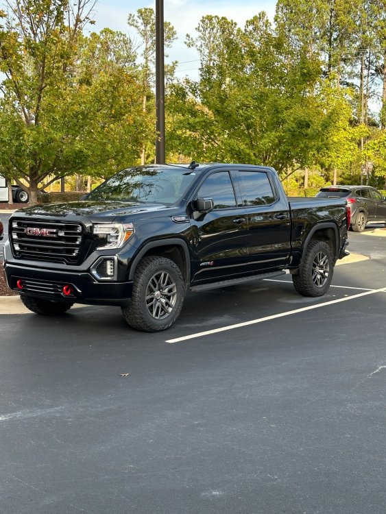

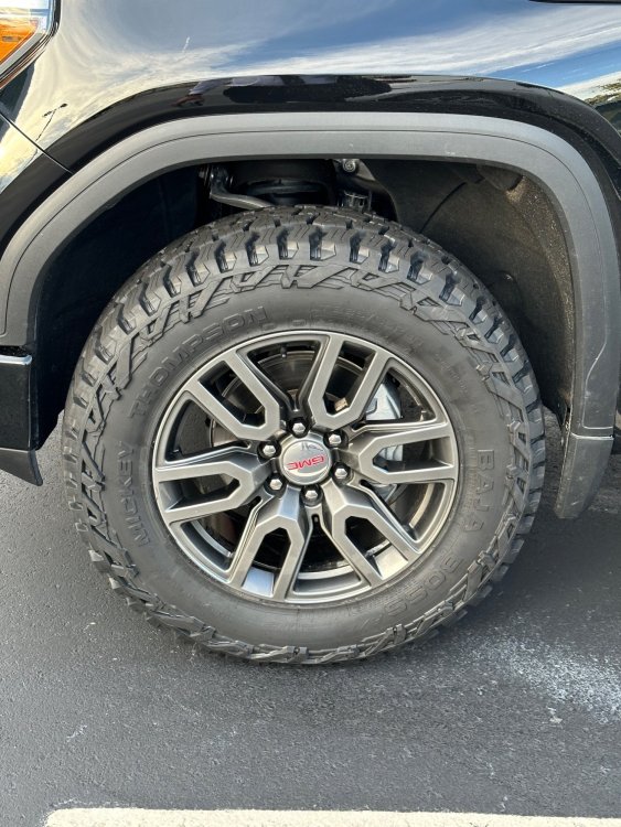

  2. Put the 285/65/20 Mickey Thompson Baja Boss's on today. Had some minor rubbing so ended up doing some very minor trimming in the front and removing the mud flap bracket in the back. Now, no rubbing at all.
  3. That's great news, thank you for confirming. Do you have any pictures? I'd love to see your set up.
