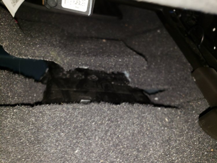

  4. Well I'm at the dealer now, service advisor looked at it says its "obviously" a factory cut so things can be accessed. The only problem he saw was that the tech didn't tuck the carpet back in under the vent. I asked for the service manager, he said pretty much the same thing, but added he could replace it for me but it wouldn't be any different. So we all agreed to disagree. I mentioned that regardless of that issue that it is half ass lazy work. They agreed to that. Once they spent some time tucking in the carpet all nice, it looked acceptable. Had they put it back correctly to begin with, I probably never would've noticed. I won't mention the dealer ships name, but it rhymes with Ed Martin Chevrolet in Anderson Indiana. Quite frankly I don't want them touching it anyway even if they had offered to replace the carpet. Waiting on the brake recall to be completed right now, see how that goes.
  5. I am quite upset that when preparing to clean my truck today what I found was the dealer had cut and chopped up the carpet underneath both front seats when performing the seatbelt pretensioner recall. Leaving them open to any objects or food, trash, split drinks and so on that may be dropped Elecrtonics exposed and a what i assume is a hvac vent that seemingly goes to nowhere. Anyone else experience this with the recall service?
